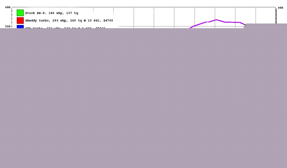

were do you get less than 100 hp?? the rx8 only has 180-190whp stock....
well I'm not going on exact figured but if the turbo kit puts them to like 250-275 hp then thats less then or at 100 hp difference.. and the kit is what 5K or so
293whp is the average seen with dynos
and yes, the kit is about 5k... but a supercharger kit is also 6k, some 8-9k
Edit: here is a chart made by an rx8 owner comparing various dynos
I know somone who said a SC kit was only like 3K and the turbo kit is like 2k more.
