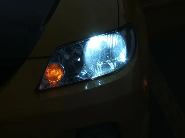

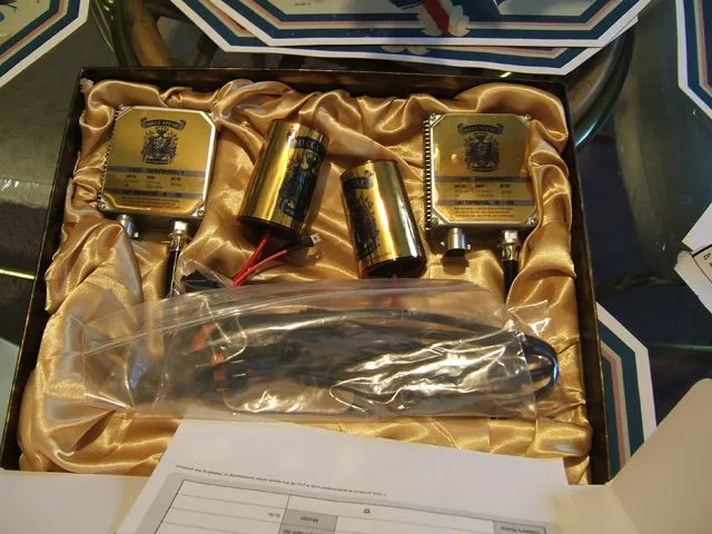

my HID's
sup people these are my hid's
MeccaTune 8300K

aren't your bulbs in upside down???, the liel silver rod on the light on mine is facing up, that how they showed me in the booklet
that's how mine sits. small square part of bulb bracket should be down.
