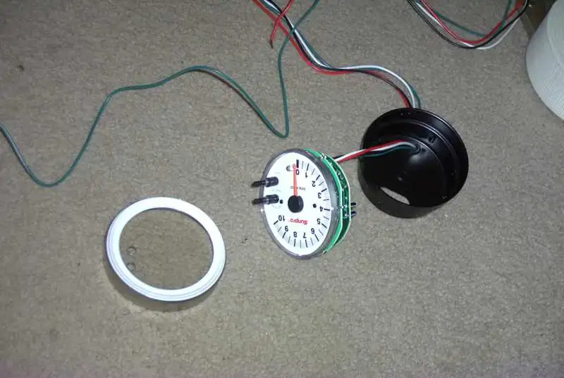

You also need to purchase an aftermarket tach. I picked up a SunPro Powerline 3.5" gauge for doing this. I reocmmend this gauge because it's cheap, it fits perfectly, and both GotZoom and I have gotten this to work nicely.
To get the sunpro apart you just need to pry off the front ring with a butter knife. Then seperate the electronics out by removing the little access panel on the back and then using a butter knife to pry on the air core to push the electronics out. Then you are all set:

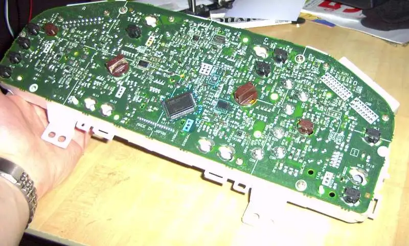

Once you have the gauge cluster out completely you should more or less see this on the front and back:

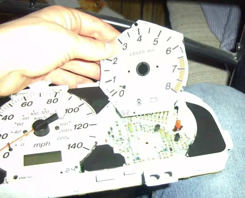

Next you need to go in and take off the needle of the stock tach. Just put a butter knife on either side, twist, and it'll pop off nicely. Once that is done, remove the two little black screw, and then remove the plastic facing. Save that as you'll need it for some things later. Then once that is off you can grab the air core and pull it off as well:

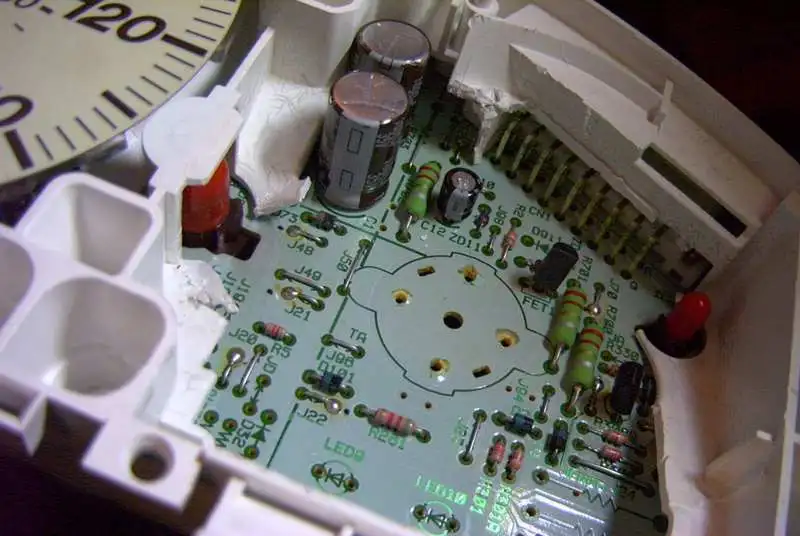

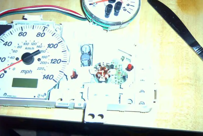

Once you get the motor out you need to go through and make room for where the aftermarket tach is going to sit. So take a utility knife or a dremel tool and start cutting away the plastic. Get it so that it looks pretty much like this:

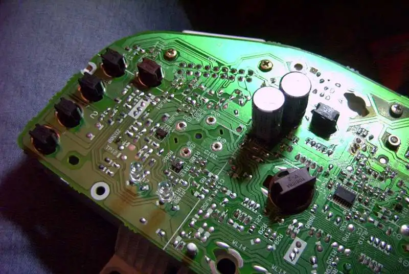

the next critical step is to make more room yet for the aftermarket tach electronics. You need to relocate the capacitors to the rear of the circuit board, and you also need to remove the pins from where the motor was, and I also moved the LED's to the back as well so that they wouldn't light up the gauge funny because of a battery indicator or an open door indicator.
I did this instead of removing these components completely because the traces led to so many places and so many chips that appeared to be shared that I didn't want to risk causing the rest of the cluster to stop functioning or worse yet damage it. There is plenty of space behind the cluster when installed in the vehicle, so this was a quick and easy fix.
You'll see pics of the two big caps moved to the back with the LED's and a pic of the points that I believe are what you must desolder. But please verify those points, as I can't guarantee I identified them right in the picture:

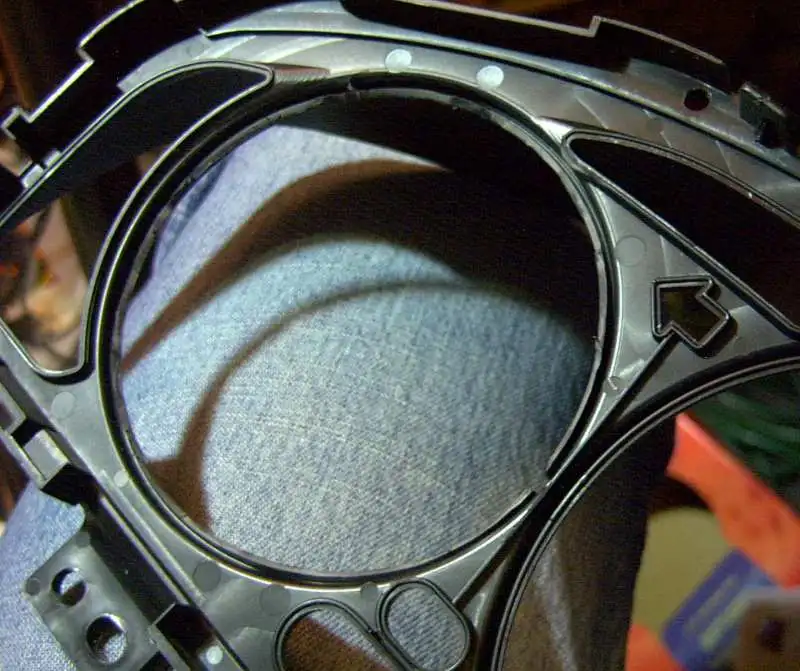

Next you have to modify the black gauge trim to accept the new tach. The new tach actually fits in from the front, and if you trim well will snap in place and not move at all. You can not install it flush underneath the black trim as there simply is not enough space no matter what. Thus it will stick out slightly further, but it is not obtrusive at all as you'll see in some later pictures here.
So here is my trimming job done with a utility knife on the black trim piece:

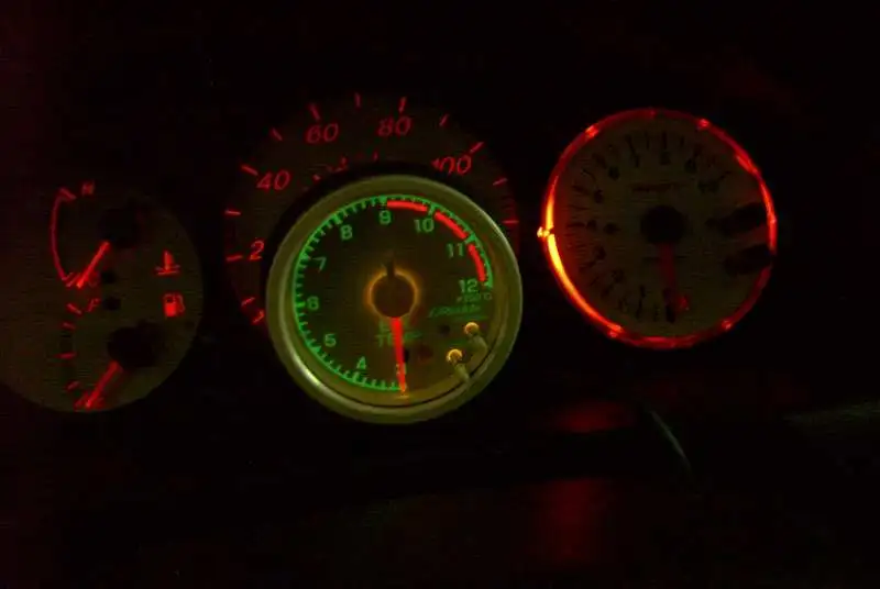

At this point simply snap the sunpro gauge into the trimmed piece, and feed the wires through betwen the white plastic and the circuit board (I made a little "doggy door" for the wires to make it easier).
Then you'll need to trim out sections of the clear plastic from the rear of the circuit board to allow for the LED's and capacitors to stick through.
Also you can drill out the clear plastic to allow for the buttons on the sunpro. Unfortunately for me despite taping the plastic, and trying to drill carefully, the plastic shattered and I'll have to try and get a new one yet at some point here.
BTW, the "night" picture of the gauge is without the gauge using it's own internal illumination. That is backlighting picked up from the stock cluster lights.

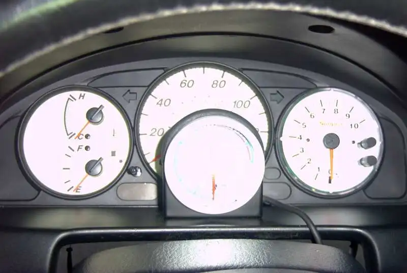

Here are some pics of the finished product:

exactly what do you move from the front to the rear of the gauge cluster? from what it seems like its only the two big capacitors and the two led lights..but there are a lot more soldering points highlighted...

You listed exactly what gets moved to the back... the other soldering points indicated are for removing the air motor assembly. So 3 capacitors (2 big, one small) and the 2 LED's.. the back picture with moved parts is not the "final" condition of hte back..
The gauge face is a bit whiter than the other gauges. Look at GoZoom's "1st Phase of my tach project" thread and you'll see a little better the difference.
okay..another question that i have is i noticed that you can set a rpm/switch point on the tach....how does it let you know when to do that? i didnt see any type of light that it has extra...so does the lights in the back flash or something?
thanks man
actually there is an LED that is at the 0 marker... bright as hell when that thing lights up. But that's where the shift light is. Cleverly hidden as a clear "stop" for the needle down at 0 rpm's.
