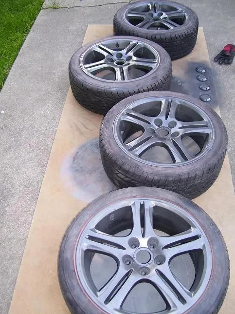

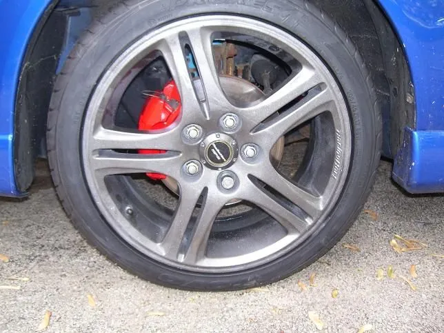

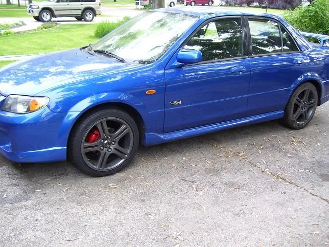

Here are a few shots of the finished deal:
Pic 1: Before
Pic 2: After
Pic 3: Car after
The tires are still kind of dirty due to the bondo sanding, I will eventually clean it up but I want to let the paint completely dry (like for a week). When I got the wheels balanced today the mother fckrslfhasdlfljhad scratched 2 of the rims (bang), even after telling them they were freshly painted. I went kinda crazy on the salesmen, so they only charged me $15 but did all 4. I had to spend an extra hour touching up the scratches.
I love how it came out . I thinks it makes the whole car seem more "intimidating" and the red breaks match the RB swaybars and springs. I think the MP3 wheels are the hardest to paint (from the P5, regular pro, or MSP) because they have many curves, holes and turns. Make sure to take your time on the bondo part, and sand it down good and smooth. I could have probobly done a litter better on the sanding part, but unless you are 5 in. away from the wheel you cant even tell.
One more thing, these wheels collect dust soooooo fast. I had them in the garage overnight and during the day and they already had dust settle on them (you can see my hand prints on the 2nd pic from puttin the wheel on (shrug) ). BTW the wheels are painted gunmetal, not bronze.

amsgator said:
no clear coat huh? it doesnt look like it
actualy, i put 3 layers of clear coat. just like in the directions 2 light and 1 heavy. I put 3 coats primer all around, 3 layers paint inside the wheel, 4 layers outside, followed by 3 layers of clear. it might not show since it is still dusty, but i can get a better pic after i clean them off in about a week (still very worried about soft paint (poke) ).
EDIT:
Here is a better pic of the "shinyness" from the clear coat. Dont mind the different tires, they are all proxes4 now.

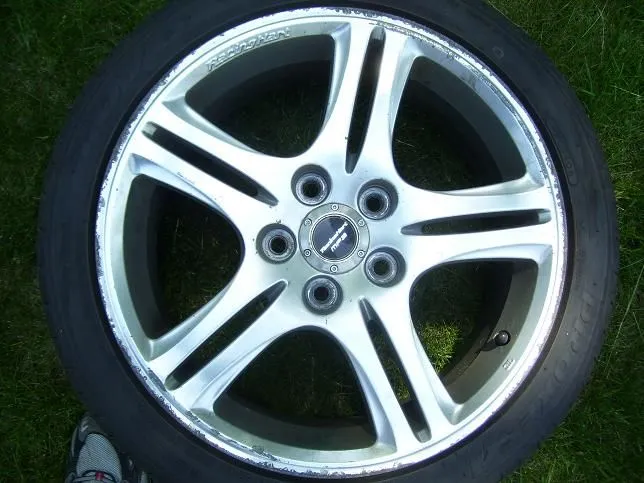

whitemp5seattle said:
question: do you think I could paint these rims? or are they beyond repair?
attachment.php
Definatly can be repainted. That being said it will take a little more than just scuffing the old paint. I would recommend using a drill wire brush with fine brissels (goes alot quiker). Are all four that bad? If so I think you could need about 1.5 to 2 days just to prep all 4. What color you thinking about?
attachment.php
Yah definately, just take some rougher sand paper to the corossion areas then use some bondo spot putty on those same areas and paint. and BAM! Bling Bling!
