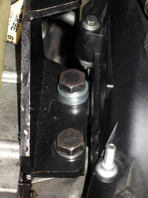

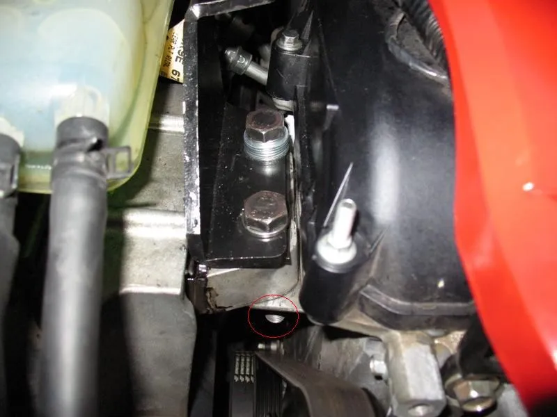

Ive had a problem with the front bracket.
The rear bolt (closest to fire wall) does not screw in all the way (leaves about 1/4-3/8 of an inch of threads left out. I looked in the mount itself and the bottom is not open like the front bolt. Plus the bracket tilts to the side making it scrape against the large bracket that holds the actual engine mount.
Ive had to put steel washers/spacers in the gap in the bolt to make it hold (was making an awfully loud squeek/creek sound)
any inputs as to why my rear bolt is way to long? The threads arent stripped.
only thing i can think of is the bolt being cross threaded in. there is no reason why it should stick out otherwise.
im able to put the stock studs back in without a problem...which is why i figured it wasnt cross threaded
the front bolt sticks out the bottom about 3/4 of an inch...but the rear isnt open at the bottom of the mount like the front.
you can see how its able to come out of the bottom of the mount in this picture...but it cant do that in the rear.
BTW, I don't have a MS3...I have the Atmospheric engine....not sure if this would have an effect on fitment if this bracket was meant for the forced induction engine (even though the block itself is relatively the same)?
EDIT***looks like the mount itself is probably blown (since mazda mounts are soo reliable) so ill look into the cross threaded theory a little more when I get my darkstar passenger motor mount (a bit more reliable and stiff than stock for a reasonable price)

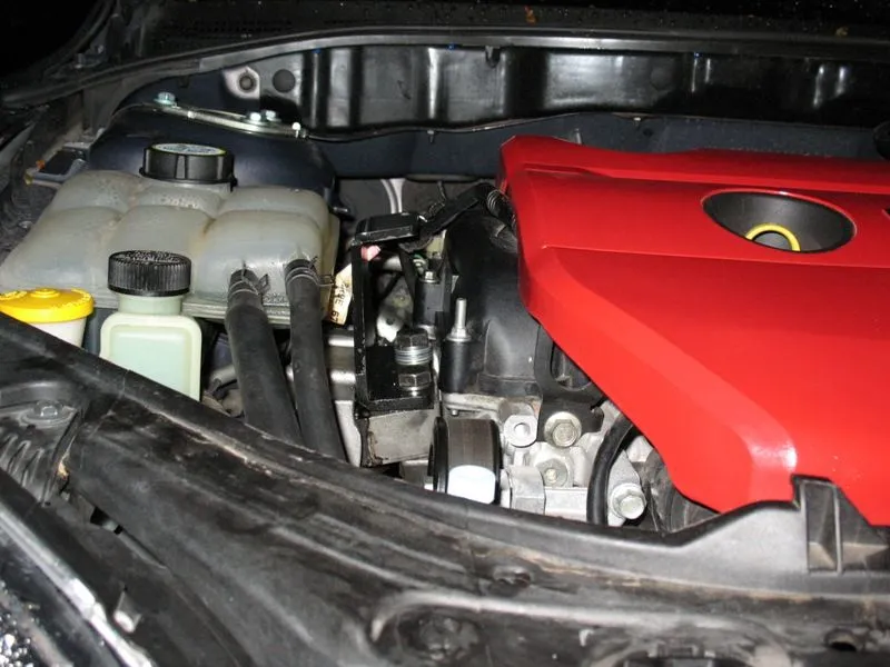

Question, is this damper supposed to be able to twist around? I had it done by my mechanic but after looking at it, it doesn't appear to be dampening anything at all as it seems to rather... flimsy. By twist, i mean that the end links themselves don't seem to be firmly tightening it. Looking at the pictures, I'm not sure if this is supposed to be the case.
EDIT: Okay so I realized that my mechanic ended up putting both sides of the ETD beneath their brackets, as in they're sandwiched between the brackets. It doesn't look right and I'm pretty sure this isn't how it's supposed to be and after looking at the initial photos again, they're DEFINITELY not supposed to be like this. The bolt closer to the firewall should be below while the one away is supposed to be on TOP of bracket. Problem that seems to occur now however is that I'm on TopSpeed PMM and I don't think the angle allows for the ETD to be put on as such. We'll see what happens come Monday sigh! Any suggestions should it seem that my PMM is incompatible then? Besides returning it the PMM to stock that is.
PSS: So, rereading the thread yet again, mine was positioned like jezterr's but just finished reverting to it's original setting. Now the A/C hose is touching for sure, we'll see how everything turns out afterwards good grief. And I realized they were ball bearings... meaning they're supposed to twist I presume?
