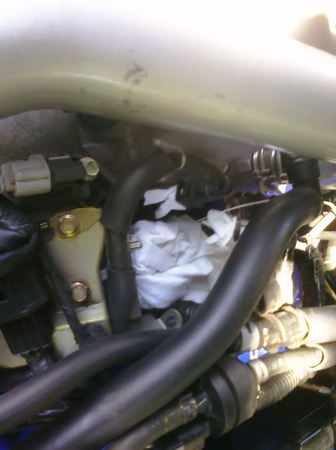

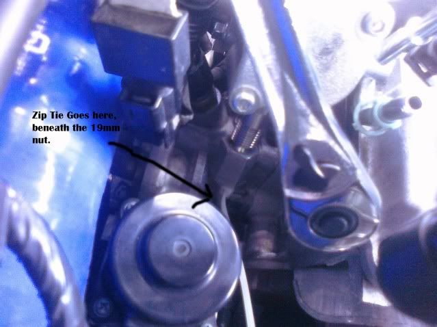

Next, put a tie-wrap below the nut for the low pressure line on the bottom of the pump. This is to keep the nut from sliding down too far. This was actually the most time consuming partm for me, lol. It was hard to get the zip tie on there beneath the bolt. Here's a couple pics of that line. AFTER you get the zip tie on there, VERY SLOWLY unscrew the large 19mm nut just above the zip tie. You will hear pressure release when you first start to unscrew it, and a little gas will trickle down below the bolt. I squeezed a rag in there to avoid a mess, but if you do it slow enough, you can bleed off the pressure, and not get sprayed with any gas at all. The wrench was there out of convenience for my picture taking, which was an after thought... wasn't planning on doing a "how to" lol:

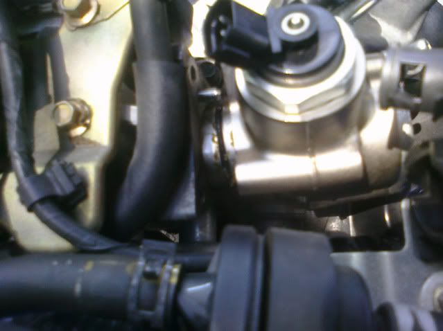

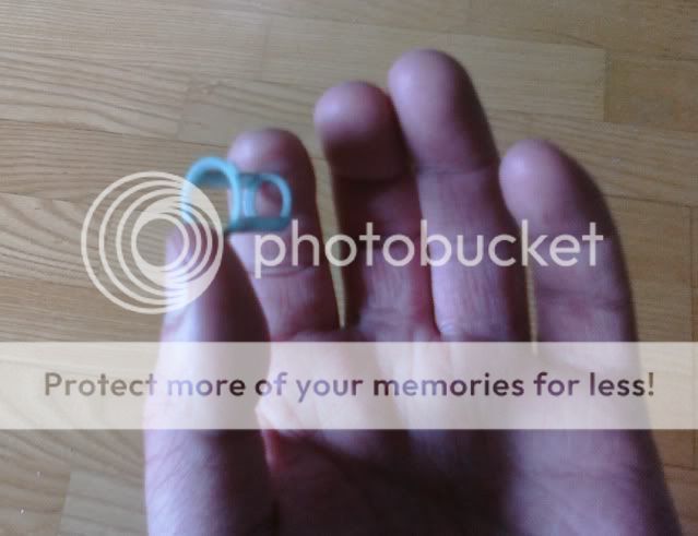

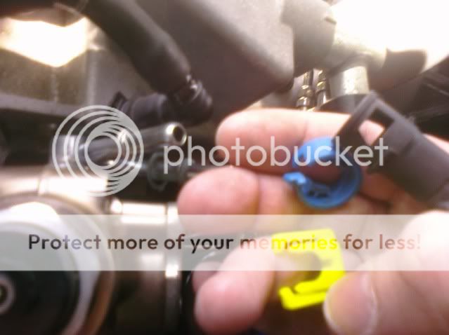

Now, take off the plug from the wire harness that is connected to the HPFP, as well as the two smaller high pressure lines. There is a colored "cap" on each of the high pressure lines. Mine were yellow and blue, but one is square and one is circular at any rate. They easily unclip, and then just slide right off the high pressure lines. Some people had problems with gas squirting out, so use a rag for this. I didn't have this problem, because I slowly unscrewed that bottom 19mm nut earlier: EDIT: Be Careful taking these clips off.. there's a smaller light blue plastic piece that sits inside the blue one (2nd pic below), and I dropped it into my engine bay without realizing it. I fished it out today with a coathanger! lol Here's what Philly B from msf said how to do it as he took those clips off the first time, and almost lost the blue thing too, lol:
yeah, they half unclip. at least they do on the 3...idk how the ms6 works. on my car, you essentially open up the blue part, and just pull up. twist the blue part, opening it slightly, but enough to pull off the line, but keep everything intact
. I'll double check when I put the new pump back on to make sure.

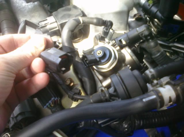

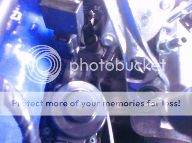

Here's another picture of the two HPFP lines and the factory wire harness plug disconnected. For the wire harness plug, simply squeeze near the base of it on the bottom. You can see how it unplugs, and it's super easy.

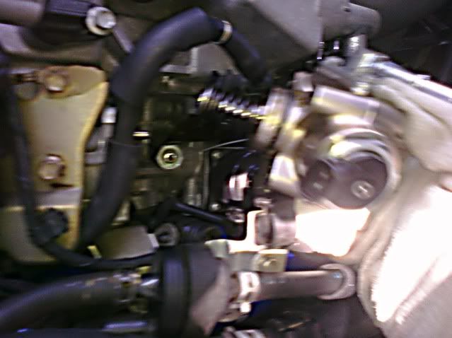

Now, Use the star socket to remove the three (3) long bolts holding the HPFP in. Two are right on the side, and the third one is on the side underneath. They all face the firewall, and you can't miss them. . You can see the one underneath in this pic, as my ratchet is still attached to it, lol. At any rate, they are all easily accessible with a ratchet:
Now that the three bolts are out, just slide the HPFP out towards the fire wall:

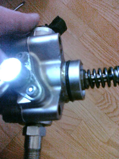

And there you have it:
