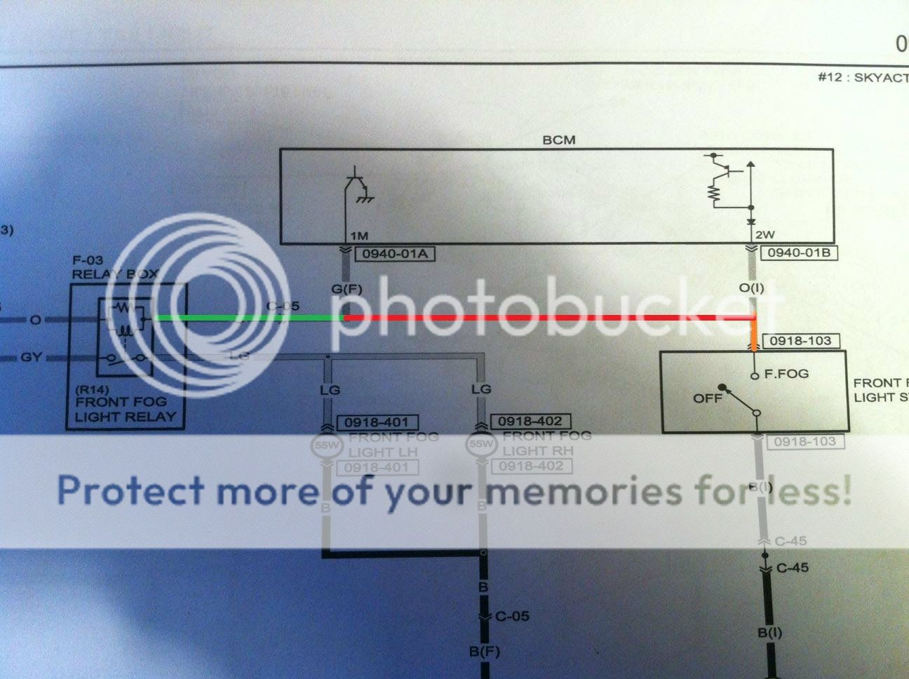

In essence, all you're doing here is bypassing the BCM. You're taking the green wire and splicing it to the orange wire with a jumper (my red wire). Here's the wiring diagram:

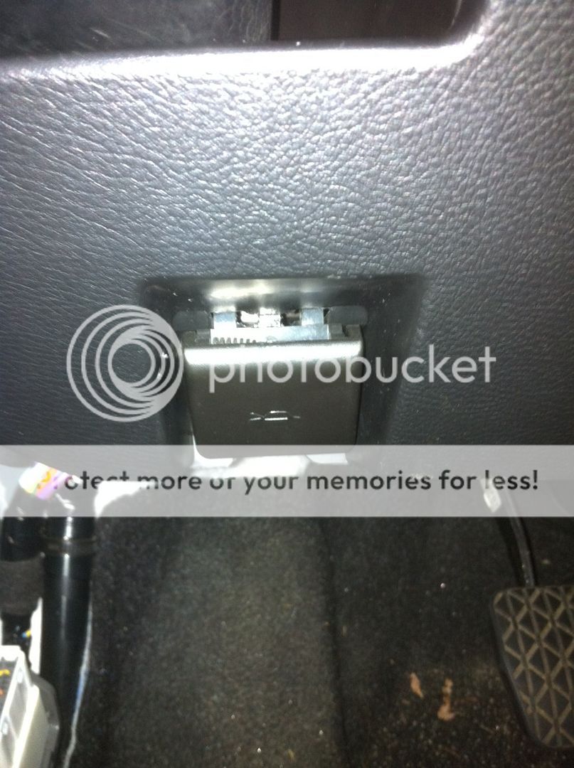

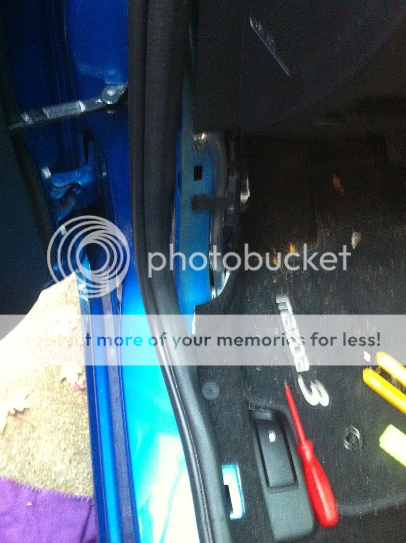

Step 1: Remove driver's side scuff plate and cowl

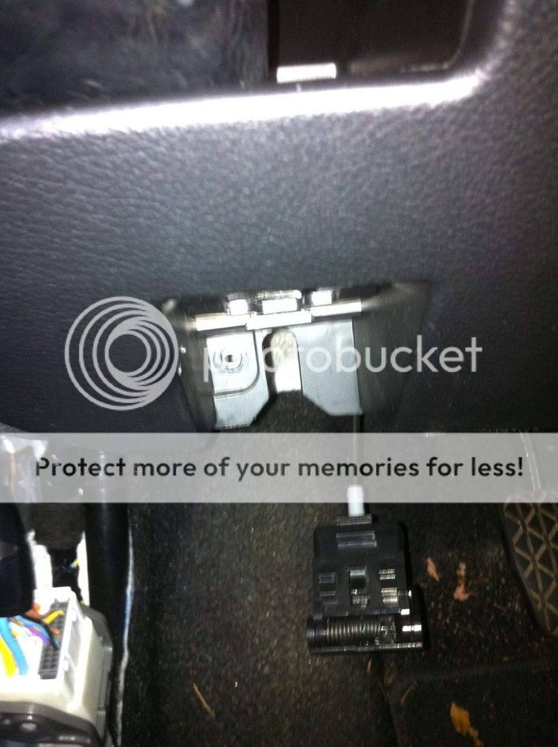

Step 2: Pull out the hood release switch and the screw sitting just behind it

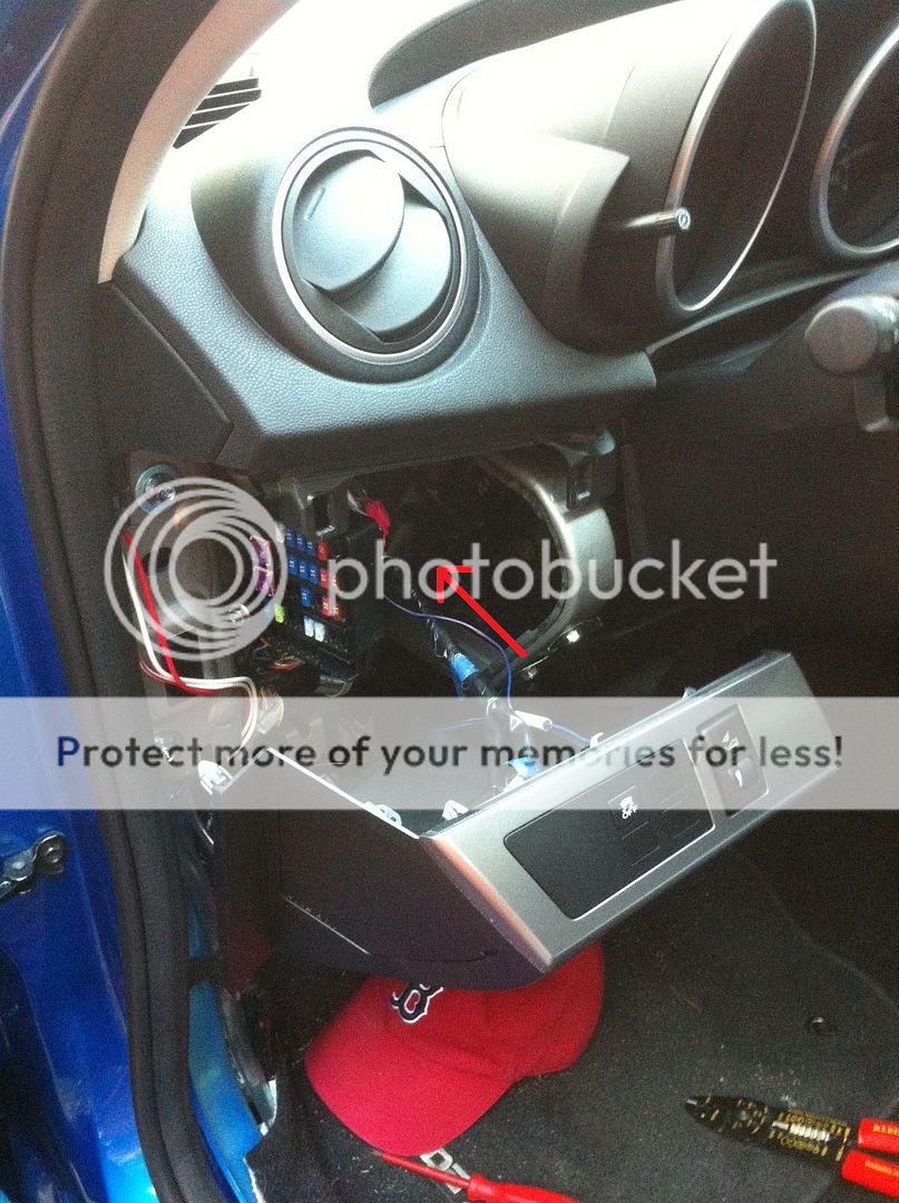

Step 3: Pull the lower trim panel forward and try to place it out of the way--without warping or breaking it. The red arrow in the picture below shows where you'll be working, unfortunately. You can use the 10 mm socket or nut driver to release the fuse block and pull it out of the way if it's a bother.

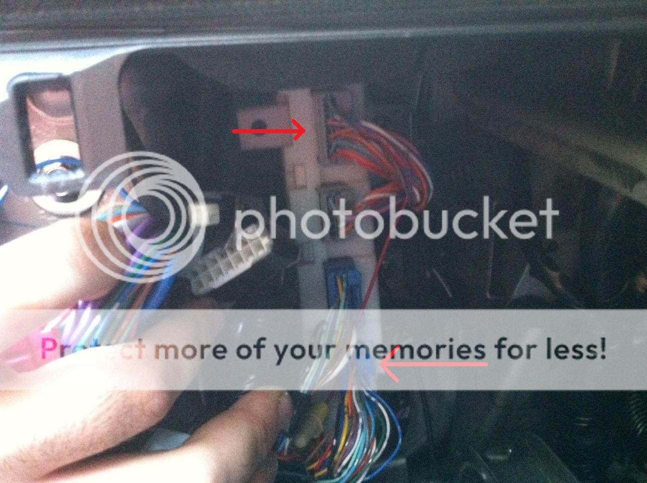

Step 4: Look into the work area, and you'll find the BCM (pictured below). Also in the picture, you'll see two arrows pointing to two different wire harnesses. Carefully pull these two harnesses out of the BCM (by NOT pulling on the wires)

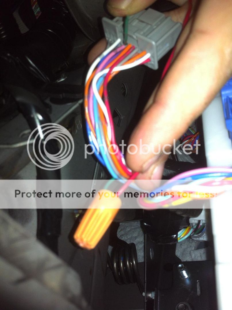

Step 5: On the gray harness (the top one), find the pictured green wire. Cut about 1" to 1 1/2" from the connector. Tape the end of the short wire with electrical tape and strip the end of the now-free longer green wire.

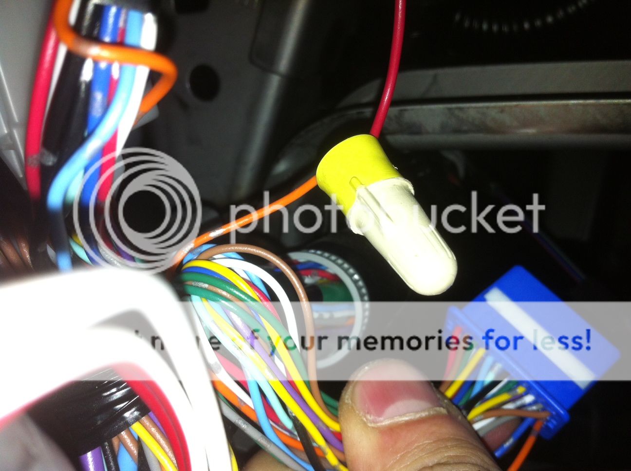

Step 6: Take your 10-12" jumper wire and splice it to the green wire you stripped. I used a wire nut as this was when I was still testing it, but I prefer (and plan to replace with) a butt splice connector.

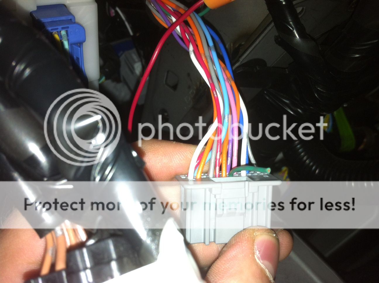

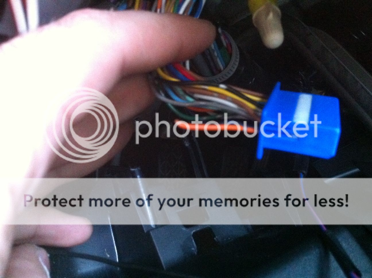

Step 7: Now take your blue wire harness, locate the orange wire on the end (beside the blue wire, below the brown wire--pictures below). Cut about 1" to 1 1/2" from the connector. Tape the short wire with electrical tape, and strip the end of the longer, free orange wire.
Step 8: Take the free end of your jumper wire and splice it with the orange wire you just stripped.
