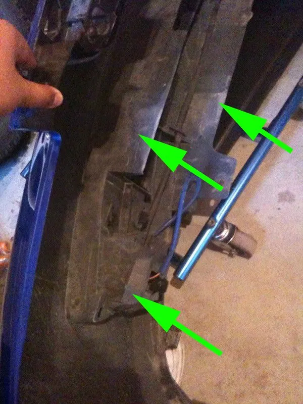

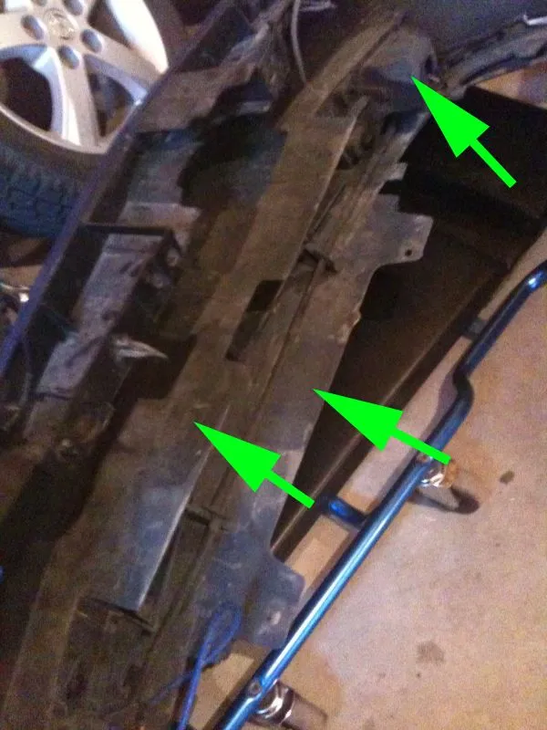

I'm doing a FMIC setup similar to this. I know it was mentioned slightly in previous posts that some people are cutting off the fog light brackets and inner lip to fit the piping/IC. I really want to keep my fog lights, but I was test fitting the bumper and seems as though the middle lips inside the bumper are interfering with the IC. Anyone else had this problem and what did you guys do to fix it?
Also to those who cut the fog light brackets did you guys cut a portion off or remove the whole thing?

my IC does force the bottom of the bumper forward about an inch and a half. I don't have the 3 mounting points under the car for the bumper connected.
03.5 = no fogs for me. but no, I ran the piping underneath the fog bucket on the driver's side, and avoided that area all together on the pass side.

I see in this picture that the frame was cut or bent back? For those who have fogs (ES model) do you think routing this way would clear the fog light bracket?
It's hard to say. I don't have fogs either (03.5) but I did trim the area where the fogs would be. If you got some extra couplers and cut the piping to make it work then I don't see it being a problem. I did not need to avoid the area so I didn't think twice about it. The only way you will know is when you are actually assembling it.
