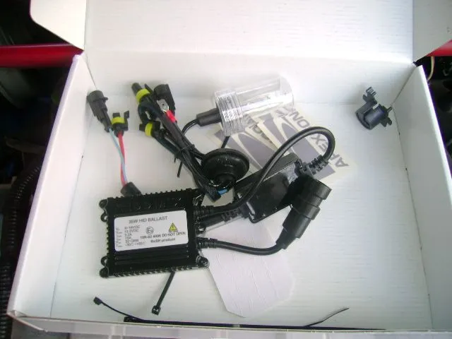

1. Open Box
2. Read Instructions (they are kinda vague)

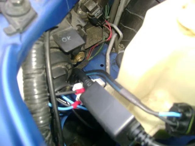

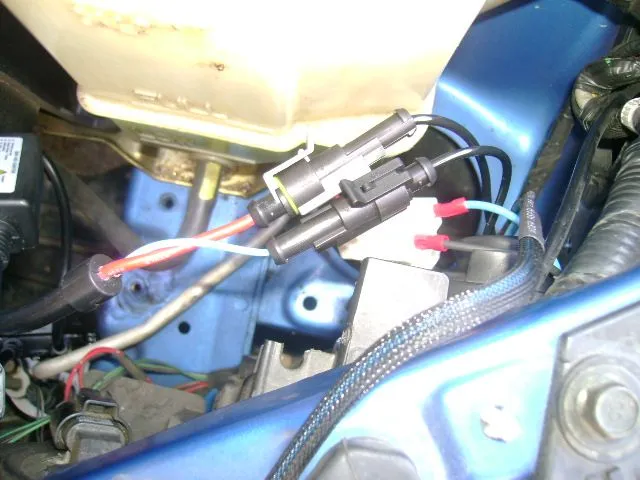

7. Use Continuity Tester and find out which wire is the hot wire. Do this by removing wire harness from factory bulb, turning headlights to ON position, HOT wire will make volts coming out. Or in my case, a light comes on in the continuity tester.
8. Cut slit in dust cover for the BLUE and BLACK wire to come out of.
9. Plug BLUE wire into old bulb harness into HOT side.
10. Plug BLACK wire into other side of harness.
11. Connect all other leads.

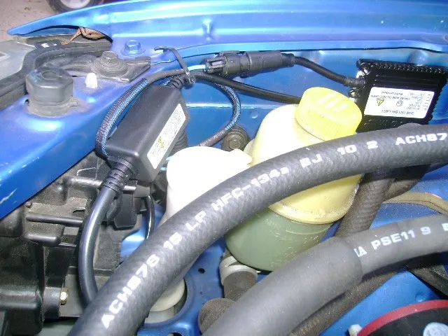

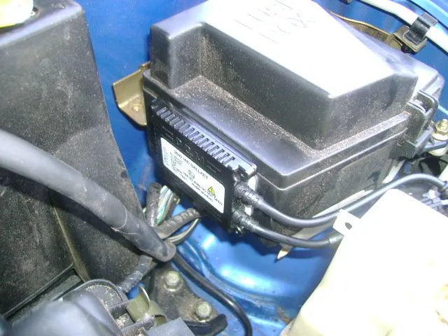

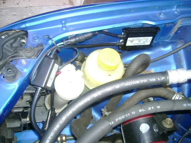

12. Pick a nice location for ballasts.
13. Turn lights on!
More Pics.
More pics

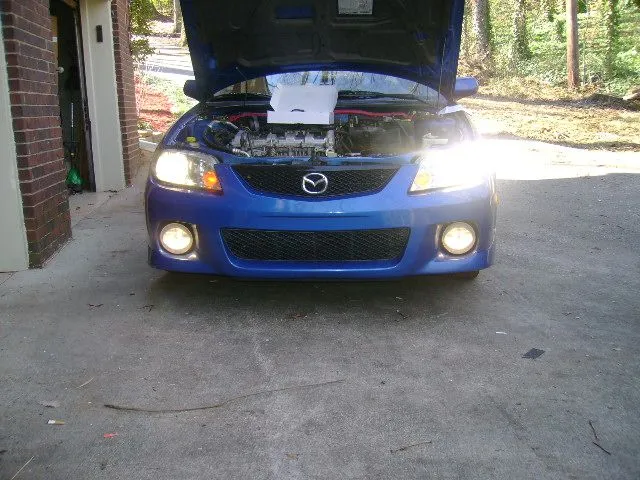

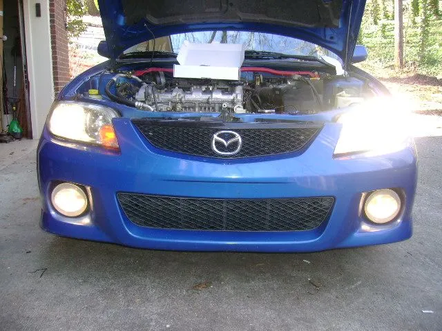

First test with the HID's being on the drivers side, installed. (right Side)
