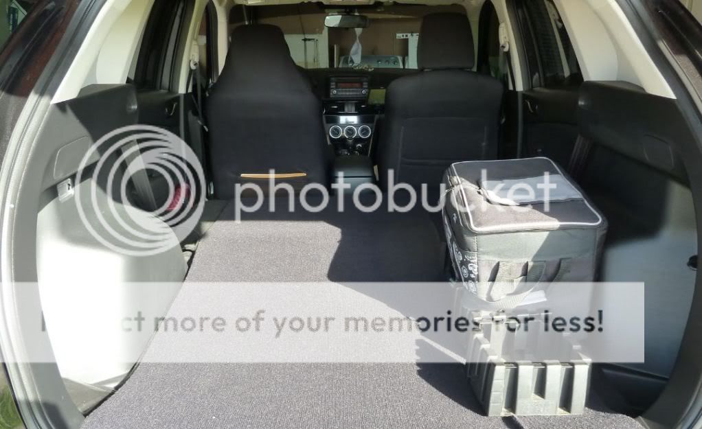

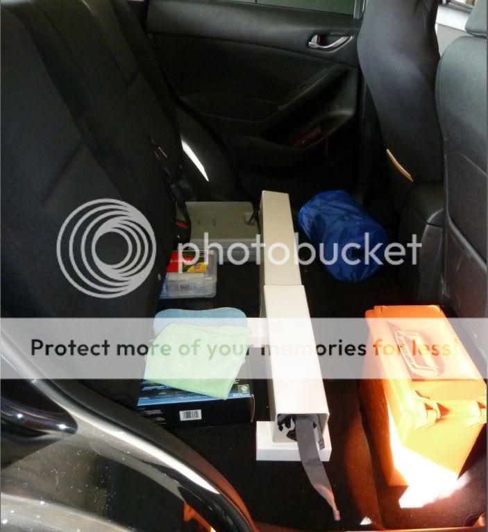

Also own the (Base) Sport Model, and since I didn't need a back seat (just me and wife, now-a-days), I wanted the extra (usable) storage space, by getting the rear seats to lay flat. The rear seat cushion is easy to remove, .... just four bolts. (put the bolts back in place, after removing the seat cushion, so you don't lose them.) After that, you will find that the seats will still not be perfectly flat, as they will fold "too far down". I fixed this by putting two pieces of square PVC fence columns that I had lying around. (see pic), Doing this also provided some extra storage space for various things. (tool box, cleaning materials, etc... ) I put the seat cushion and rear head-rests in some plastic bags, and stored them in the house. (so, when I eventually trade the vehicle in, the rear seat will be in perfect, un-used condition )
One warning.... the carpet that is on the back of the rear seats is pretty flimsy, (thin), so I put some indoor-outdoor carpet over the whole area.... and then purchased the OEM cargo area rubber mat, for the back portion. (that OEM cargo mat is very well built.... thick and substantial )

Thank you VERY much for your time writing how you did this as well as taking the time to upload pictures. Look how much more useable space there is! Great job:-)
