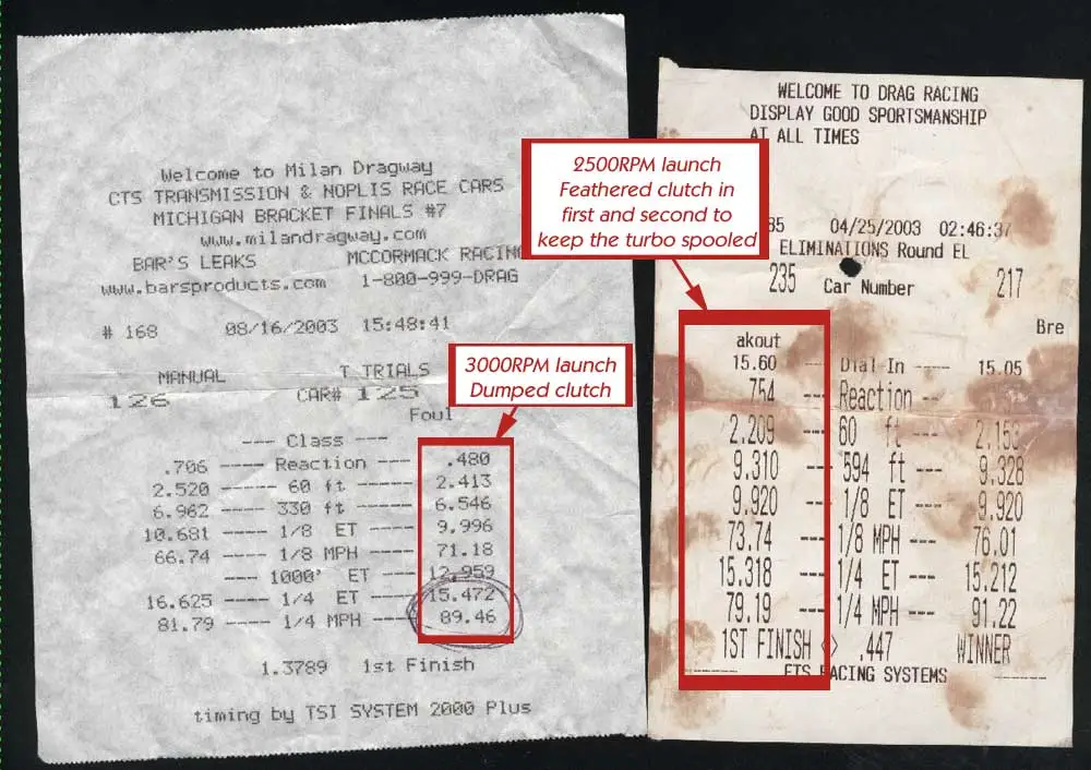

Some examples...
Here are a couple of times at the track with different launches. The car was completely stock both times. I'm not sure about the altitude, but I am in Michigan.
The slip on the left was the most recent. I was getting terrible times all day (16.0 was my best before this run), so I decided to try a drastically different launch. I held the tach at 3K, and blipped it before dumping the clutch off the line. As you might imagine, the front tires were loose for most of first gear. I also popped the clutch in the rest of the gears after running up to about 100 over redline. The weather was 94% humid and hot (mid 80's) all day, but it cooled off for this run (about 76).
The slip on the right was from the spring. This track isn't as nice as the other, but you get more runs in. Also, the other track is an IHRA track, so they keep the rubber cleaned up. This track had a nice thick layer, so I hooked up quite nicley. I held the RPM's at 2500 (I think), and gave it as much clutch as I could without cutting loose. I slipped second slightly, too, so that the turbo would keep the pressure up. It really seems to pull harder that way. Ignore the trap time for this run, though. The speed trap in that lane wasn't working. I even held the gas down until about 80ft. after the finish to make sure that I passed them. The air was dry and about 72 degrees at the most.
As far as launch technique goes, I try to stage as shallow as I can, wait for the thrid yellow, and go. My reactions are usually low 0.6's that way.
I hope this helps someone. I'm not a huge drag racer, but I like to go out there every once in a while. I was really proud of my last run since I beat my buddy with an RSX-S with short-ram intake, N-1 exhast, short-throw shift, and new wider tires. He definitely has the faster car (runs 15.1) but I had the better times that day!
