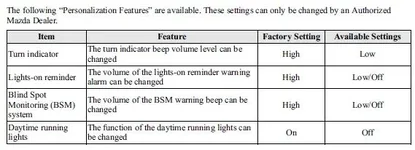

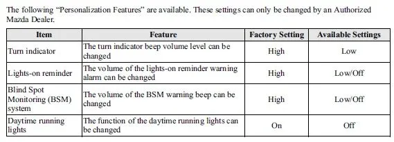

The dealer can apparently change a number of things. See attached (from the manual 9-10):

I had the DRLs deactivated by the dealer. They gave me trouble about doing it but ended up deactivating them in the end. Initially they didn't know how to do it, but got help by calling Mazda North America.
