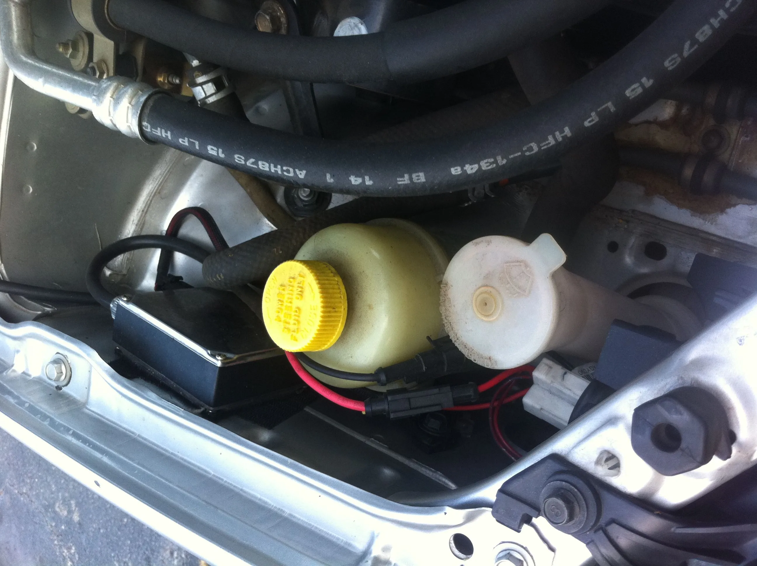

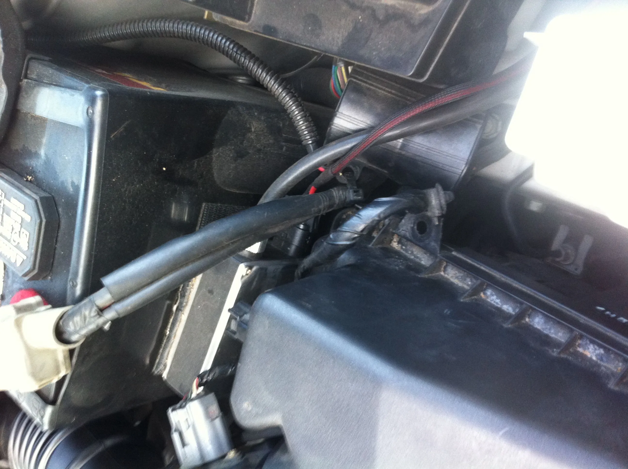

Yah it might be the ballast issue but Im not really sure as what to do and how to ground them. I have attached some images below to show you what it looks like and if there is any way I did something wrong. I have a feeling like its a grounding issue to be honest but not sure what wires I would need and where to hook it up or anything like that, kind of a noob about that ha. I just velcro'd one of the converters to the side of the car and the other is connected to the battery. Thanks for your help guys.

Look for black wires going to the chassis, or double check the manual that came with the HIDs. Sometimes they even have "ground" written on the connection or the wire. It should be grounded to the chassis, if it isn't then it's probably grounded through the headlight harness. Then I'd recommend grounding it to the chassis.
If that seems like its over your head, then its prob a good idea to go to a shop that does HID's and get them to fix it.
How are you running your HIDs? Do you have an after market wire harness? Or are you running the ballasts directly off the factory low beam socket?

I'm running the low beams off the factory sockets. It's been three months since they've been installed and no issues thus far. Here are a couple pics of my ballast location:
