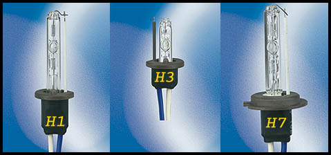

I am really confused. I bought new bulbs since my bulbs burnt out.
The base of the bulb (h7) is so thin. How did you guys mount this with the clip securely holding the bulb down? My old kit has a thick base (about 1/2" thick) and the clip holds the bulb in, but with this bulb, the clip doesnt even touch it.
HELP!
Look at this image:
http://www.mazdas247.com/forum/attac...hmentid=130234
The base of the bulbs are so much thicker (my kit, not my picture).

I stacked a bunch of washers together untill the bulb was held snugly in place. Sounds a little silly but works great.
the stock bulb has a spacer on it, so you have to either figure something out to space between the new bulb and the clip, or bend the wire clip to hold the bulb.
Did your previous HID kit include a black "cap" or spacer? Both my kits had a little black plastic cup that i had to put on the base of the bulbs and then clip into place.
Also, i COULD NOT get the clip to clip over the "cup" with the headlights in the car. I had to remove all 4 to get the bulbs in

cause i just put the space on the bulb and the clip thing went RIGHT over the spacer fine and my bulbs are in place perfectly
no shaving no nothing

heres sum pictures of how i had mine set up
the bulb is held in by the spacer thing which is then held in by the clip
then i have a hole in the water sealent so that teh bare metal wires goes from outside into the hole that i just made to connect to the plug from the inside so water cant get thru the wires
