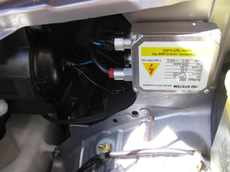

I installed my HID ballasts in the open box section that is directly behind each headlight, a perfect fit! I'll post a pic when I can.

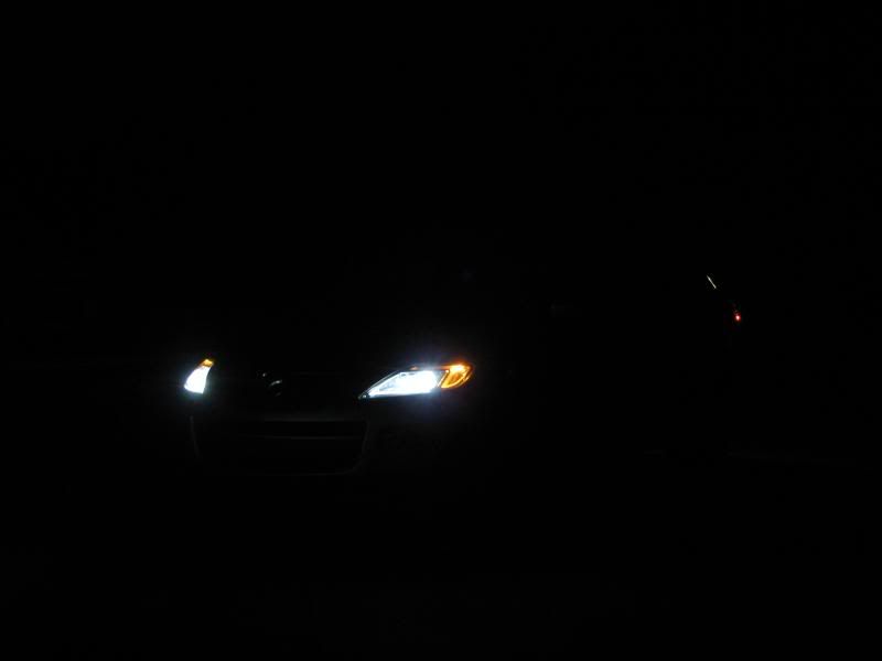

I'll post a photo tonight, I went for 6000K, it seems to be a white/bluish light rather than purple. Great vision at night. The first time my wife came for a drive at night she asked me if I had my high beam lights on!

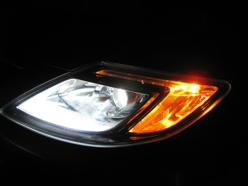

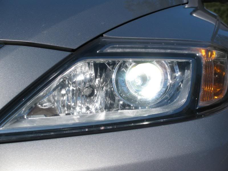

I just finished mine today
DDM - 5000K (35w)
you have to remove 3 screws from the rad fluid tank on the pass side to get to the low beam headlight assembly
mounted the ballast between the cooler tank and wall

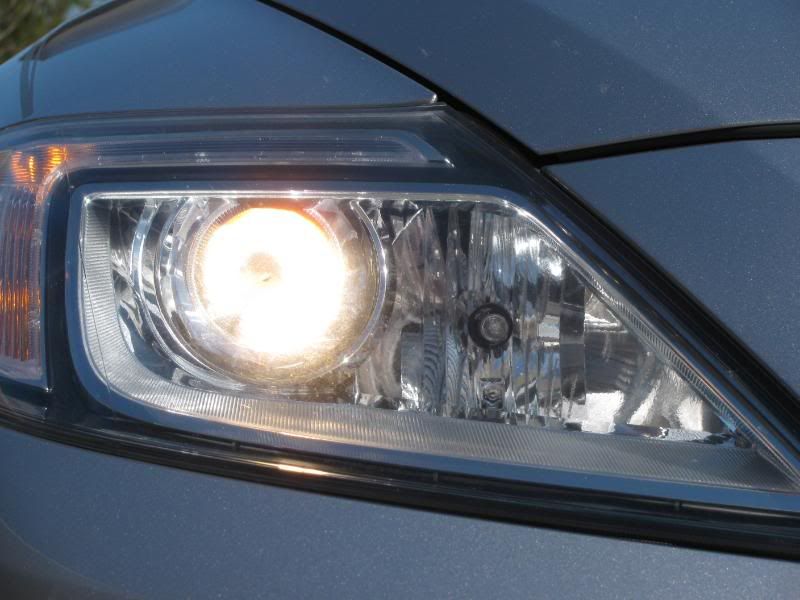

factory halogen in pass.....hid in drivers
Thanks. I went ahead and drill a hole last night :) Inside the hood seems different in the 2010 modle where there's no flat surface I can mount the ballast as shown, so I pick some spot really deep down which I had trouble reaching....

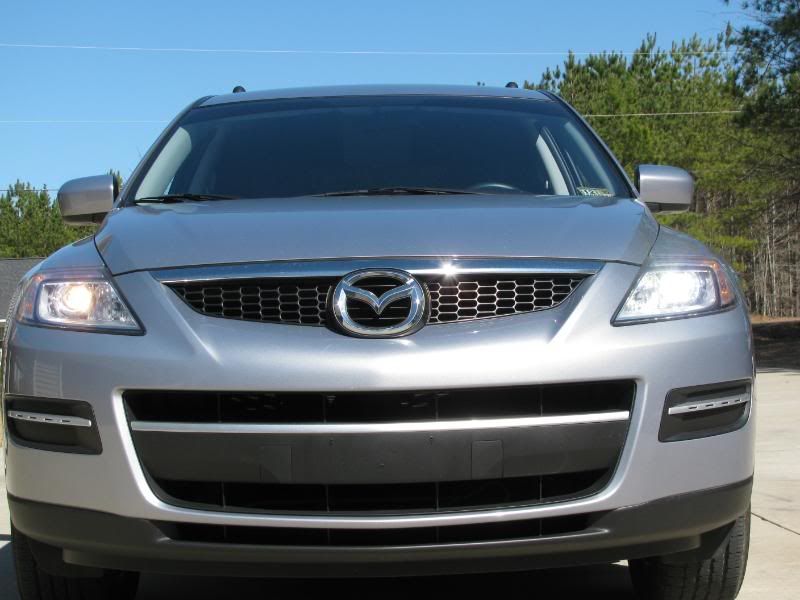

Installed 4300k and looks just like my E90 :)
