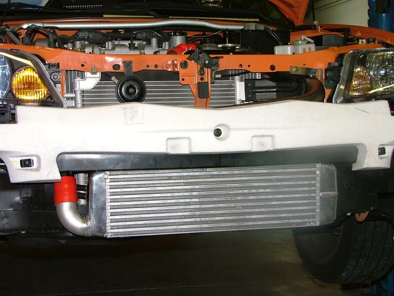

Here are the preliminary pictures. He had been working on it that day, doing some fitting and routing, so bear in mind that when these were taken, it wasn't the finished product at all:

interesting route for the IC piping....
oes the length affect efficiency of the IC?
Looking at the length of this application here, it shouldn't make much of a difference at all. Just think about all those mid-engine'd MR2's running around with front mount intercoolers, when the engine is at the back of the car.
They routed the piping that way to get it away from the manifold. They found that it made a substantial diff to route it the coolest way through the engine. As for the pull it is noticable. The car gained one pound of boost as well, so that may be it as well. It definately spools alot better though.
