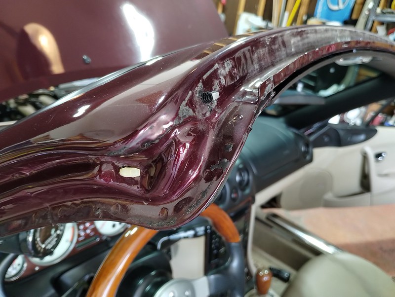

Pull up the scuff plate on the door opening to remove the front part of the strip. Once you remove the strip, you will have some adhesive to remove before proceeding. The new strip has adhesive inside the slit that fits over the seams so you don’t have to add any. Here is a view of a seam once the strip is removed:

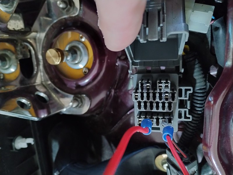

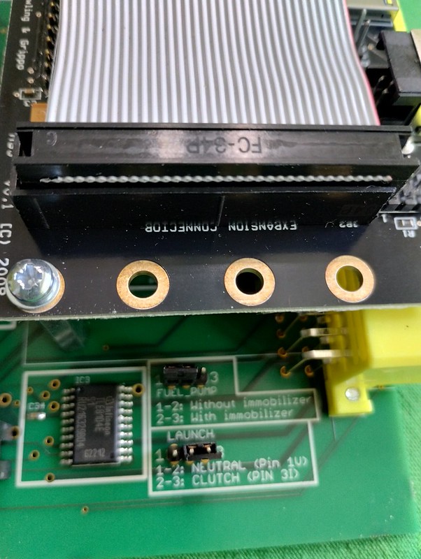

I got in touch with the builder of my MS3 to seek his help with my non-start issue. After five days or so of back-and-forth e-mails (time differences suck for that), we established that my fuel pump wasn’t operating. To check the pump itself was fine, I made a wire to jump out the F/P and GND terminals in the diagnostic box located under the hood. Here is the wire (cut down two fork terminals), and the places you need to jump across:
Pump ran fine with that in place, and the car started. This is when I found out that NB2 cars (with the immobilizer circuitry) have a different hardware configuration inside the MS3. There is a jumper that is placed across two posts depending upon the year of your car. Mine was installed incorrectly for my year. Here is how it should have been (this is after I moved it):
Once that was done and everything connected back up, she fired up with some minor stumbling until the air was out of the fuel system. I got everything calibrated I needed to and set the base timing. I will need to figure out some sort of mounting arrangement as the Singular bracket I bought isn’t going to work for me. Now on to some tuning!

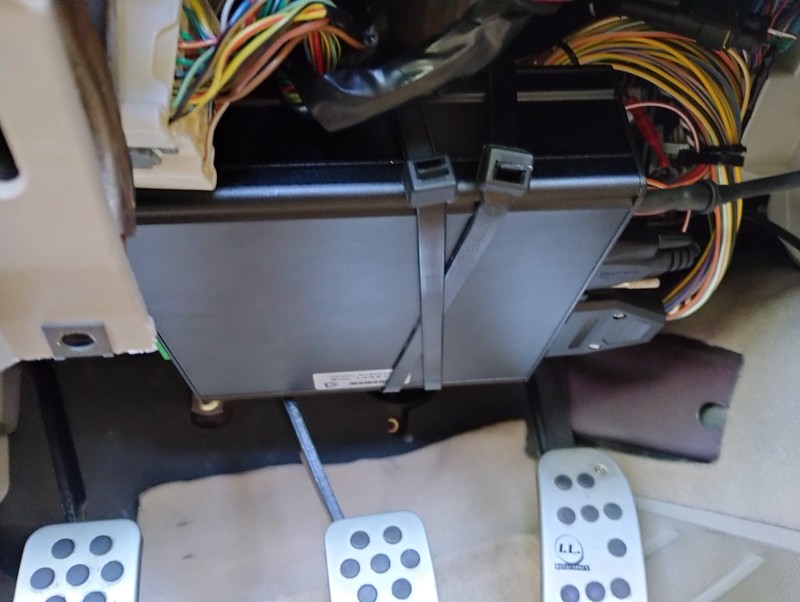

Ended up using some zip-ties to mount the MS3 to the underside of the steering column. I used what I had on hand, this morning while out for a test drive I stopped by Ace and got some long, wide zip-ties. I’m going to redo the mounting also using some 1/16” foam I have to provide some cushioning for the ECU.

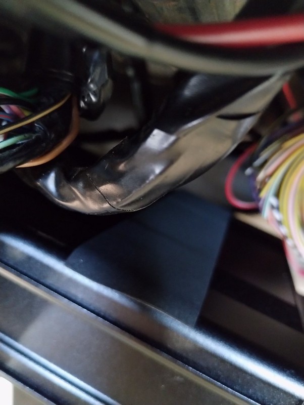

Here’s some pictures of what I did with the foam and mounting for the MS3:
Haven’t noticed any problems with it yet.
