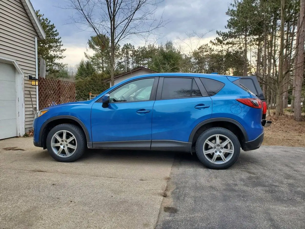

Hey everyone, thanks in advance. I've got a 2014 CX-5 Touring AWD and I just replaced my pads and rotors this past weekend. I've done this before and I'm pretty confident in my ability (though I'm not perfect!) At the same time I also replaced my stock 17's with some 18x8 Mitsu Eclipse wheels that have the same numbers (5x114.3, ET46, 67.1 CB). The issue I'm now having is there is a clunking noise when hitting small bumps and frost heaves (Pure Michigan). My initial thought is that the rims are still "floating" even though the bolts are tight.
Any thoughts? Do I need more "lug centric" lug nuts? I used the OEM Mazda ones.
Pic for reference.

You should be using hub centric wheels or rings. But I’m not convinced that is the cause of the noise, if so you should be getting a bad vibration too. More likely the new wheels/tires are hitting something in the vehicle - what kind of noise do you get when going over big bumps?
Not knowing how you changed the brakes, something there could be rattling (pins, rattle clips) but probably not.
If you left off the pad clips, they will rattle in the caliper. If your tires are striking the strut springs or spring mounts, you can duplicate that by opening the driver and passenger doors and use them to leverage to front end up and down, while someone listens.
