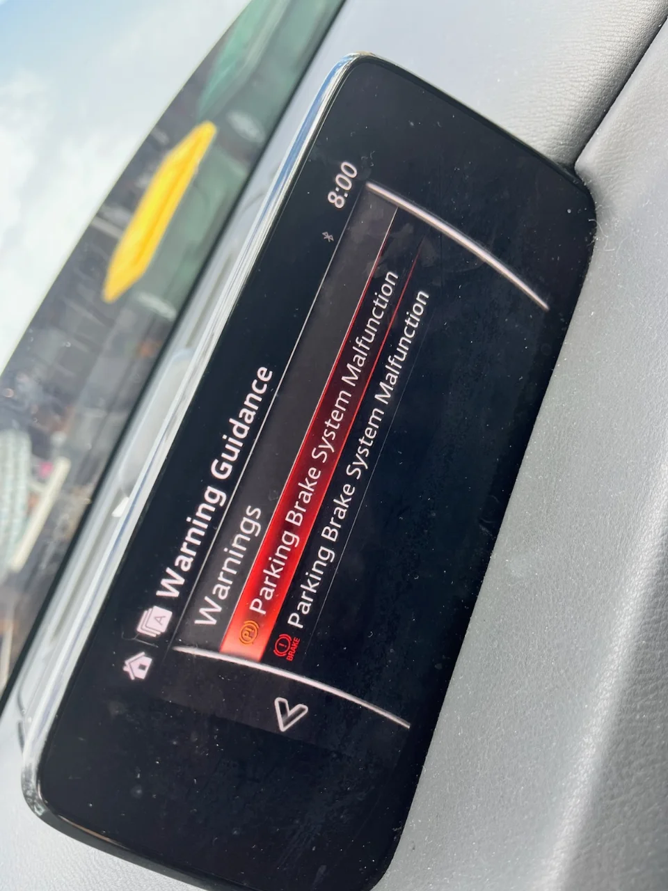

I am having a brake issue for the longest time now. Does not affect driving conditions etc just the dash. I did brakes 2-3 years back in the rear and we did not set it into service mode until it was too late. Due to this, the EPB light flashes and it shows it is still in service mode on the dash. The rear passenger side motor and all works assuming so since I put the emergency brake on and you can feel that side is the only side that works. Driver side is the side I messed up I believe. Since then, I have replaced the electronic parking brake actuator, module and just yesterday the caliper. Still no luck. Tried taking it out of service mode and does nothing. Anyone have any ideas? This is what the infotainment shows.
