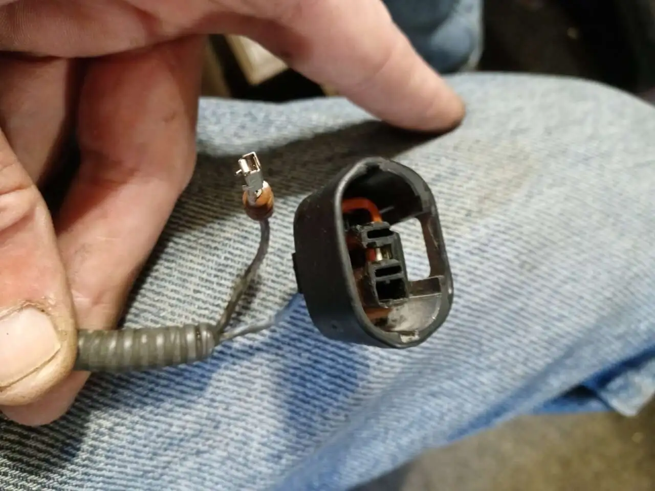

I'm having a similar issue. The voltage is controlled by the PCM. 2 wires coming from alternator connector (blue and grey) one is signal and other is command. My connector is broken inside (black plastic around pin crumbles). My 2 wires are showing connection between alternator end and pin on fuse box connector (which are not the same color so I'm lost now).

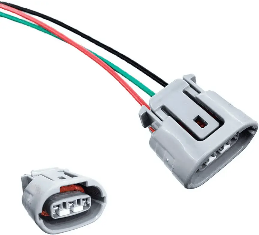

P/N S2533 (3 wire connector) first pic.
The one I got all wires are black comes with 3 crimp style connectors for slicing.
Match to old (2 wire connector) second pic.
I put a small wire nut on the used one and taped it up.
They provide a good length of wire on pigtail, but no need to cut old one off very long.
