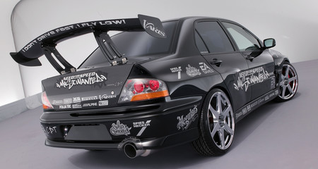

They look sweet on that Z but on FWD/AWD offset (like the front wheels on the Z) that cool look is mostly lost.. the wheel still looks really cool though, they look awesome on the Mazda5 :)
the wheels will lose that look for sure, in my opinion look for something that looks good with a high offset, nothing with a lip.

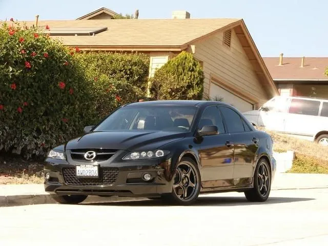

Now, I'm pretty sure the guy in the photo below has 18x7.5 +43 5zigen wheels with 225/40R18 tires. I sent him a PM over at Mazda 6 club to verify it. He's got the AutoEXE springs. If I can get that stance with the 5zigen Gravis 1 rims...I'll be a happy camper :)

and... a little photochop. 1.5" drop and 18" 5zigens

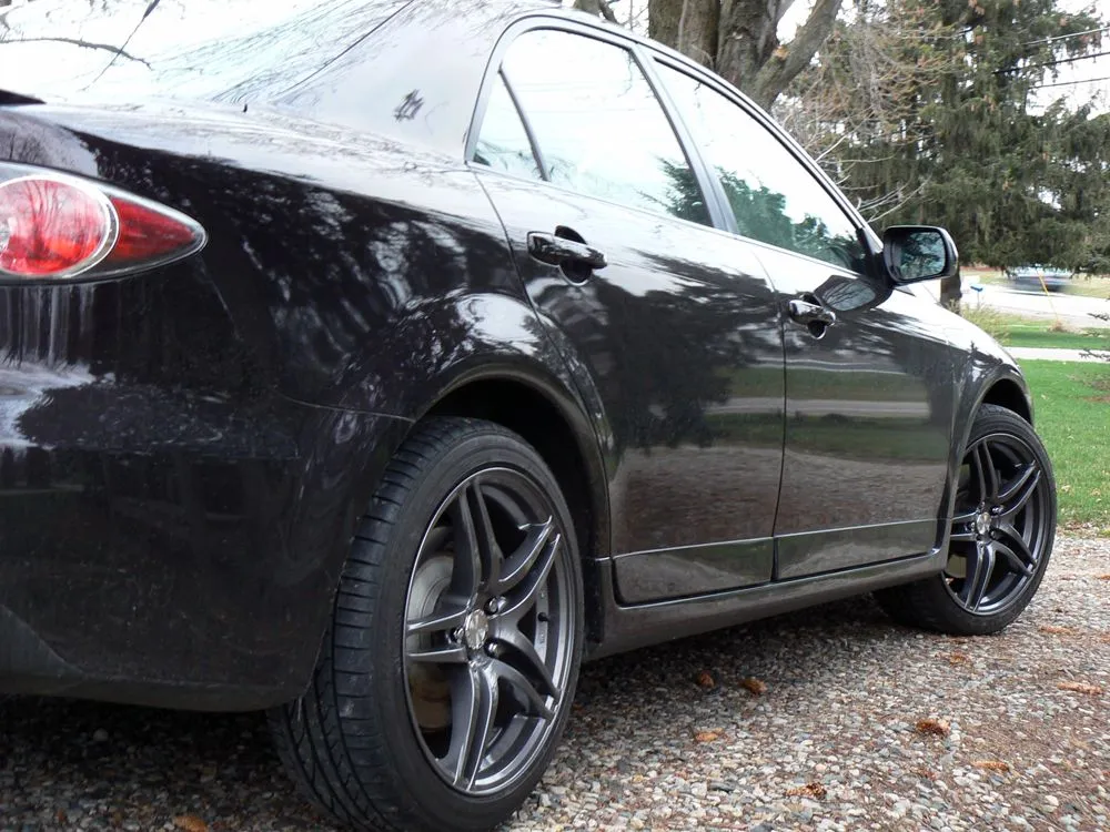

Rogue has the Ennio wheels (with custom mazda center caps so they look more stealthy) on his classic red P5.. it's not velocity red but it's close :P
I'll see if I can find some pics
edit:
I know you said you weren't looking for a dark colored wheel but here they are:

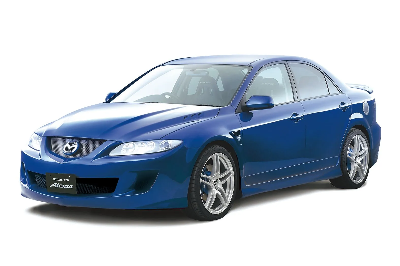

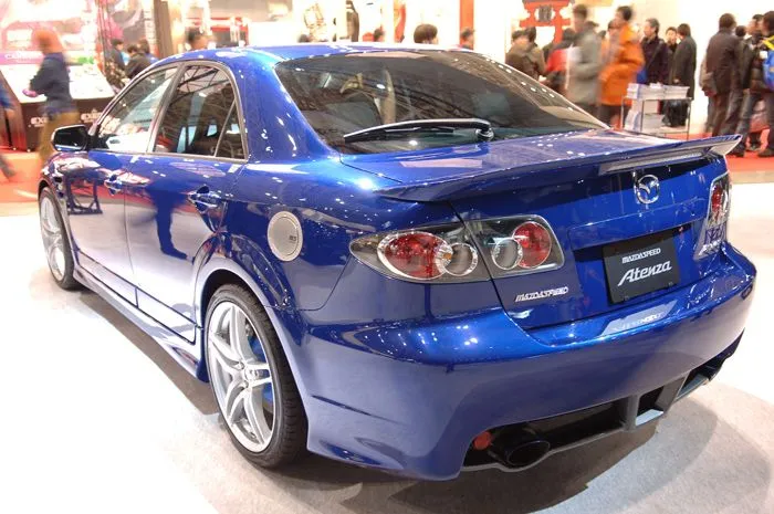

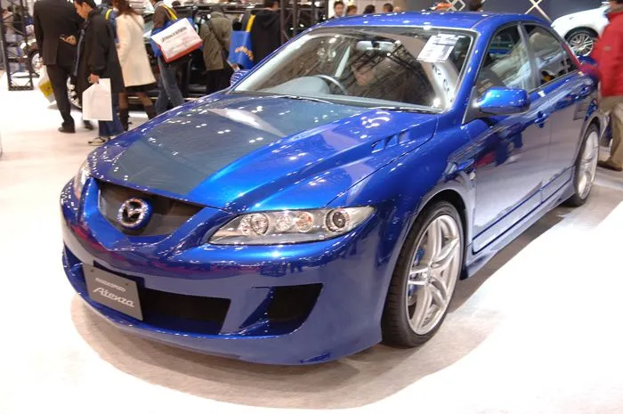

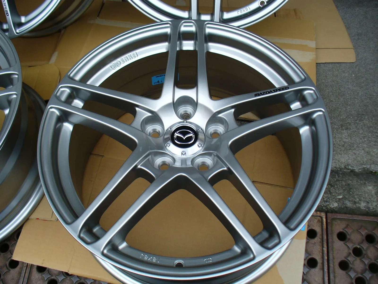

They look very close to these Mazdaspeed wheels... (which are about $2000 shipped from Japan) ...but the spokes aren't as thick.

Actually, comparing the Ennio and Mazdaspeed wheels side by side, they are virtually identical. However, I'm not sure what the finish is like on the Ennios. Rogue's wheels above are the gunmetal version I'm guessing. I would like to see silver and hyper light on a car before making a decision about them.
18x8+45 gunmetal ennio on 215/45/18 (stock tire size)
