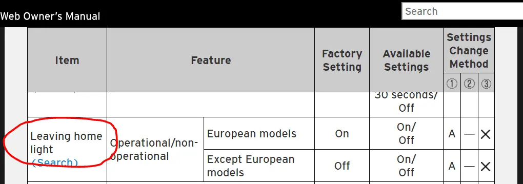

According to the Owners Manuals, it looks like the 2014 didn't come with that feature, though it does appear on other model years for the CX-5.
On my 2016.5 CX-5, for example, the Owners Manual does have entries for the various headlight control functions, in section 9-10 Personalization Features:
2016.5 CX-5 Owners Manual:
  • Auto Headlight Off -- The time required for headlights to turn off after ignition is switched off can be changed: Off, 30sec, 60sec, 90sec, 120sec.
  • Coming Home Light -- The time required for the headlights to turn off after closing all of the doors can be changed: Off, 30sec, 60sec, 90sec, 120sec.
  • Leaving Home Light System -- Turns on the lights when the key unlock switch is pressed while away from the vehicle: On/Off, default 30sec; when key fob lock, lights turn off.

I wonder if the local dealership could add the leaving home light system to my car? I know there are plenty of subtle difference between the 14 and 16.5 but I wonder still. If this isn't an option how would you all wire this option?
