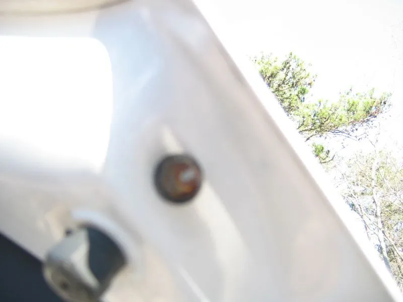

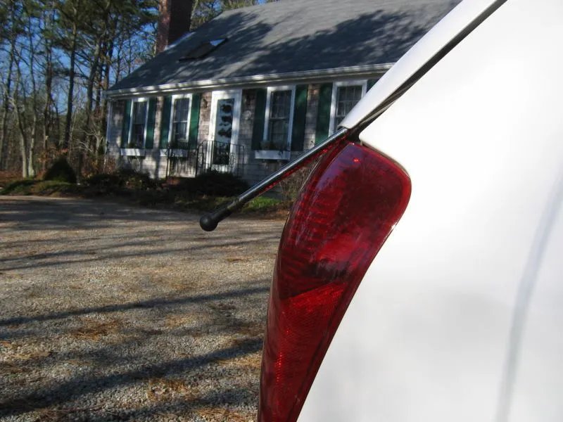

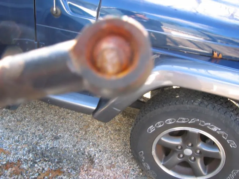

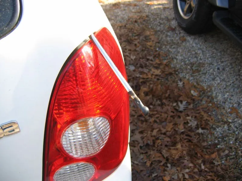

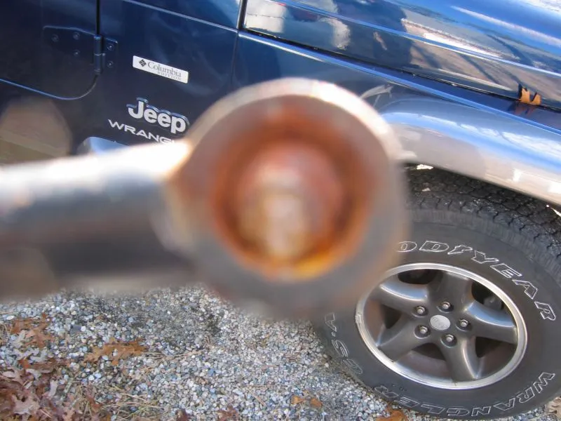

Today the hatch prop decided to snap right the **** off! (shocked)
Nothing happened to it at all, I just squeeze the handle, lift and get poked by a fully extended passenger side prop!
OFC, I got the car runnin, its dark and 2 screamin kids strapped in their seats already. Oh, and its freakin cold out too!
The mount that attaches to the hatch side cleaved / sheared from the little ball (heim joint?) in the hatch side bracket.
I was like WTF ?!?!
I can break anything, now without even apparently trying to mod it first!
I can't even budge the piston back in. So i try to see if the hatch will close and it sorta could catch the latch but the prop is sticking out over the tail light.
OY! Why do these things happen to me? Now what do I do? *sob*

You can buy those hydraulic pistons at Advance auto for like $15. It'll just unbolt. looks like the bottom where it meatst he body has 2 bolts on bracket, undo those, then remove the bolt (Torx?) from it. looks like just a nut on the other end? worst case you'll have to remove the hatch trim to get at it but maybe not. No big deal.....
Oh re: "what do I do?" when thsi happened on my old Cherokee and i was a poor college kid, I just took the piston off. Nabbed a broom handle, kept it back there, just usedi t to prop the hatch open. That worked for 2 years...
trying to close the hatch with that thing hanging around = lovely body damage... great idea! should've just broke the rest of that piece of s*** off the car if you needed to close the hatch right then

Yah it didnt damage the light or body (that I can tell). I would have destroyed the mount trying to break it off and who knows what other damage I would have incurred.
Added pics to 1st post.
