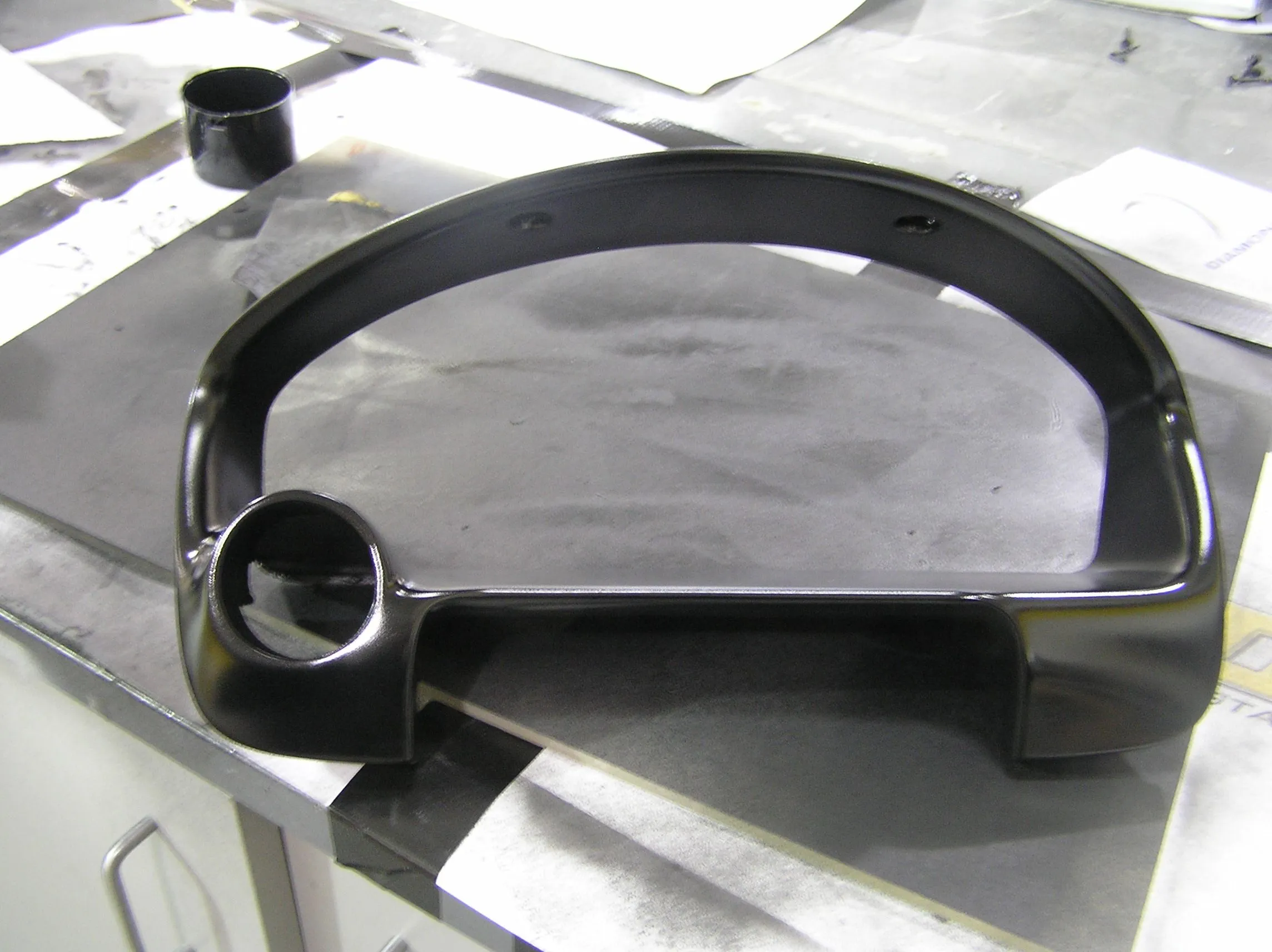

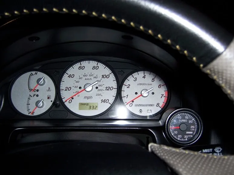

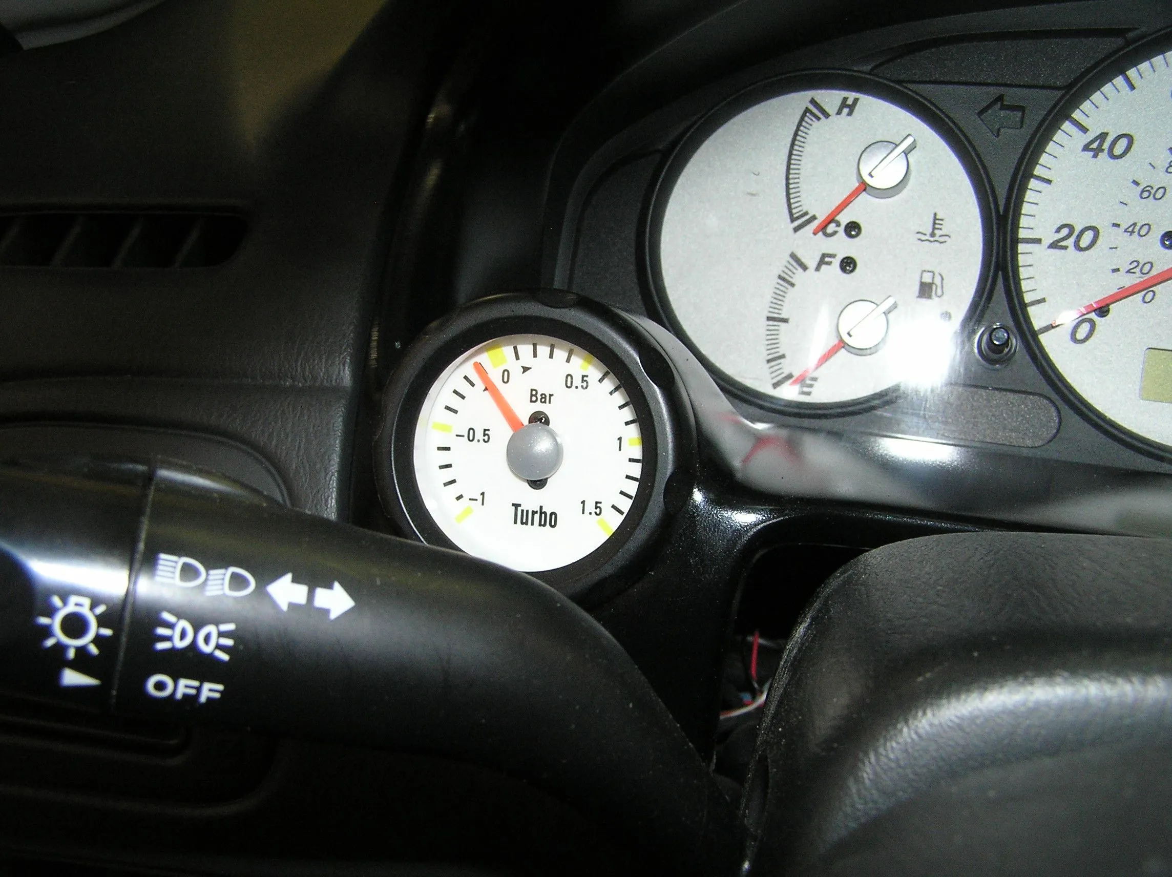

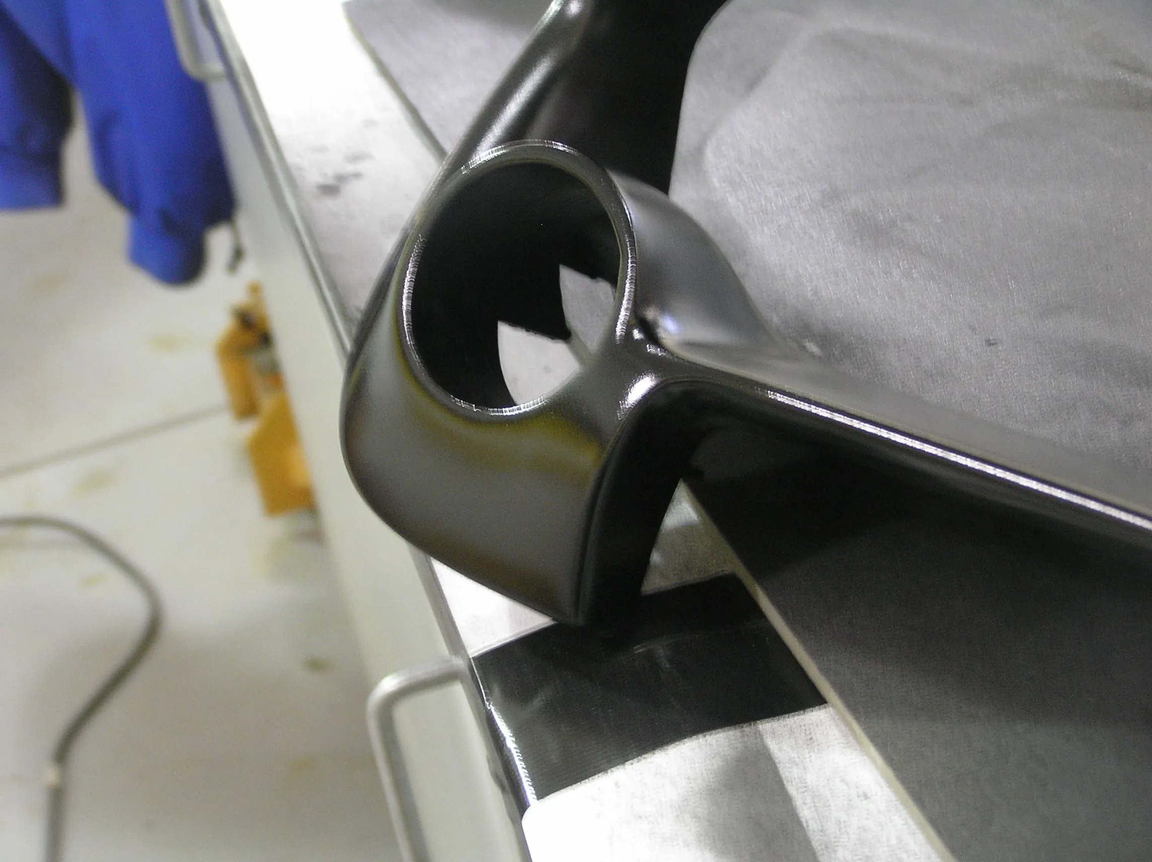

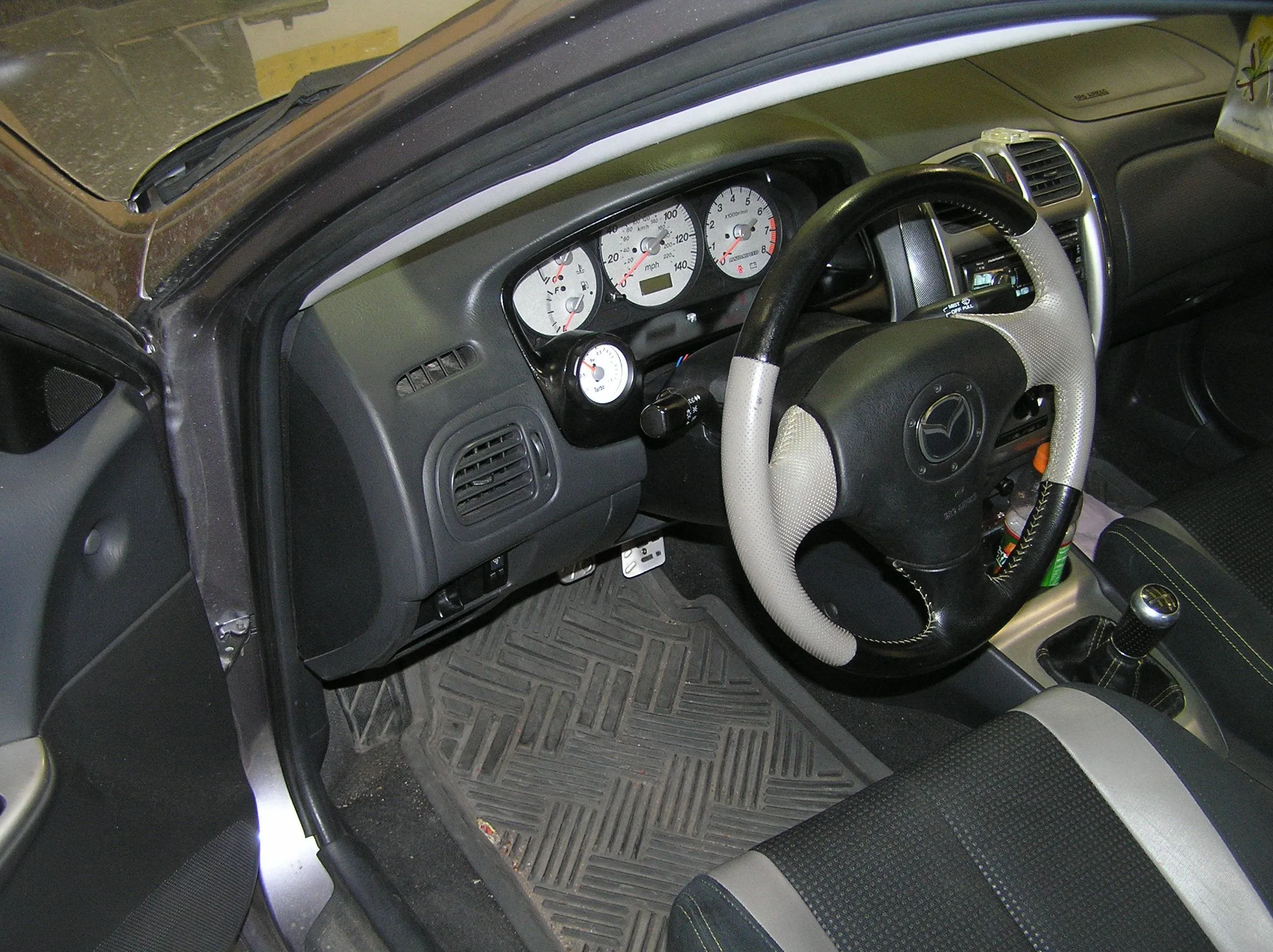

I was looking for a more unique way of mounting a boost guage in my msp, i didnt want to go the piller mount route (a little too fast too furious for me lol)and mounting it on the steering wheel shroud blocked too much of the stock guages so this was my solution it took a little work but it was worth it in the end . tell me what you think of it . by the way the boost guage thats in there is not staying im putting in a silver face blitz guage when it finaly gets here ,the one thats in there was the only one i could find localy on a sunday.
the entire pod was hand fiberglassed and then i usded bondo to get the shape i was looking for. whole project took about 3 days sanding,painting , wet sanding and such

kevin1984 said:
good job
but is that location clearly visible?

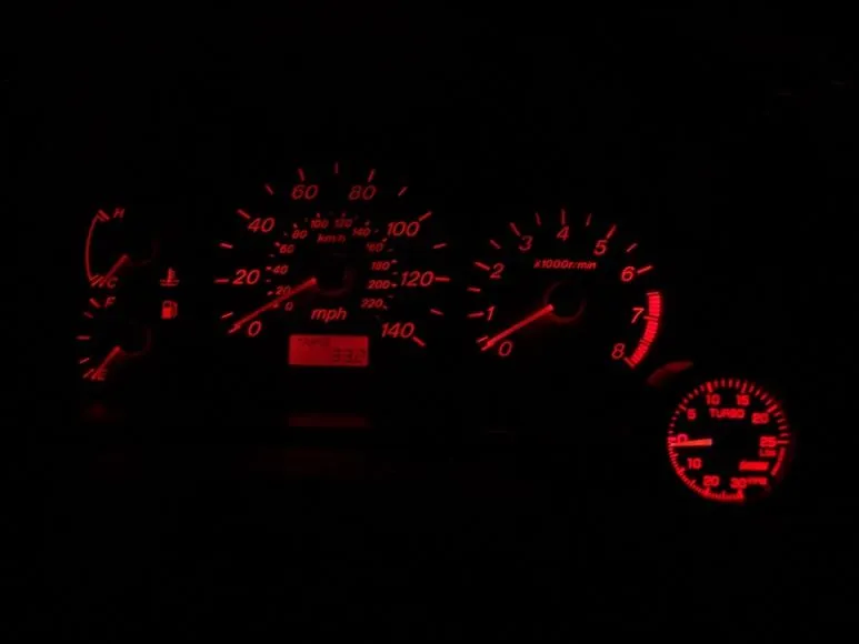

yes can clearly see the guage and all dummy lights behind , and at night i think it is a little too visible
i see home made bezels coming out more & more often everyday, i guess from the lack of starting production on these from suppliers. Looks like you said screw waiting & it def paid off...looks very very clean...How much this project set you back?
also all that work why not dual?

I got the bezel from the junk yard so that and paint already had glass and bondo from my job so around 30$ bezel was only 9$ the rest was paint. i wouldrather spend a few extra $ on auto motive paint and primer than that pep boys crap ,not dual because i didnt feel the need to have much of anything else not going for the ricer look
