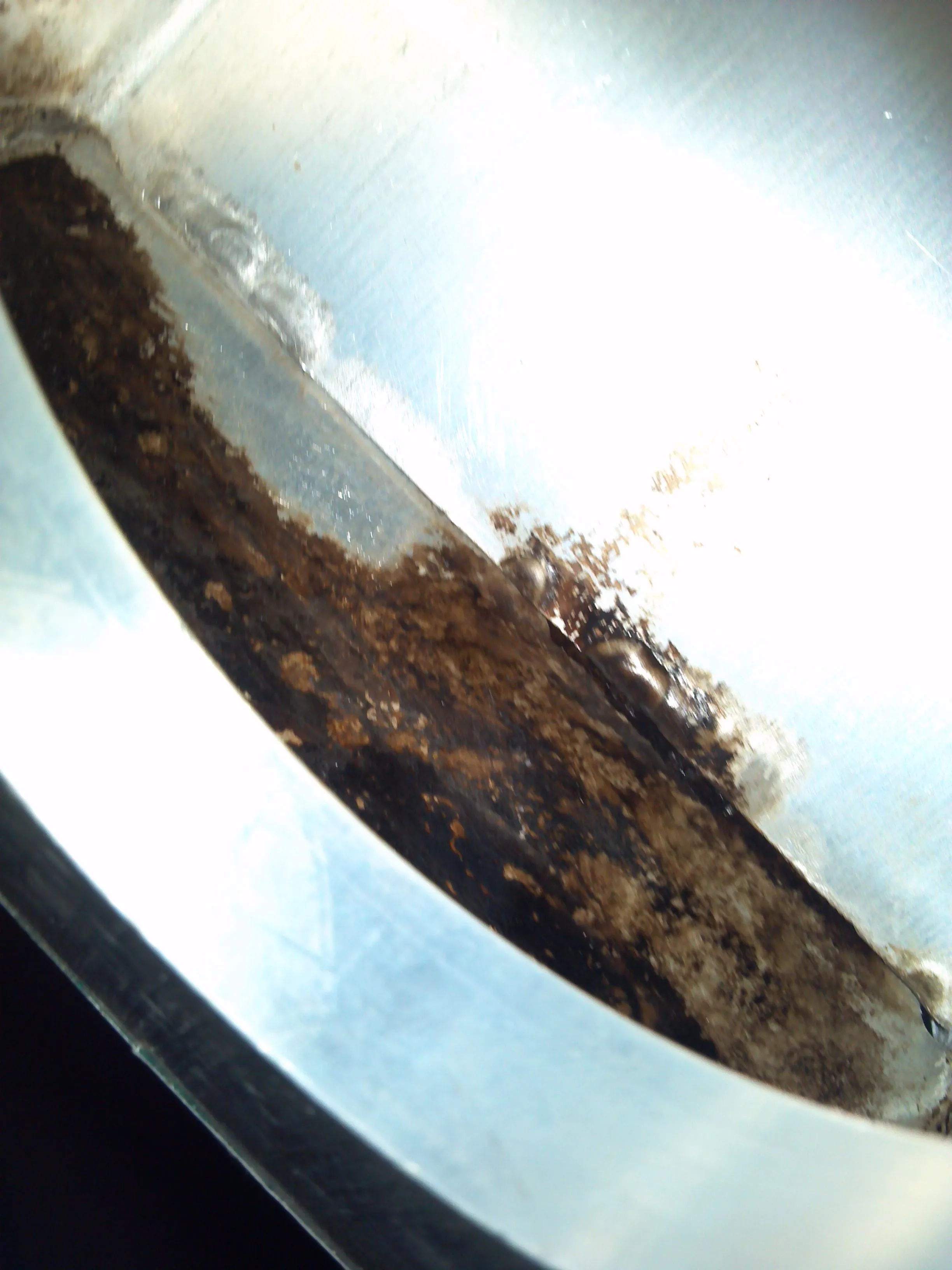

Got my Manifold today! Looks amazing! My manifold wasn't de-burred at all though... what can i use around the injector holes to clean them up w/o removing too much of the coating?
They should all be de-burred (aluminum burrs) now. X-acto or utility blade is the best bet for cleaning up the coating around the holes though.
All extreme chrome's will have some of that since they were stripped. They use a super gnarly chemical process and the aluminum discolors from it. The coater assured that it won't be a problem, and I have ran for over a year now on a stripped one with basically the whole inside looking like that (without seeing any change or flaking or anything).
