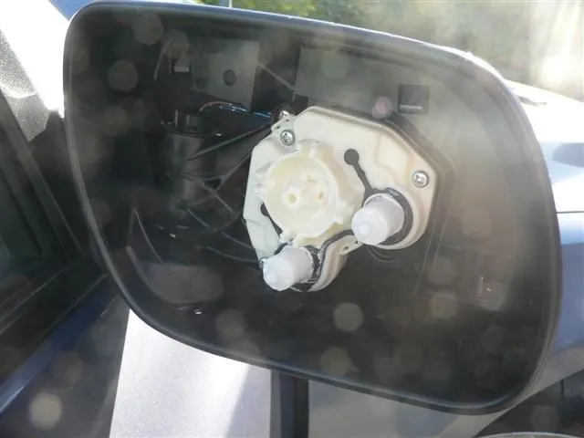

My driver side rearview mirror is cracked due to a pebble that hit it during transportation. Buuut

You can replace just the mirror glass, only a few bucks. It's easy to replace: rotate the mirror glass inside the housing until an edge can be grabbed, then pull firmly. The mirror is retained on three balls and it will come loose with a tug. Put the new mirror over the balls and push to engage. Clean off the fingerprints and you are done.
