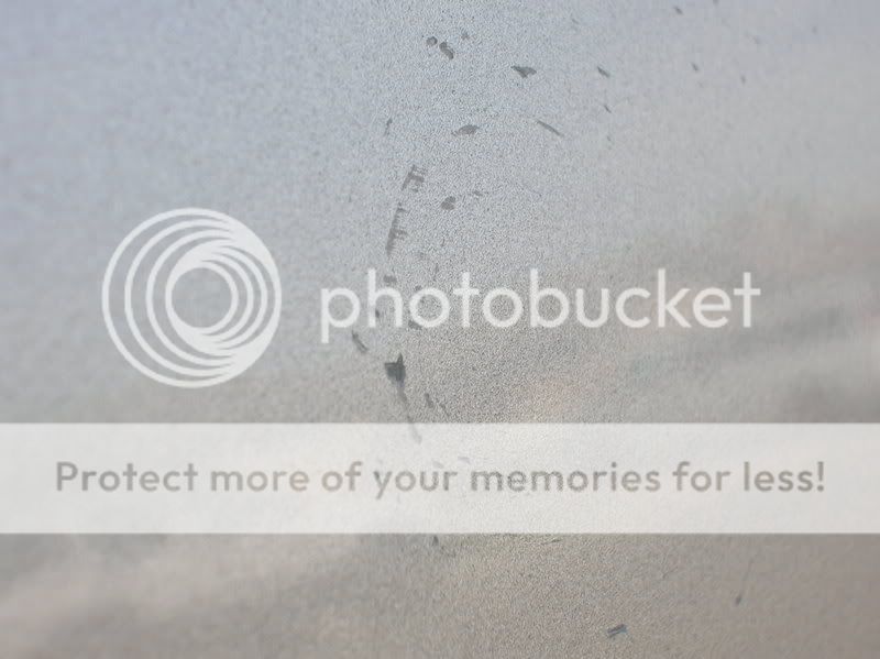

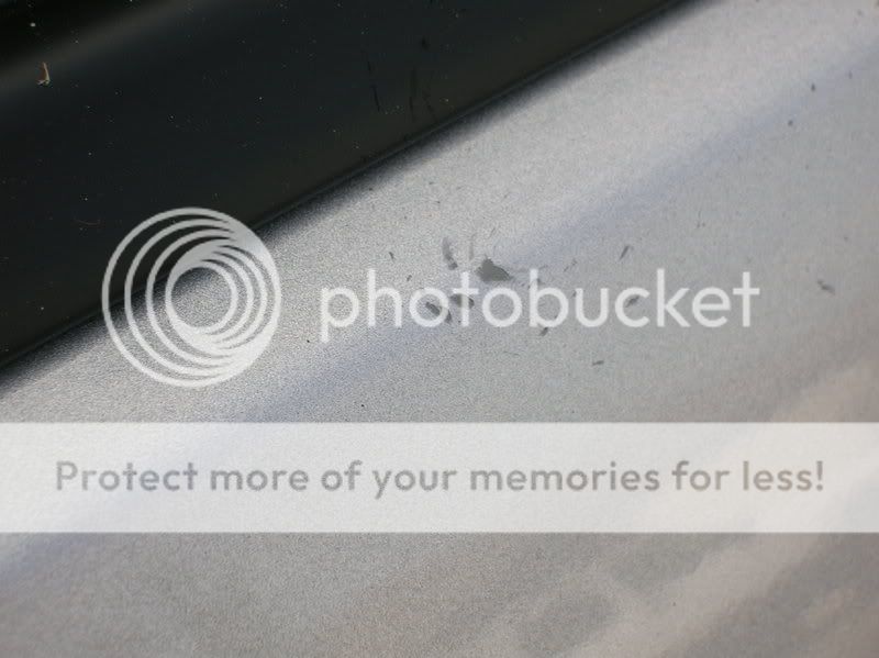

alright, most of you know that my car was egged about a week after i bought it. right now i'm debating whether or not to respray a couple panels or just have the chips touched up. the only problem is, i can't find anyone in my city (bakersfield) that does touch ups. there are ways to do it with much better results than just putting it on with a toothpick. does anyone know of someone in socal that does really good touch up work? you guys think i should just get a re-spray? i have an '07 sunlight silver. i've had it for a little less than a year.
one spot is right below the window trip on the driver door. the other is near the middle of the driver door.

I'm an adjuster so I deal with body work everyday of my life. Touching up anything with a heavy pearl/metallic is going to look bad. Your best bet would be to shoot the door. If it's not too close to either the fender or the rear door, you wouldn't have to pull paint/blend into another panel. A good shop should charge you 1.0hr for repair and then just paint time. Can't remember paint time off the top of my head for a mazda 3 door, but it'll run you about $250-$300 depending on labor rates.

those could maybe be polished out. maybe. i cant tell how deep they are, but they look like scuffs to me...
if you were closer to me id be more than happy to try to polish that out for you...
na, they're mostly to the primer. atleast the big ones are. alot of them do look like scuffs but they're so small i can't tell. there's a couple bigger ones on the door that i can tell and about 4 near the window that i can tell are through to the primer. thanks anyway though, i appreciate it.

wow so im a automotive painter for a ford shop and i spray dupont. the guy who said silver is impossible to match is deff wrong bc nothing is impossible. there are blending techniques that allow you to blend a silver with it looking perfect i would take it to a good shop and have them fix it and tell them it has to match the fender and door then if it doesn't ya can have them blend those pannels for free, i have had to do that sometimes. but i could fix that pretty easy that color actualy matches pretty well a bit light but blends nice the color doesnt have to be perfect to have a hidden repair

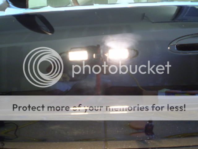

heres swirl removal on a nissan altima. this could possibly work on your problem. but now looking at the pictures, those do look pretty deep... or at least some of them do. i could probably polish out alot the shallower stuff and make it less noticeable.
before
50/50
done
they could probably be touched up, cured, wetsanded, polished... do you have any more pictures of the damage?
