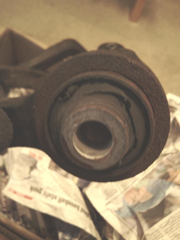

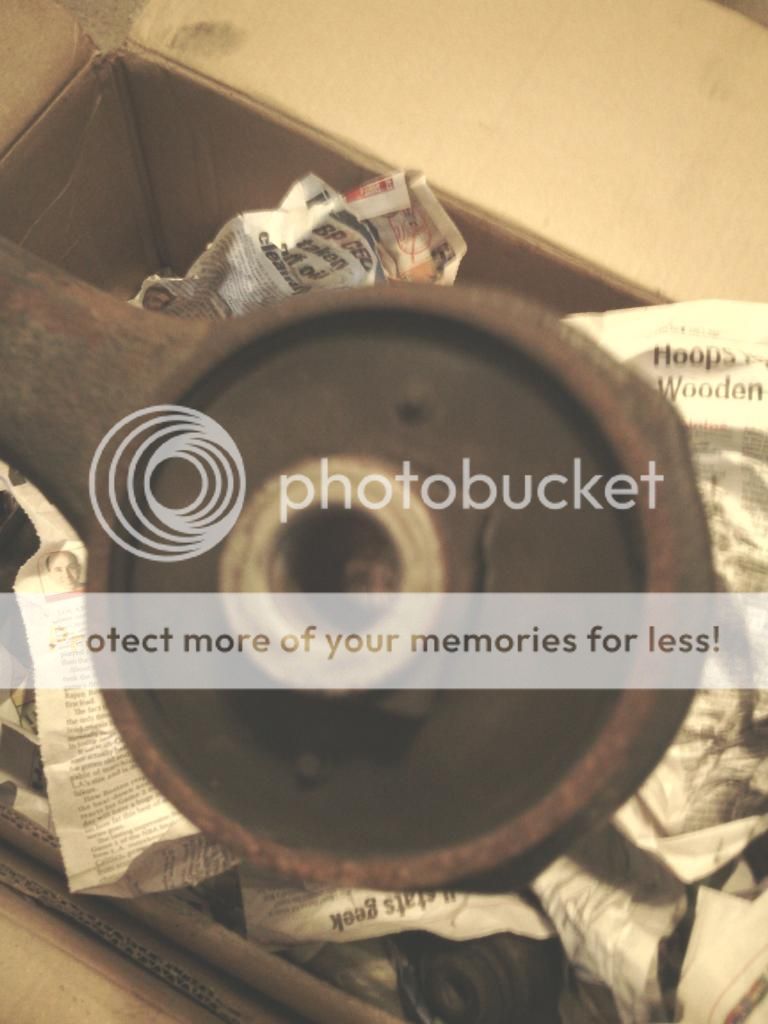

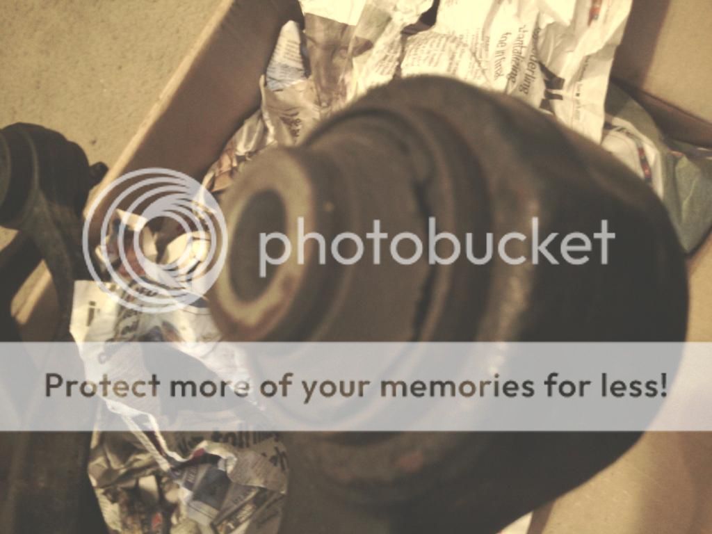

Rearward arms (in bad shape, but probably still serviceable):

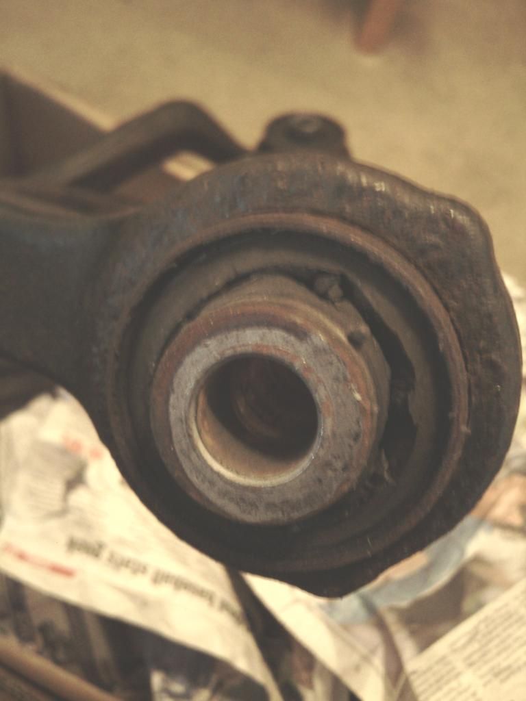

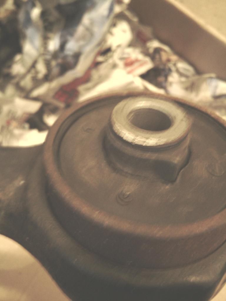

Front arms (gone and then some...):
