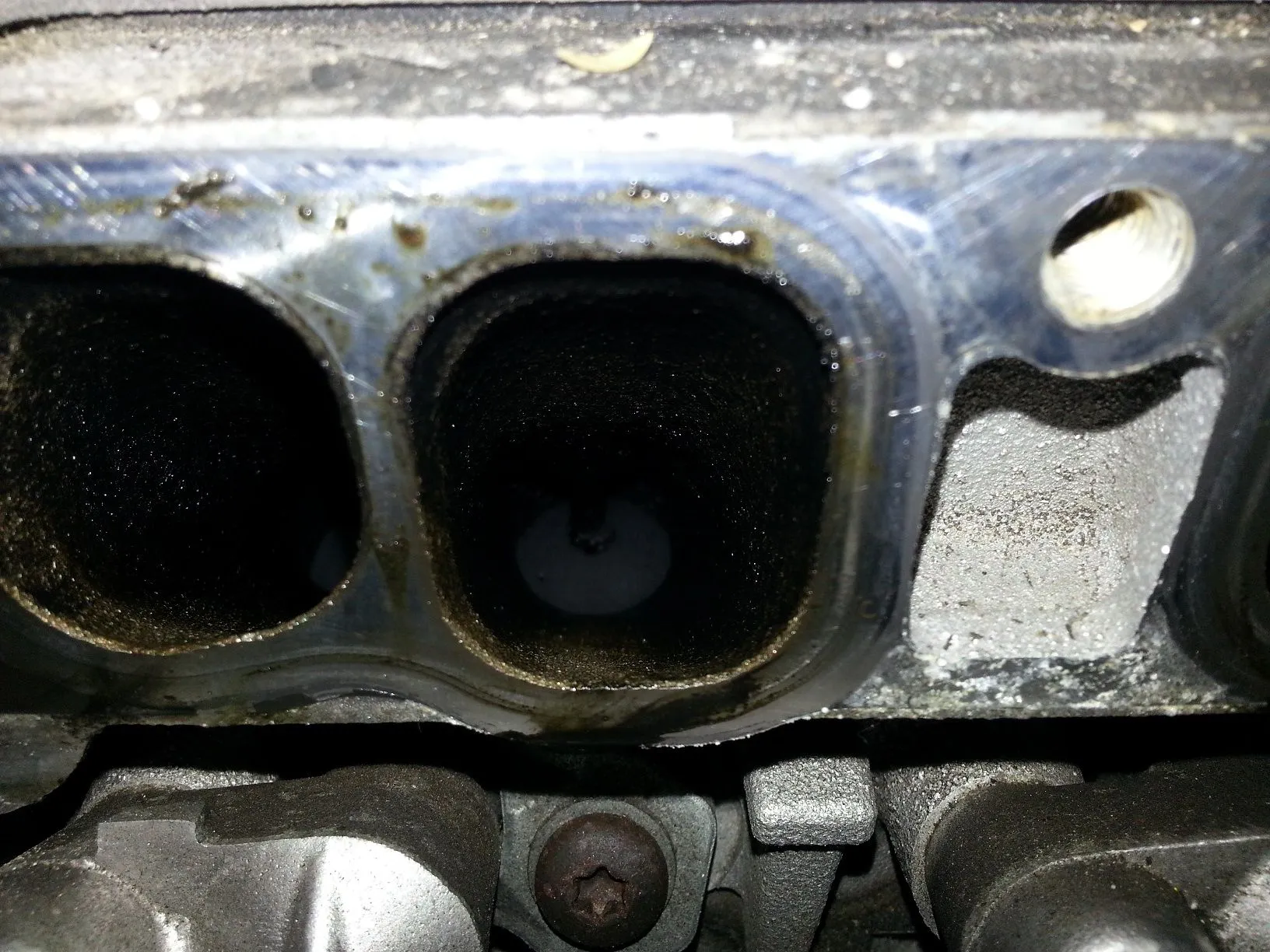

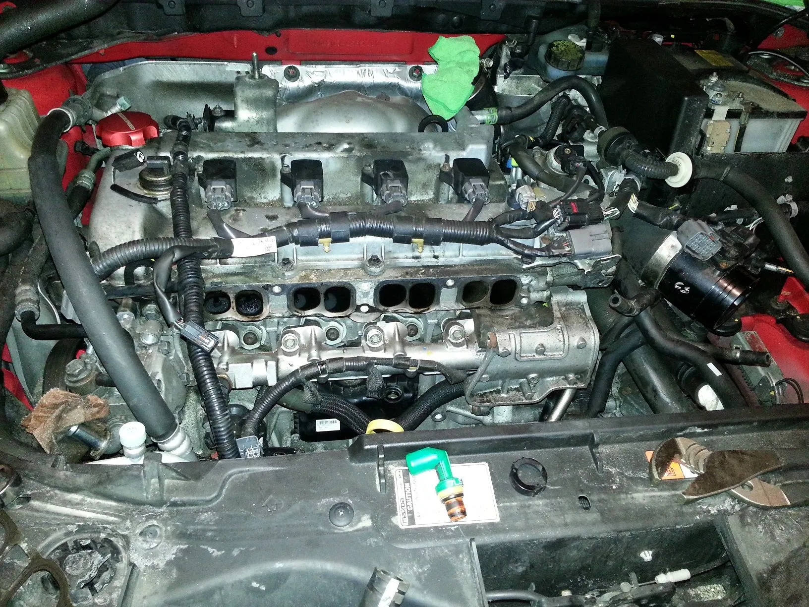

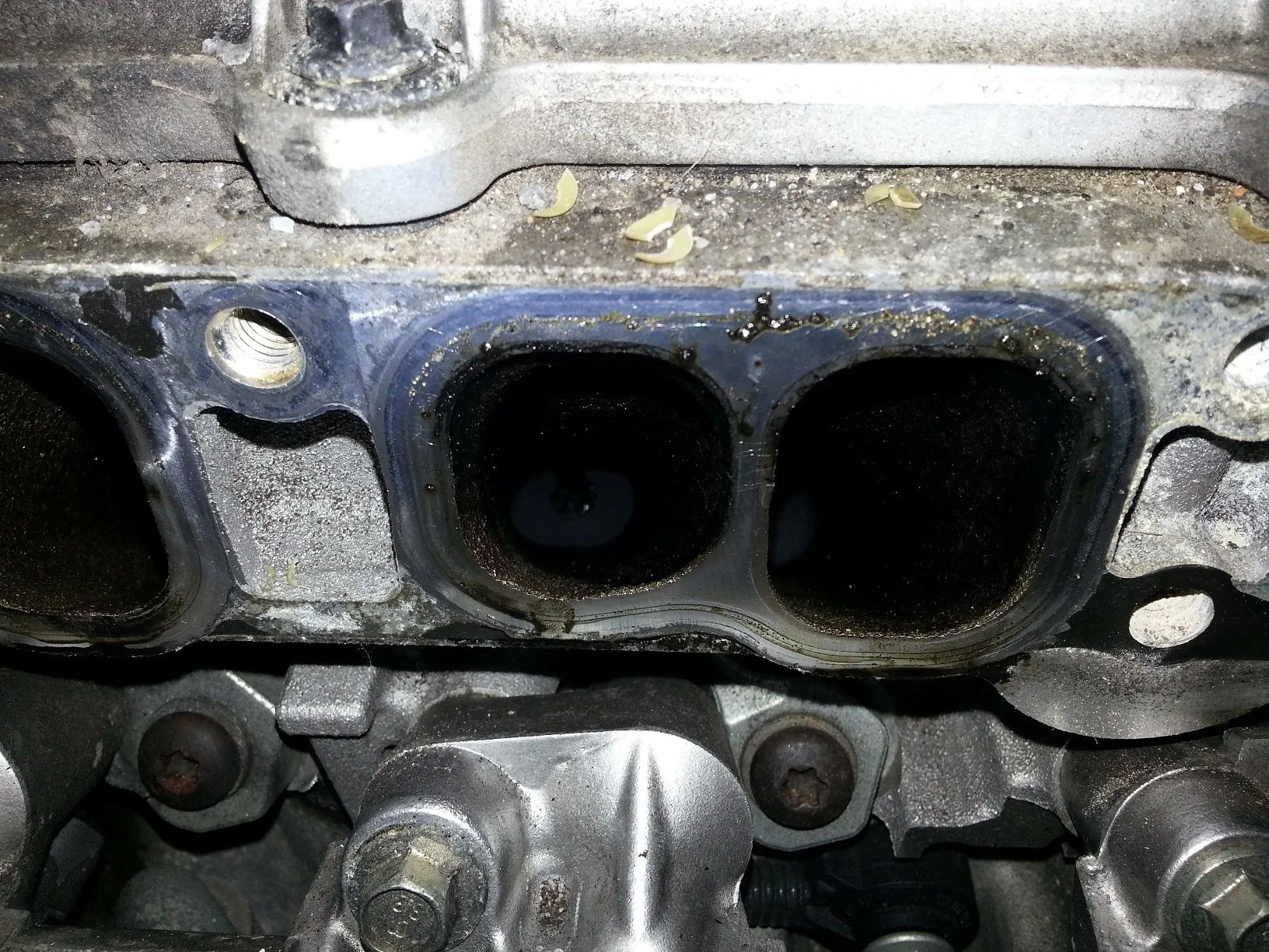

Now the question becomes, at what mileage would Skyactiv motors benefit from a valve cleaning? 30k, 60k, 90k? Has anyone with significant mileage ever pulled their intake manifold to see how bad they've gotten.
Attached some delicious looking pics from another DI Mazda with about 100k on it at the time.
attachment.php
attachment.php
attachment.php
