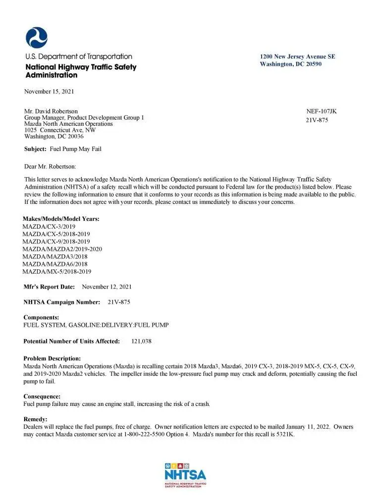

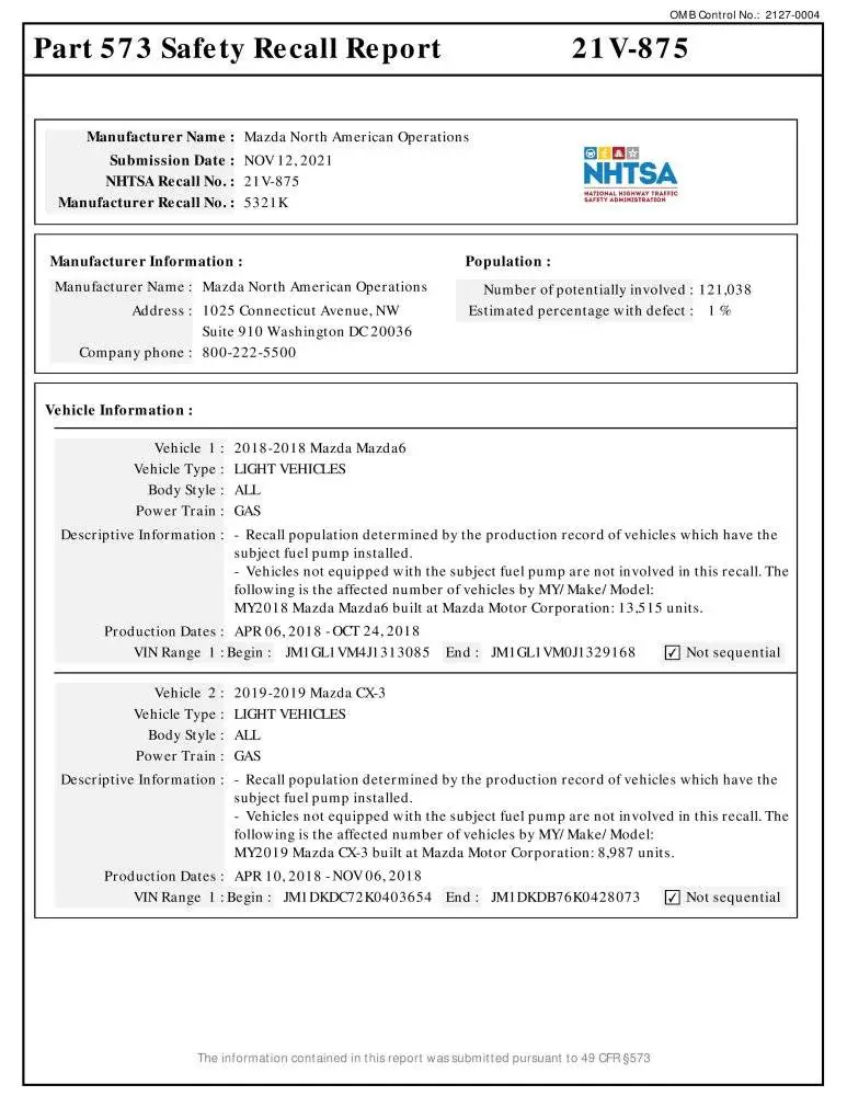

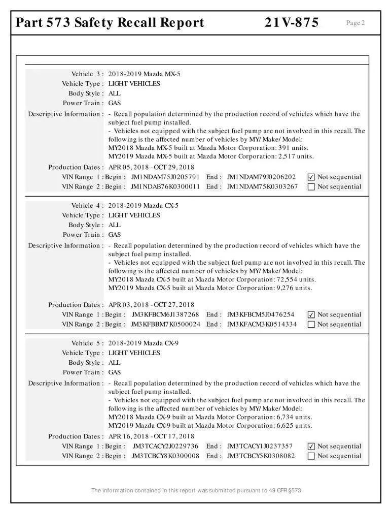

Mazda has issued a recall for more than 121,000 cars and SUVs related to a fuel pump failure that could cause engine stalling.
Affected are model-year 2019 CX-3 SUVs; model-year 2018-19 CX-5 and CX-9 SUVs and MX-5 Miata coupes; model-year 2018 Mazda3 sedans and hatchbacks and Mazda6 sedans; and model-year 2019-20 Mazda2 hatchbacks. At fault is the impeller inside the low-pressure fuel pump, a component that draws fuel from the tank and pushes it up the line toward the high-pressure pump. The impeller may crack and deform, potentially causing the fuel pump to fail. That could cause an engine stall, increasing the risk of a crash.

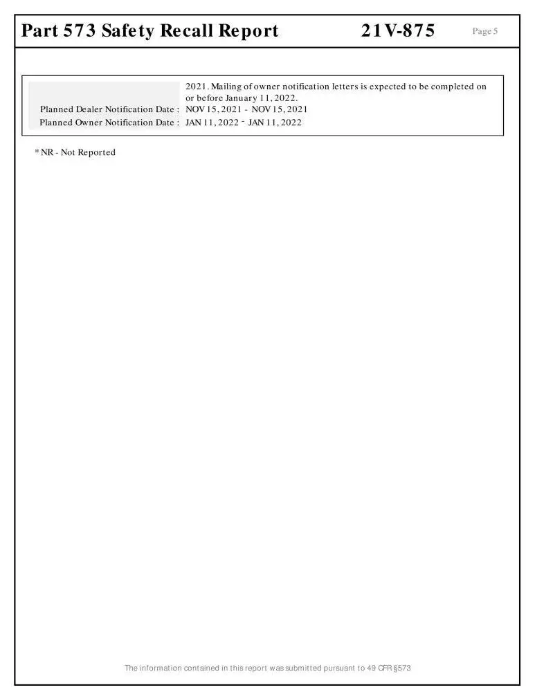

Just checked for mine at Recalls | NHTSA, not showing any open/unrepaired recall, yet.
The article says the recall doesn't go "live" until Jan 11, 2022, so that's probably why it isn't showing up yet.

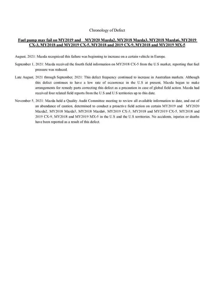

On the topic for the fuel pump issue, calling few dealers for this new recall confirmed that there is no remedy available yet as the part(s) are not available and may be availble next summer.

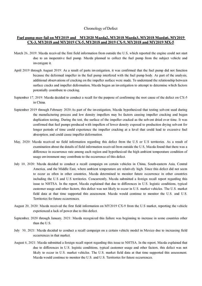

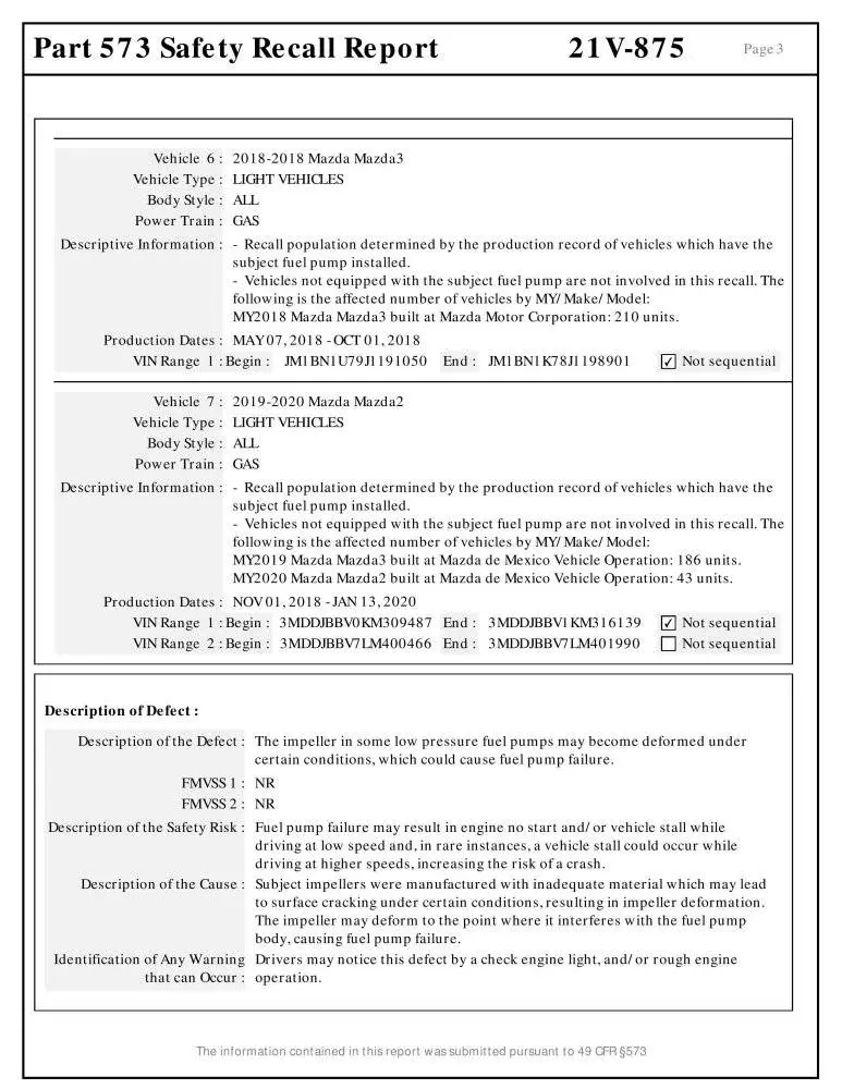

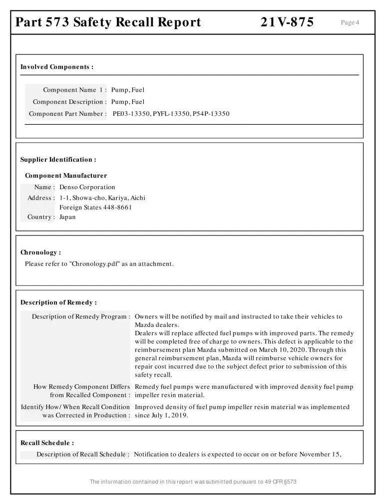

NHTSA.gov shows;
Description of the Cause : Subject impellers were manufactured with inadequate material which may lead to surface cracking under certain conditions, resulting in impeller deformation. The impeller may deform to the point where it interferes with the fuel pump body, causing fuel pump failure.
Then to remedy, new fuel pumps were manufactured with improved density fuel pump impeller resin material. Improved density of fuel pump impeller resin material was implemented since July 1, 2019.
