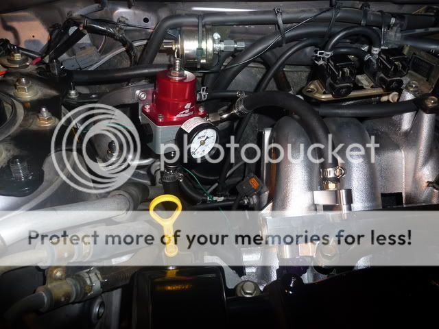

you will not find an aftermarket fpr that screws directly to the fuel rail. our stock fpr is extremely small compared to the aftermarket units. you will have to get an adapter and run a line from the adapter to the fpr.
i am running the aeromotive A1000-6 fpr. aeromotive has a great reputation and this unit is a high quality piece. i bought a fuel rail adapter from mbxmotorsports. other companies make these adapters, so you just have to search around.
here are a few pictures from my setup...
i bought the fpr from summit: http://store.summitracing.com/partdetail.asp?autofilter=1&part=AEI-13109&N=700+115&autoview=sku
hope this helps.

I use the same set up. But on my car the fpr is on the drivers side.
