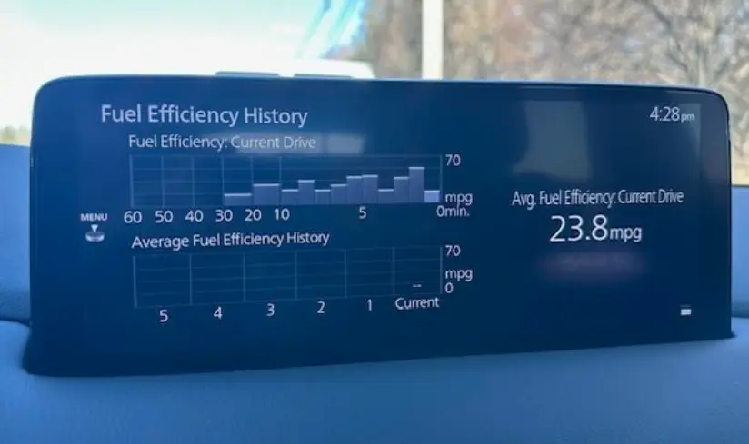

I've been monitoring the fuel efficiency but what I find weird is that the Average History is not loading:
I tried googling and it seems that I am supposed to be resetting the trip A and/or trip B every time I drive?
Does anyone have insight please.

I did - It only prompted me to reset the average history, which I did, which then cleared Trip A, but still nothing displayed in the trips 1-5 as average history.
Thank you for checking - this is exactly what I have been looking for. I've reset Trip A after each drive and also went to options and reset the average there (which was the same thing as resetting Trip A actually), but I still get no average history... :(

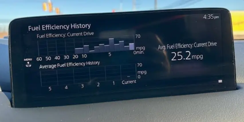

Thank you everyone for your responses. I feel that there is something off with the software or computer settings. This is not the first issue (the other I posted about was the low fuel indicator - I still believe there is a glitch somewhere as it should not come one at 13 miles; my average mpg is 25 so pretty easy highway driving) - anyway, no matter how many times I've reset Trip A or reset the Average Fuel Economy in the infotainment/Information settings, it still does not display the current trip or any of the prior ones. This is on the way home from work yesterday, after multiple resets:

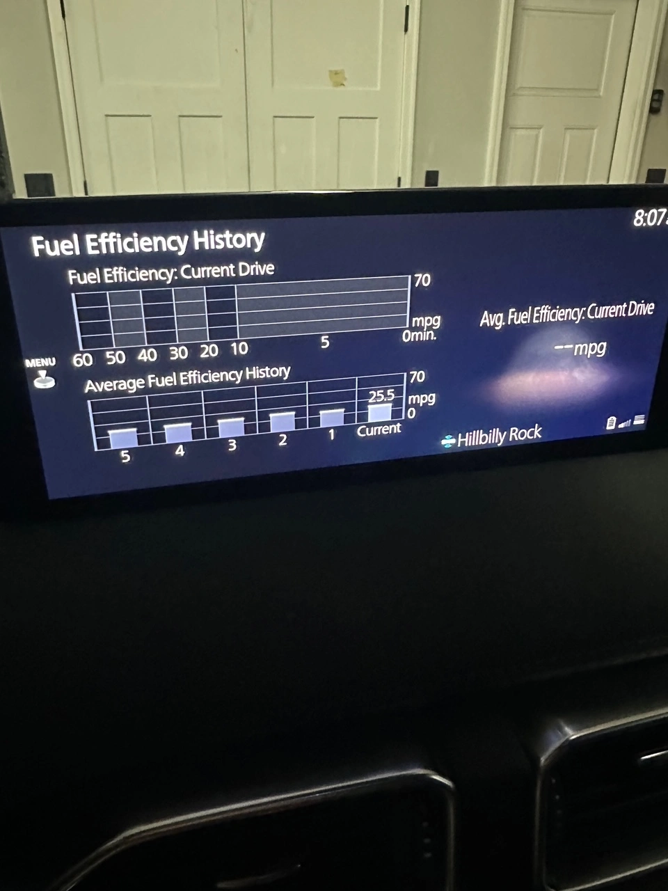

I think the problem is you did the reset in the infotainment setting. Resetting Trip A will move the "average since last Trip A reset" number to the history chart (lower chart) on the infotainment screen and shift everything in that chart by one bar.
However, if you reset average fuel economy in the infotainment setting, it clears everything in that lower chart.
Hi there - I've done both. Mostly I've reset by pressing the 'info' button on the steering wheel to reset Trip A. But as you can see, the bottom half of the screen is not populating at all - even the current - which should regardless of the history. :(

Try NOT to reset trip A and anything else EVERY trip. There's no need to reset every trip. To see fuel economy on every trip, turn on "Trip summary after ignition off" (or something to that effect, not verbatim). You'll see trip fuel economy stat for that drive (right after ignition off) plus average fuel economy since last trip A reset so no need to reset trip A every time.
Make a few trips without resetting anything until you get something on your "Current" bar on the lower graph. That's is NOT your current DRIVE graph and is different than the number on the right that represents your current DRIVE. That is your current AVERAGE from when you last did a trip A reset. If you keep resetting trip A and/or resetting from infotainment menu, you'll get nothing on the "Current" average bar.
Instead, keep driving and not reset anything until you get something on the "Current" bar then when you do a trip A reset, the current bar will move to "1" while 2, 3, 4 shift left by 1 slot.
And don't do reset on infotainment menu. That is not the same as resetting trip A, but to wipe out everything on the lower graph.
