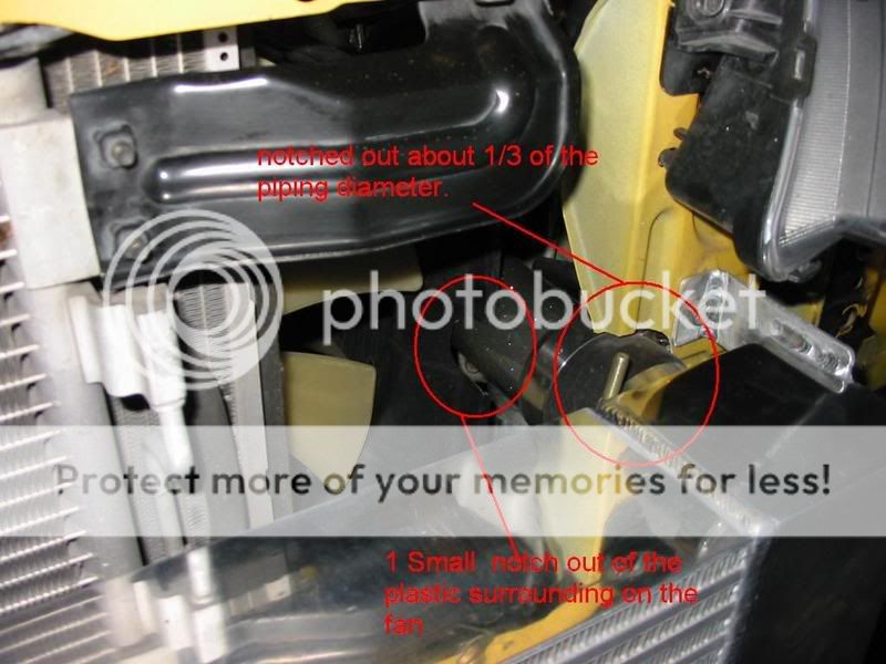

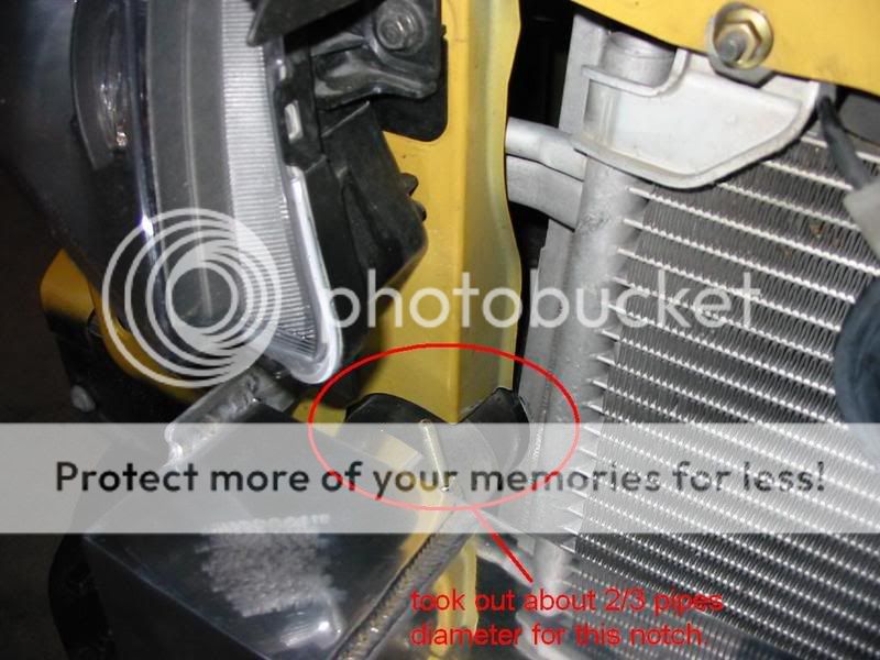

Heres 2 pics of the cutting I did.

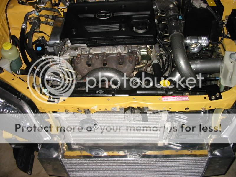

alexB - is that an atmospheric BOV? do you not have a BPV? how does it run for you? what are the dimensions on your intercooler? pics with the bumper on? sorry, i'm REALLY curious about that setup, it looks AMAZING!
This is before I trimmed the tabs off for the stock grill.
Yes I am running open atmosphere.I am running the TurboXS rfl blow off valve. Its loud as hell. Sounds really good. I am not running the stock bpv anymore. I have relocated my mass air flow. It runs really good. I am not totally sure what the intercooler measurements are but I will get them for you by the end of the day.
