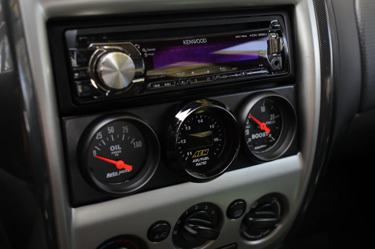

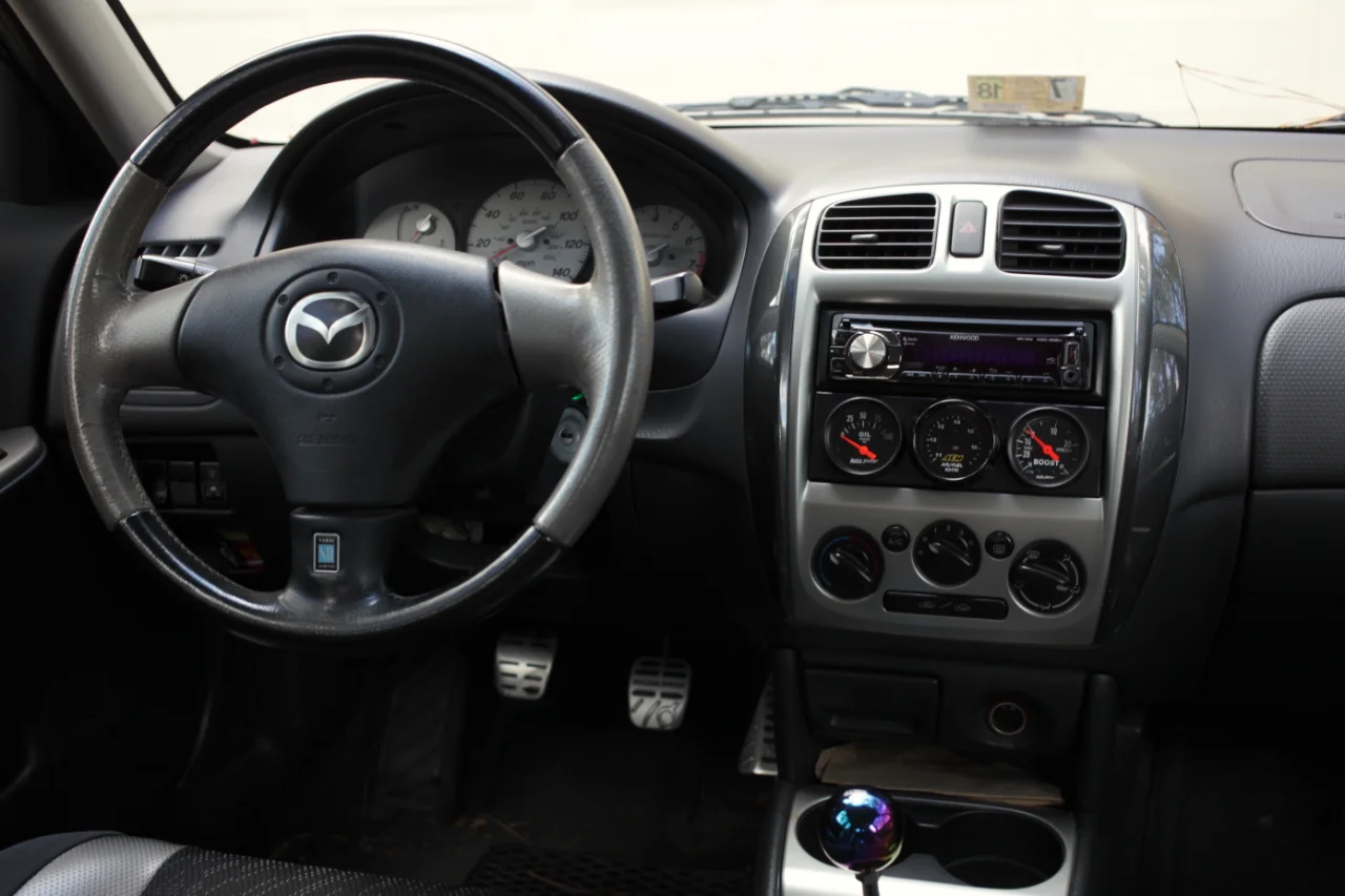

got an oil temp gauge coming soon so i'll be moving the gauges around. here's how they currently sit. my freshly powder coated valve cover will be in soon too

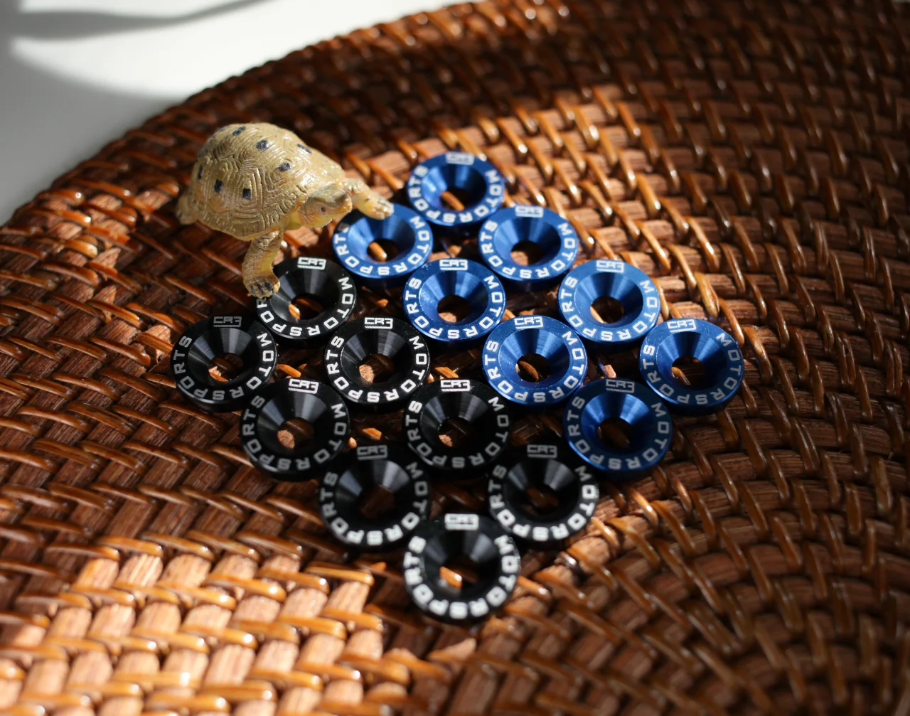

I didn’t arrange all of them for the picture. They’re for the valve cover. I got a set but with two colors so I got enough for two cars lol.

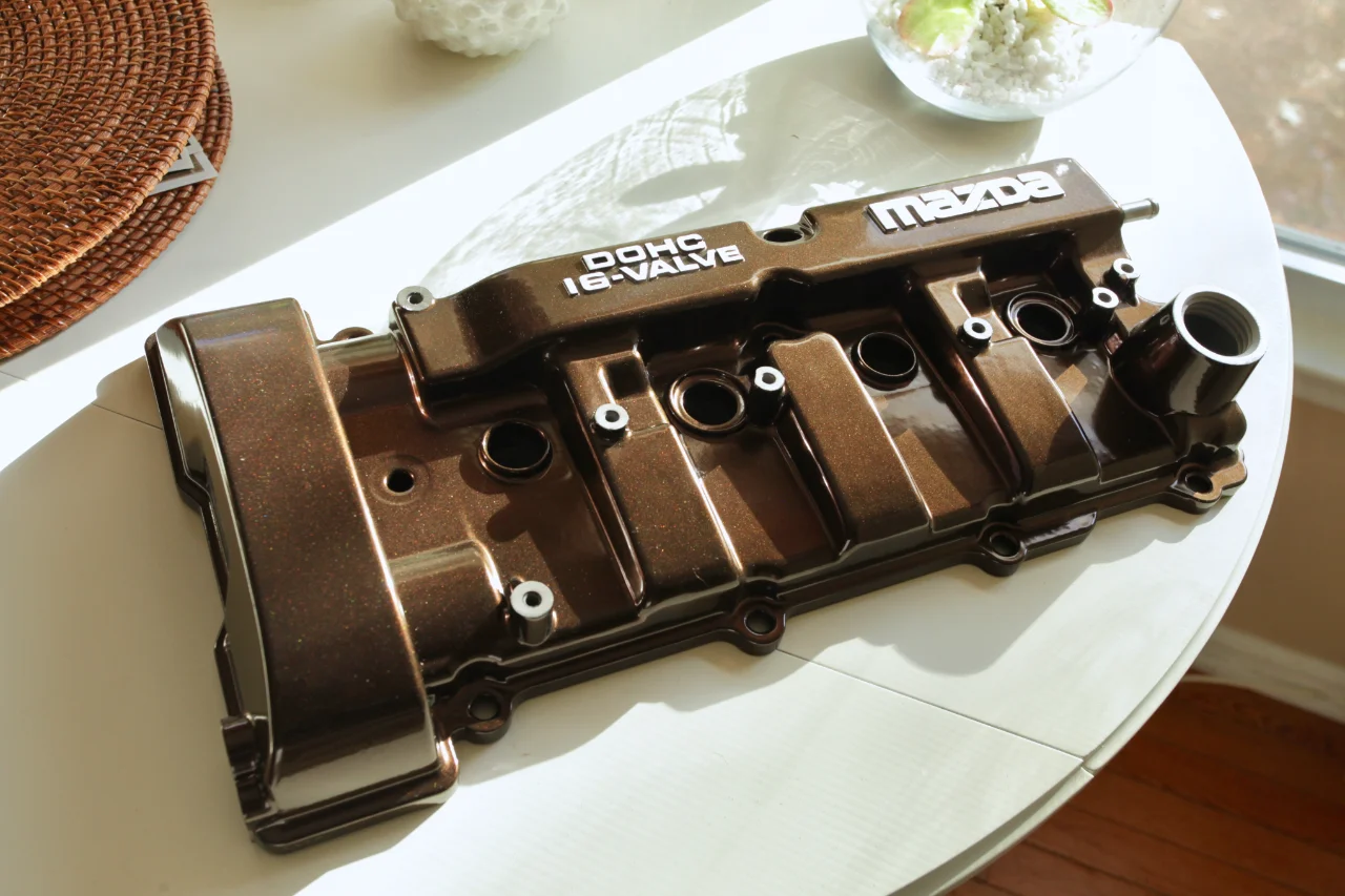

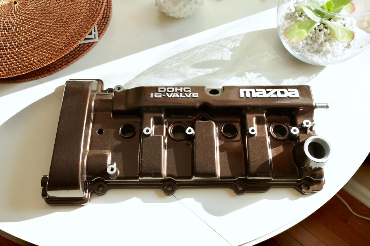

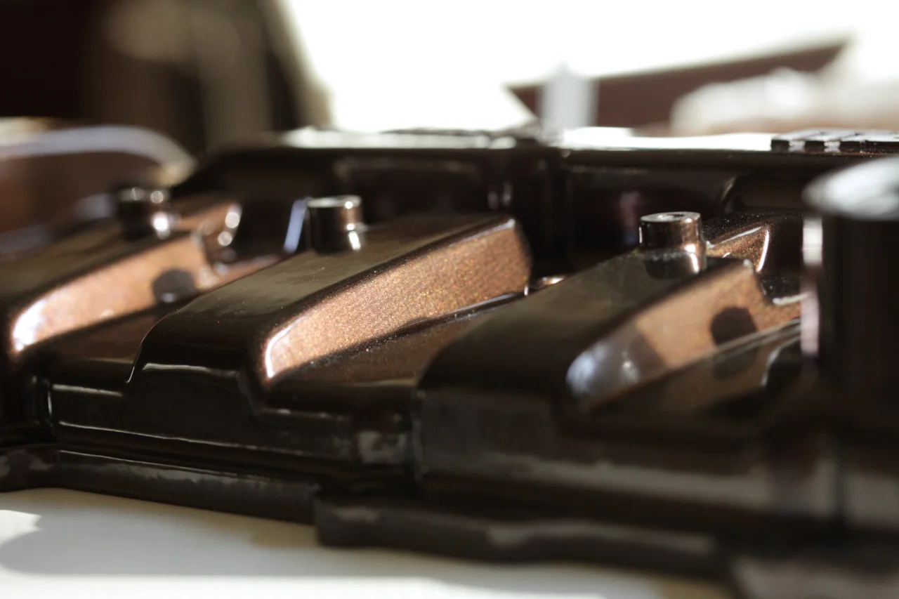

got my powder coated valve cover in. looks like a piece of chocolate haha
323
(u_u) ...zZzZzzz
Moderator

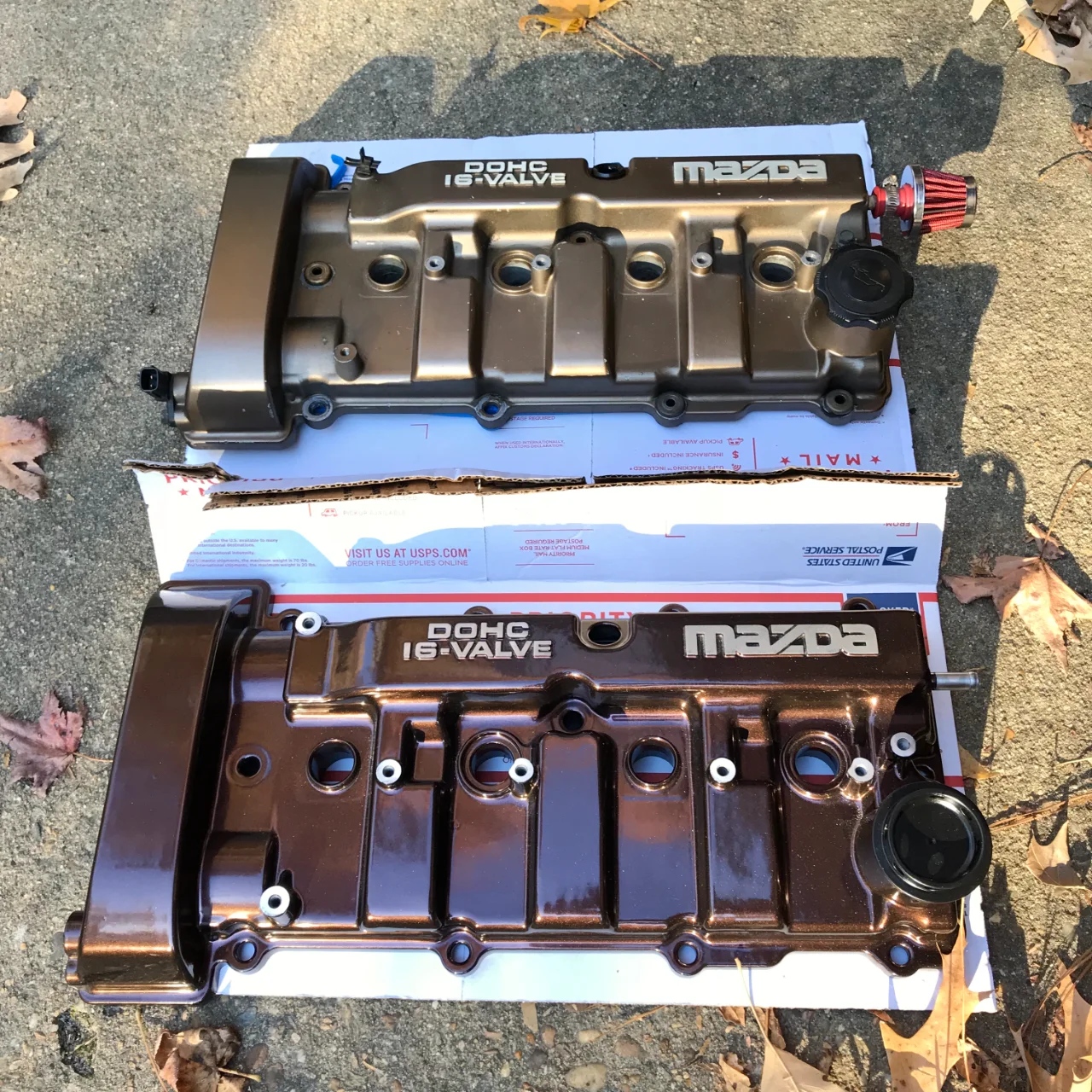

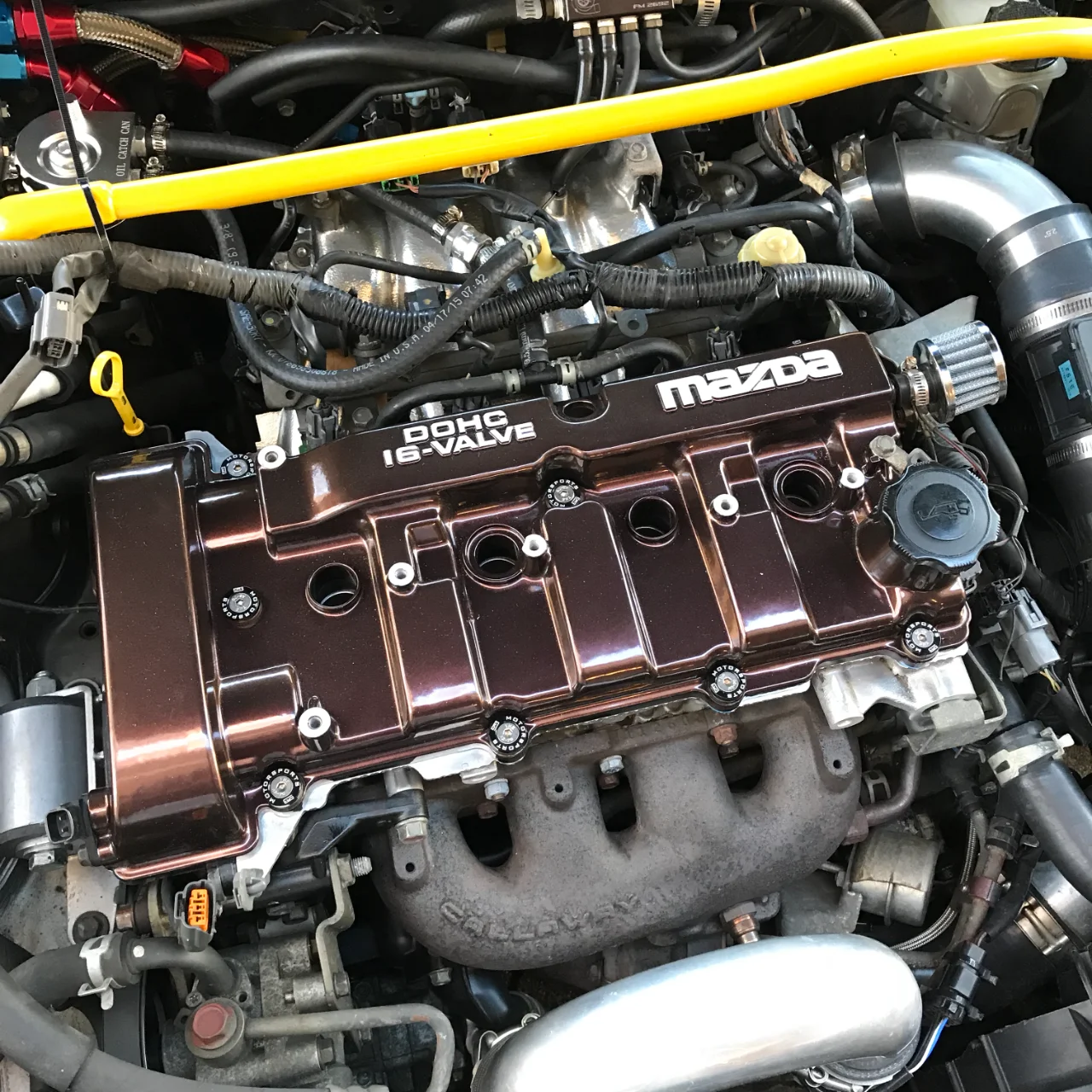

installed the valve cover today. the color is strange in dimmer light but i like it. it almost appears to be a deep red. in fair lighting it just looks like a piece of chocolate. when it's bright, you'll see the bronze like you do in the photos above.
old vs new
installed with new hardware washer and bolts to dress it up a bit.
i broke my old pcv grommet lol. it was old and brittle anyway.
