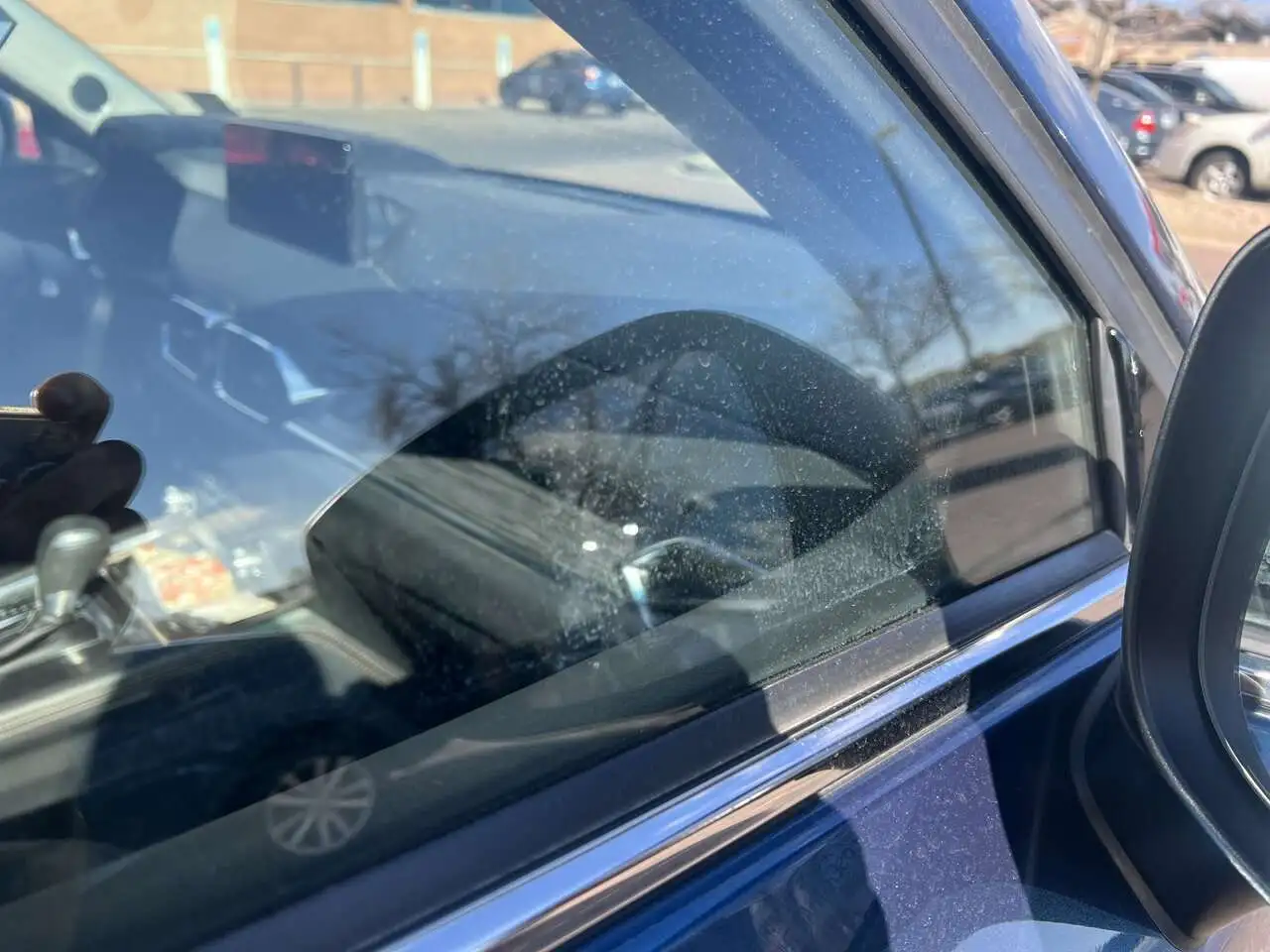

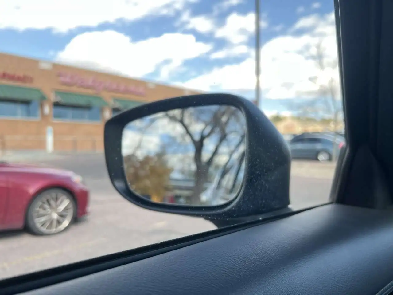

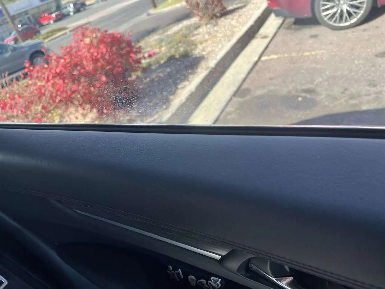

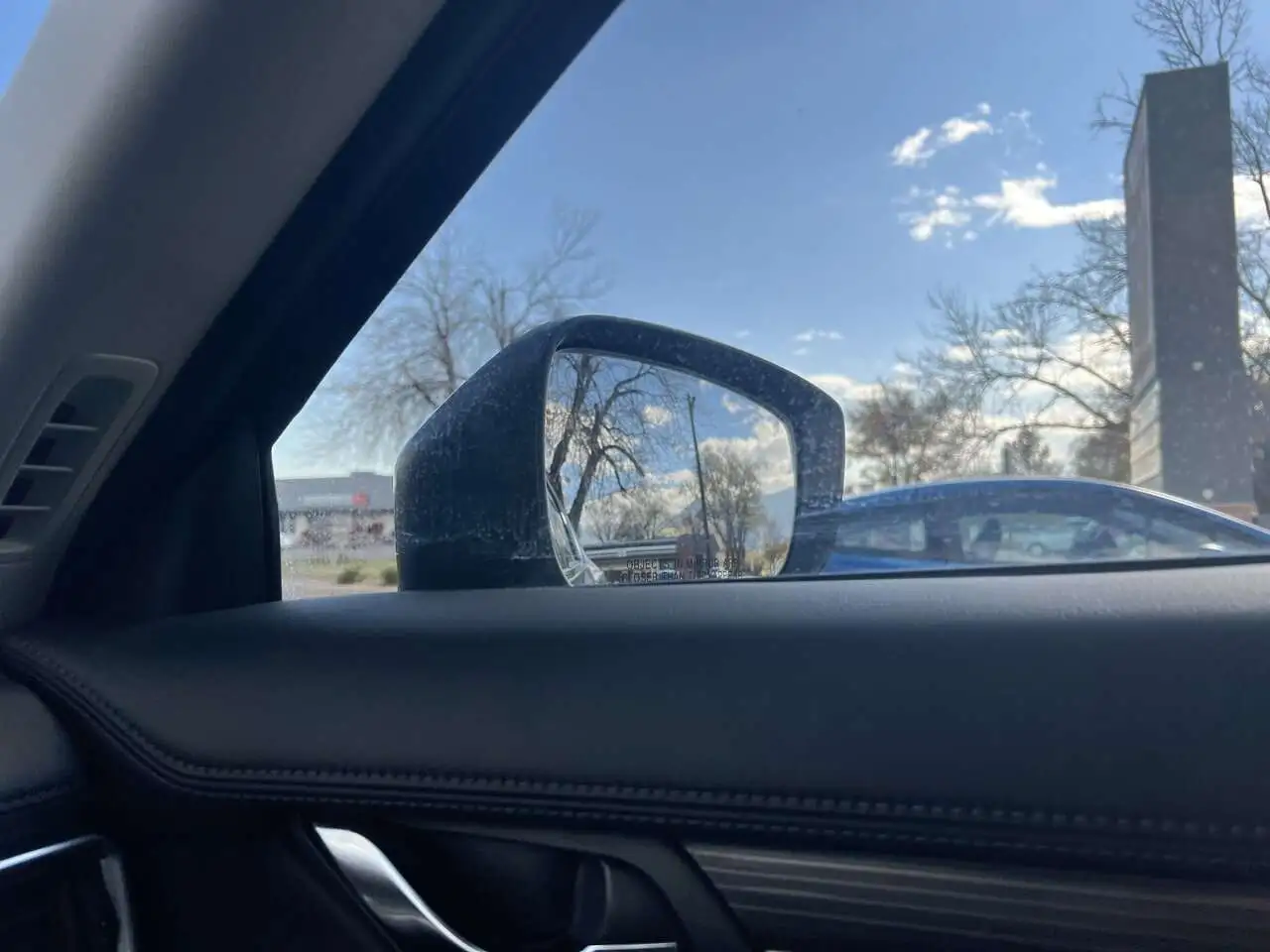

Hi all, at first when I noticed the stuff on the windows I didn’t pay any note since I thought there was just dirt or something on the outside. But when I brought my car to get repaired from the collision they told me that they couldn’t get it off, and then when I brought my car to the dealer the other day they couldn’t get it off either!! (they used glass cleaner, dry wool, etc etc) I also tried rubbing alcohol but it didn’t work either. I have no clue what this stuff is as I never clean the inside of my windows and it’s on all 4 :/ Anyways sorry for the long post but if anyone knows what this is, how I can get rid of it, etc please let me know!! I’m so confused, here’s pics: (it’s really close to transparent so it’s hard to see) also it’s on the inside of the windows, you can feel it’s less smooth than just glass, and it’s more towards the bottom of the windows.
(the last pic you can also see some dirt on the outside of the window)

Window tint adhesive residue?
Do you have someone detail the inside or do it yourself? ... Some kind of "armor-all" type protectant ?
It sure looks like a liquid that kind of "runs" down a little then dried. My gut says some kind of protectant overspray. Maybe something like goo-gone, WD40, mineral spirits, etc. Just have to (carefully) try different things on a small towel or cotton ball to find what cuts it. Heat could effect it also.

It looks kind of like hard water stains. Try @wlong01's homemade window cleaner.
I once bought an old fish tank that had a ton of similar looking stains that were a bit rough to the touch. To get rid of them, I would spray some white vinegar onto a paper towel, lay it flat against the glass, then put a layer of plastic cling wrap over the top of the towel. The cling wrap keeps the vinegar from evaporating too quickly and also holds the towel in place against the glass. I left it alone for like 15 minutes, and when I came back, the hard water deposits wiped off very easily.
With that said, if you try wlong01's cleaner or just straight vinegar, and it now feels smooth to the touch, but still looks dirty, it may have etched the glass as @Martyd suggested. If that's the case, you might need to have someone polish the glass for you.

Ahh, thanks!!!! Hard water stains (just had to google it) seems spot on by descriptions and pictures I just read :)
I'm about to go out to get vinegar etc. for @wlong01 's recipe, I'll report back if it works. Thanks for the saran wrap idea though! Happy to have some hope that it might come off with all of these formulas and methods.
