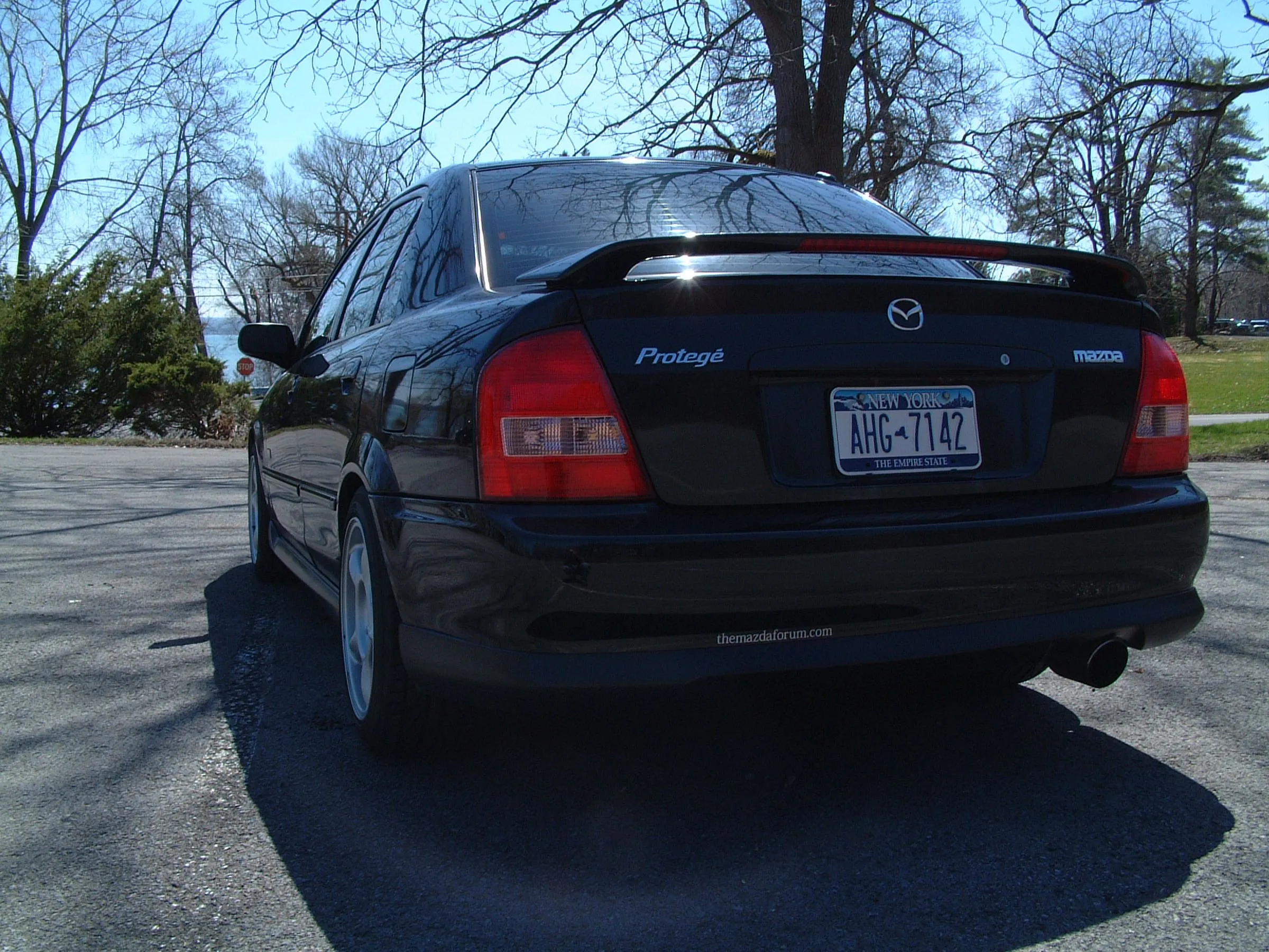

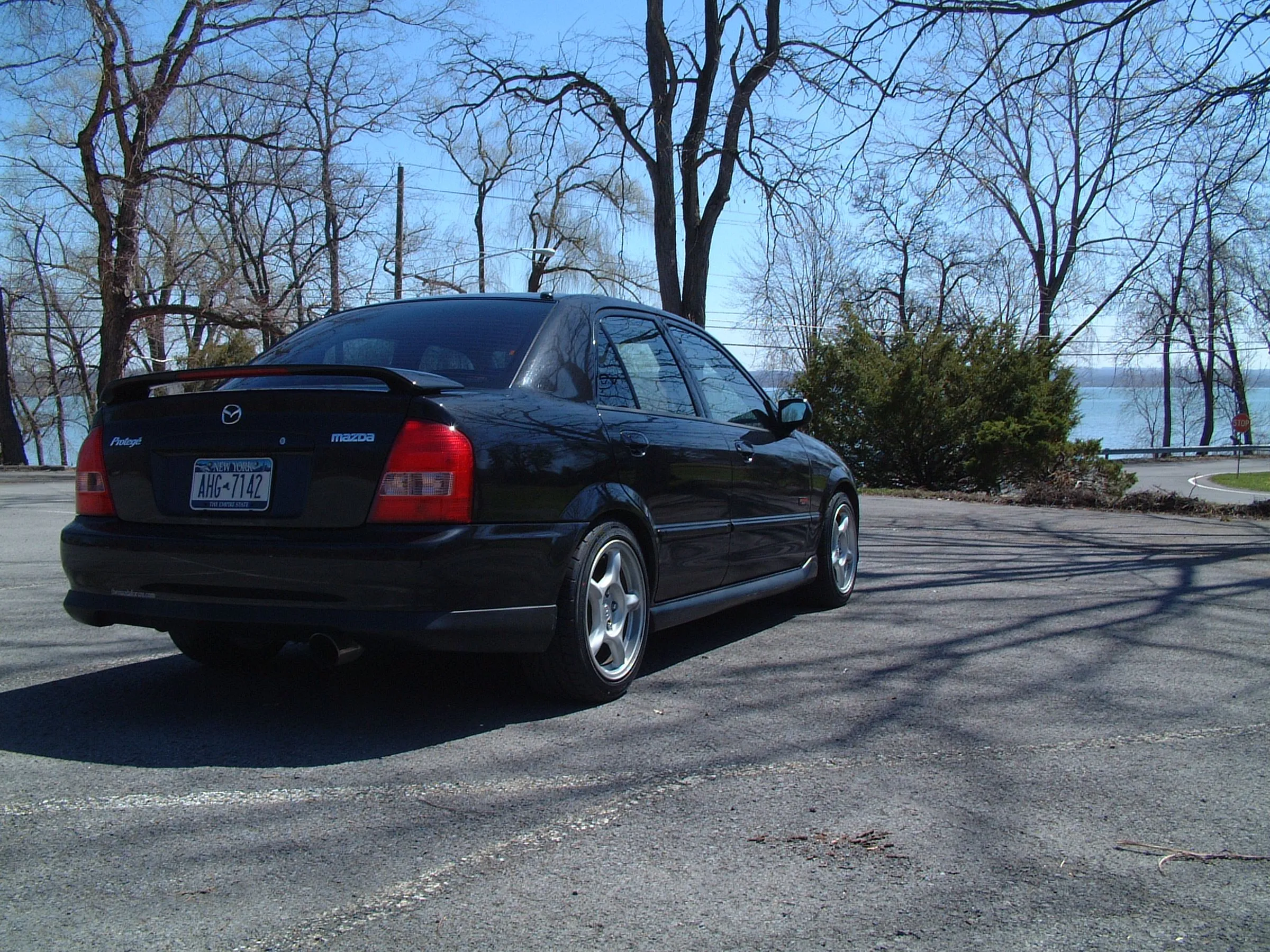

Here is a side profile shot-
attachment.php
And attached are a couple of side shots.

i was worried about having to perform a fendor roll, and i debated on what tire size i was going to use for over a year. it sucked having the rims in the garage and not on the car for that long, but it was worth it. my second choice would have been 225/45-16's. if i have the car long enough, and need to get new tires again, i might get that size. (now that i know i have some clearance)
