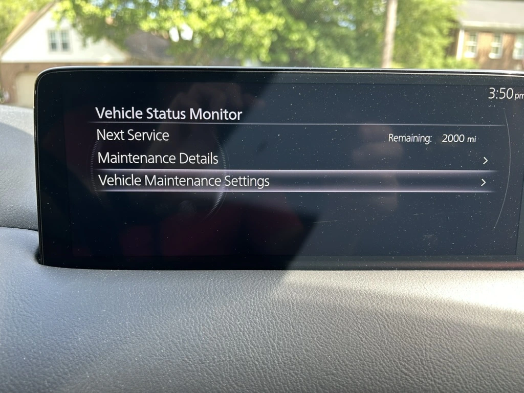

OK, please don't jump all over me if this is in the manual as I've scoured it and can't find the specific answer I'm looking for.
So, how can I tell if my 2022 CX-5 is using Engine Oil Flexible Maintenance? I know it says that's the default in the US, but I bought mine used and it could have been changed.
TIA,
Tim
yeah could be changed. Search for the menu that shows vehicle status in the infotainment syste
. the maintenance menu is inside and shows the flexible or can be switched to manual. Right next to the menu that shows the fuel consumption for the trip
As far as I could tell, this is not anywhere in the owner's manual. I'm pretty sure this is the setting however it would have been helpful if they used the terminology in the car settings as they did in the manual.
I hope this helps somebody in the future.
Start with the Vehicle Status
yeah. I sometimes alternate between both but I dont like that on automatic it drops the miles to service in thousands only. ie 7500 6500 etc and doesnt show much other setails like date or % oil health.
its basically a useless feature but prob works for most folks.

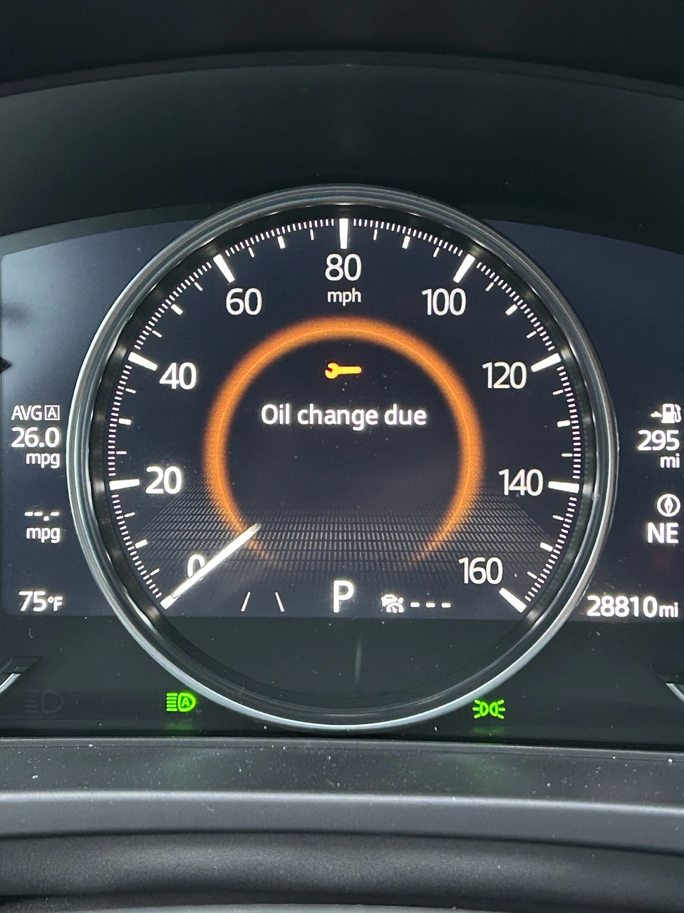

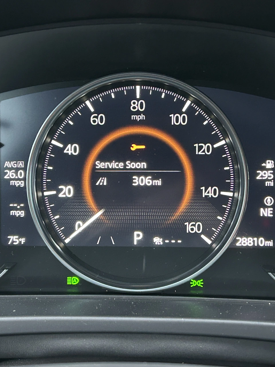

I'll just note that once you get to about 600 miles to go, it starts warning you and has the exact miles. Like it will say 347 miles so while it may start a thousand miles at a time it does drop.
