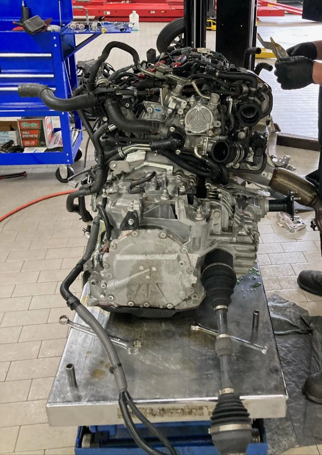

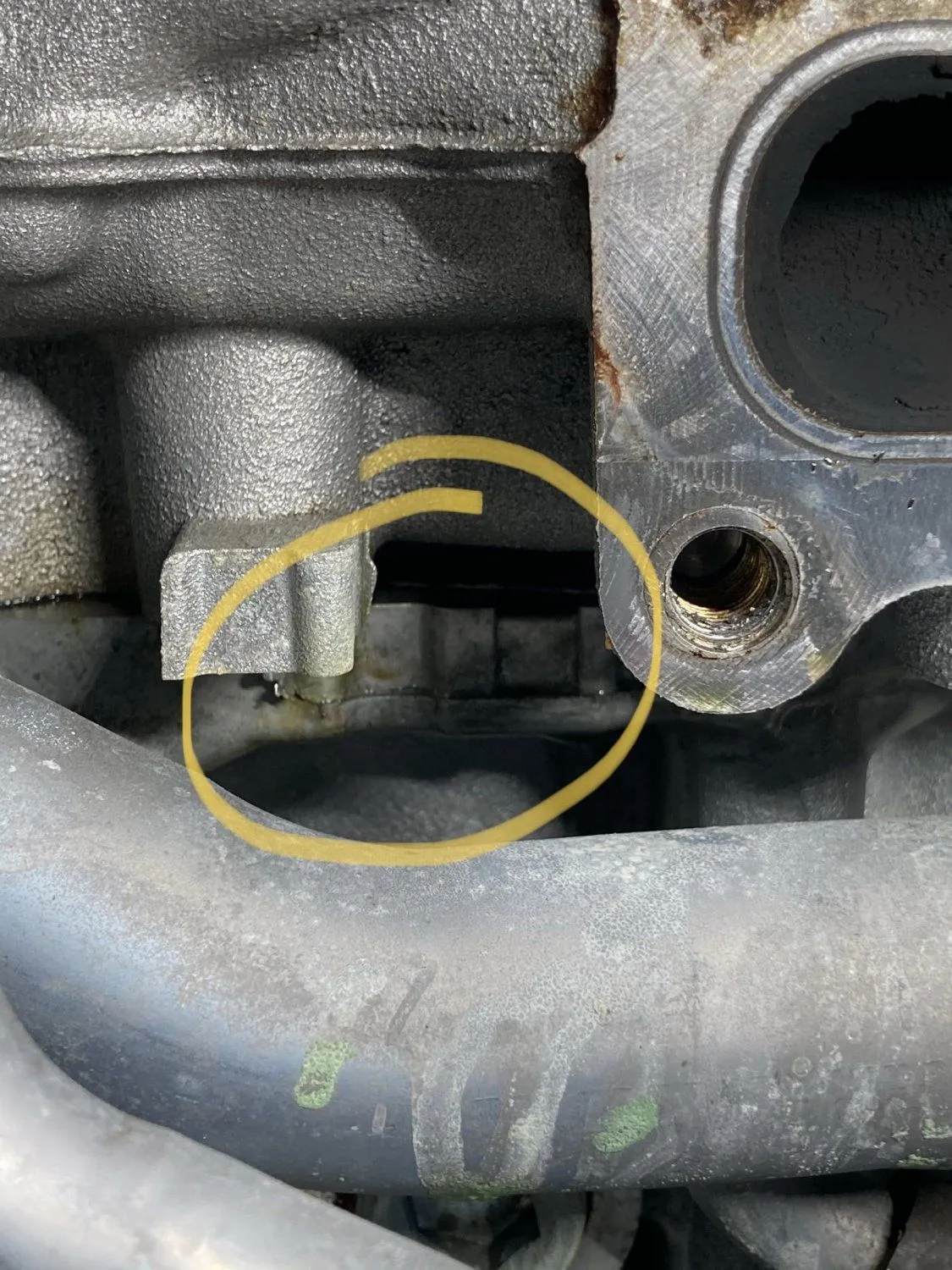

Here are some pictures of the cracked cylinder head.
The explanations for these coolant leaks aren't making a lot of sense...
Why replace the entire long block if the damage is limited to the head? This is turning a $2000 job into a $5000 job.

According to mazda it has to be removed, not much room when working on timing chain I guess.
I guess Ford was not the only source of bad ideas in the Ford/Mazda partnership. It kind of blows my mind that you have to pull the engine to change the head... Especially with how large the hood/front end is on these cars.
I believe Mazda has bought back from Ford a while ago, however what was a bit odd was when they put the engine back in, there was a problem with the timing and compression and they had to pull the engine a second time to fix that. Ofcourse they did not charge me for that.

From the OP’s posts, the original thought was it needed an engine....then discovered it was the head. Perhaps they found the problem with the head after the motor was pulled?
The Ford/Mazda partnership ended 12 years ago. There is zero Ford influence with the 2016+ CX-9.
Precisely. Mazda managed to jam the engine in so tight that you need to pull it to replace the head all by themselves, without Ford's help. Keep that in mind the next time everyone blames Ford for all the problems on the previous generation
From what they told me they scoped the engine and found the crack before they removed it. However they would not know the extent of damage to the block until the head was removed. Lucky it was just the head.
