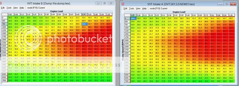

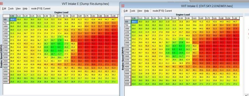

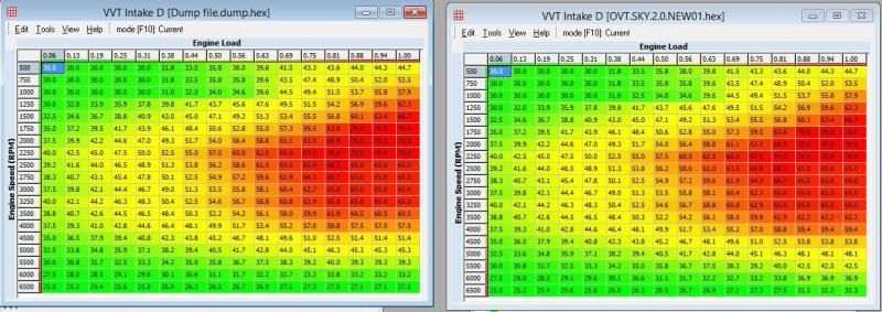

Over the course of about 7 months and 8 files I thought I was making progress. So I ran into [MENTION=14881]skyactiver[/MENTION] on facebook and we both "being tuned by different tuners" wanted to compare logs and see who was seeing the greatest gains, not just in sheer HP numbers but in real world situations such as increased or decreased times of acceleration through certain speed ranges etc. So the first few sets of logs he ran for me things weren't looking very good but at the time I had yet to log my 8th file from joe which IMO felt the strongest yet. When I finally did get around to logging that File [MENTION=14881]skyactiver[/MENTION] immediately noticed something strange and familiar about my exhaust cams.. They were soo familiar because they are ripped off from some of OVs older work which was admitted by both tuners 4 months prior as being unsafe for extended use due to it causing knock at cruise. This extremely disturbing since I ran this file for almost 2 months.

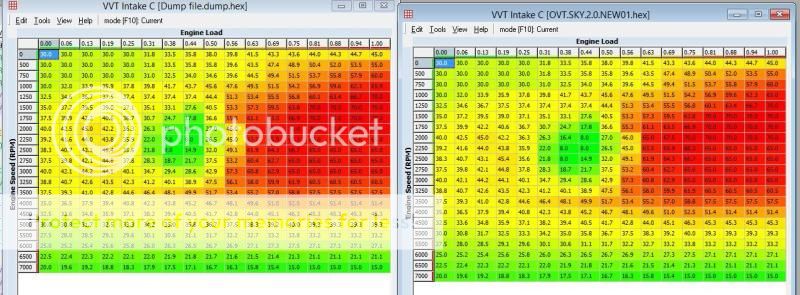

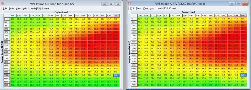

After dissecting my actual tune file we were able to view and confirm that I was indeed given cam tables in my 8th tune file from dynotronics that were originally created as tests by OV and deemed unsafe by both tuners. We can also prove that these tables far pre date dynotronics using them by almost 4 months by the times that a couple of OVs customers were testing them.
"Mine is on the left and OVs work is on the right"

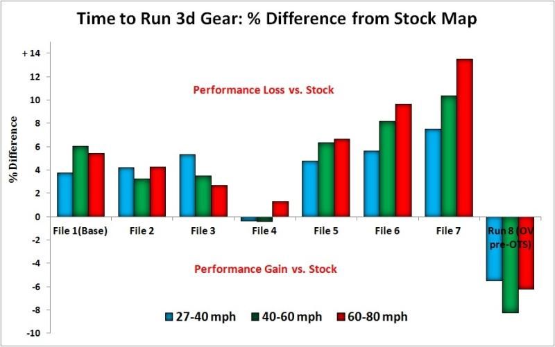

Now that we have established that Joe decided to rip off some of OVs old settings lets take a closer look at why via some awesome graphs [MENTION=14881]skyactiver[/MENTION] helped put together comparing all of my previous logs. Keep in mind all of my log files are very consistent and done as precisely as humanly possible in the exact same spot.

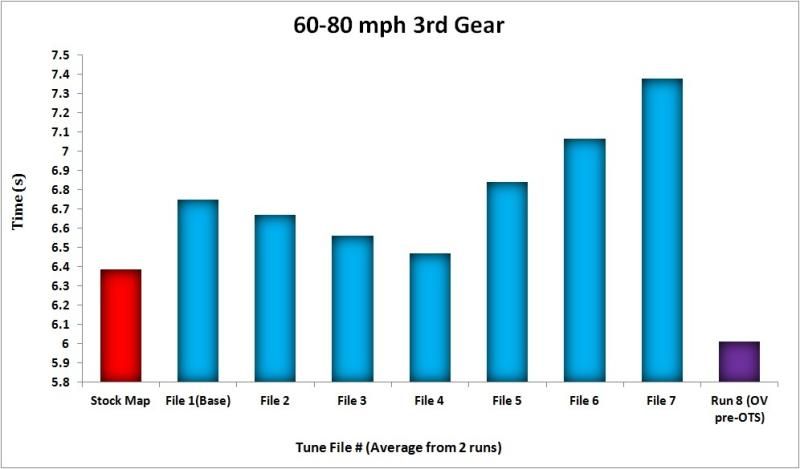

First we have a graph showing my %difference in time to complete a 3rd gear pull using a completely stock tune pull as a baseline. Each set of bars represents a different tune file. Lower the number the better on this one.

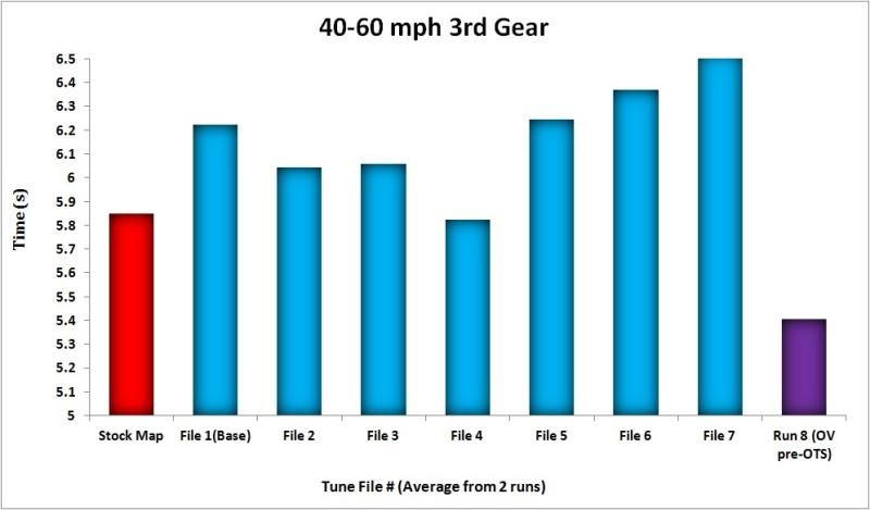

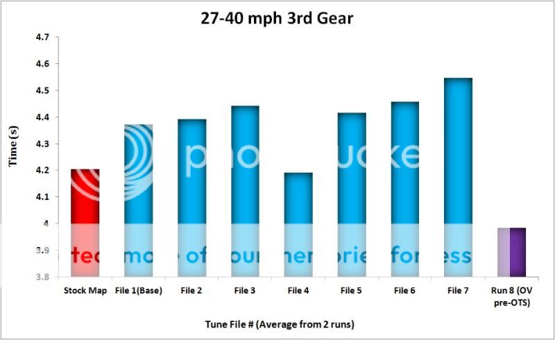

The next 3 graphs demonstrate the actual time to compete various speed ranges over all of my tune files.

NOTE: completely ignore the actual HP and TQ numbers as those are skewed by my logging going uphill actual results on a flat surface would vary but these were all logged in the exact same place. This is a demonstration of the lack of progress Joe made over the course of 7 months. Then what he was able to do by simply using OVs old cam tables..
Legend:
Stock: brown and grey
File 7: yellow and green
File 8 "OV pre-OTS maps" : blue and red
so as we can clearly see Joe actually never made any progress past what the stock file could make until the last file he sent me which used OVs pre-OTS test settings. This is extremely disappointing after spending hundreds of dollars and wasting a lot of gas and time logging to literally accomplish NOTHING but potentially a damaged motor from using known bad exhaust cam tables.

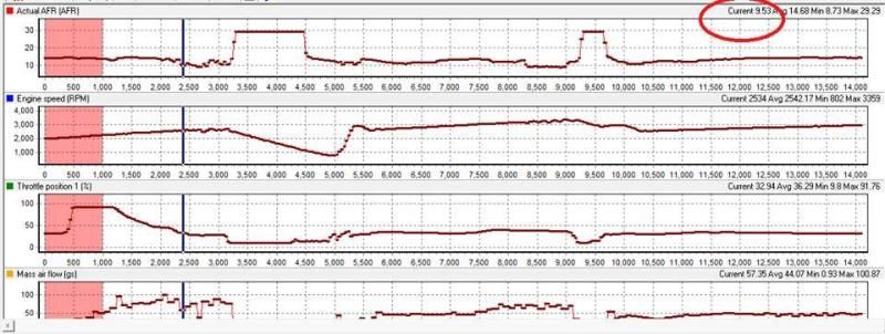

Now for one more nail in the coffin for me. I had made a post on one of the facebook groups about how I was experiencing a lot of black suit on my bumper from my exhaust. Dynotronics account on facebook posted for me to email him and he would explain. So basically he told me i was tuned on the rich side because of my bumped rev limiter and that the PIDs in mazdaedit can only read down to 12.67.. Well thats very interesting as I have here a screenshot of [MENTION=17429]StaFForD[/MENTION] AFR for his boost tune and guess what.. It doesnt look like his logs had any problem reading a lower AFR..
