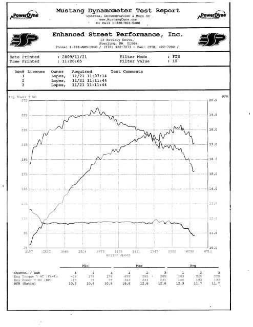

Dyno video of my MS6

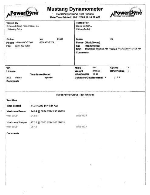

o no all i had in that dyno was a intake and cbe... dp/ap im getting in the next month...i just put the tmic last week...but carlson aka crlsnlopes he had a testpipe/3.25 tmic/manifold/n cobb map i forget which one and he put down 248hp 267trq i believe somewhere around there so i mean 30hp more is good it was on a mustang dyno which has the lowest numbers of all the dynos i believe...there was a supra there that i saw put down 457hp on a dynojet and at this dyno put down 396hp and a evo that put down 356hp on a dynojet only put down 326 at this dyno so when i get the ap im going to dyno it again on the same dyno and im hoping for 230hp-280trq goal is to get over 300trq by the end of next year :)

Good numbers i guess eh. Even though that's what a Stock MS6 should dyno. Mustang dyno's always read about 10-20whp less than what a Dynojet reads. When you went to the track the first time in that video. Was your MS6 Stock or modded?
all i had was a intake..my 60ft was 1.8 n i wasnt shiftn the greatest i was in shock of how nasty the launch was lol but as in the dyno mustang dyno has been known to give a 5-10% lost in power/trq but idc i want to see what i get with the tmic and cobb stage 1 map but on alot of the dyno's you see arnt on mustang dynos and theyr only putting out somwhere in the 220-230hp range

i dynoed my car not too long ago and my numbers were 257awhp and 293awtq. it was on a mustang dyno. all with the stock tmic, intake, T.I.P, 3'' turboback, PG mani, and a reworked KO4.
they make decent dd power. too much more than 300 whp means a lot of up keep
tru, the thing is that i hang with alot of evo and subaru guys. and watching a stock turbo evo run 10's and make over 400w and then getting in my car is like ehh. makes me kick my self.
