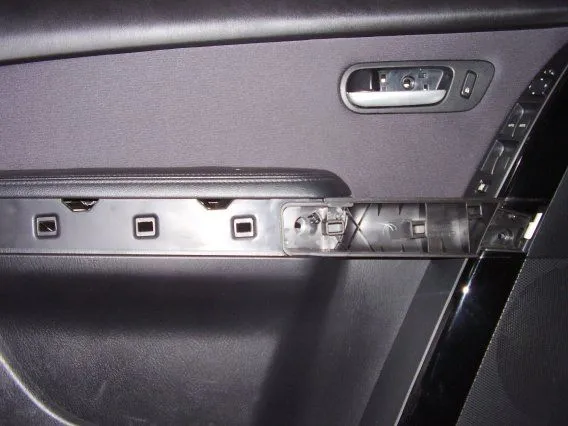

There is a cover behind the Inside Door Release. Carefully pry it from the lock end and gently pull it out. Use a plastic tool, if possible.
Pry off the inside Mirror Mount Cover.
Pry off the back end of the horizontal trim piece that's right below the Arm Pad. Pull it away, working towards the front, and then pull it slightly back and out.
Remove the 2 10mm bolts that the Trim Piece covers, and the phillips screw behind the Door Release.

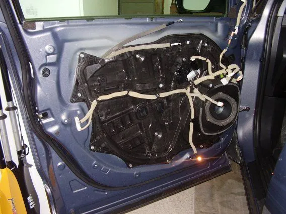

Reach around to the front edge of the Door Panel, between the lower hinge and the Door Stop. There is an indentation you can get your fingers into. Reach in, then while supporting the back end of the panel, pull quickly. The entire panel comes loose, except at the top. Once loose, lift slightly to unhook the panel from the top edge.

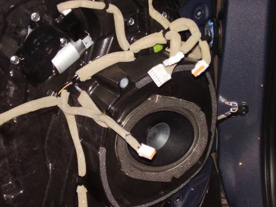

Disconnect the electrical. They are all different, so don't worry about mixing them up. Pop the Courtesy Light bulb out.

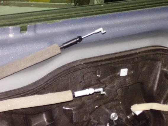

Disconnect the Lock Cables. Create a little slack, then lift them out at an angle.
