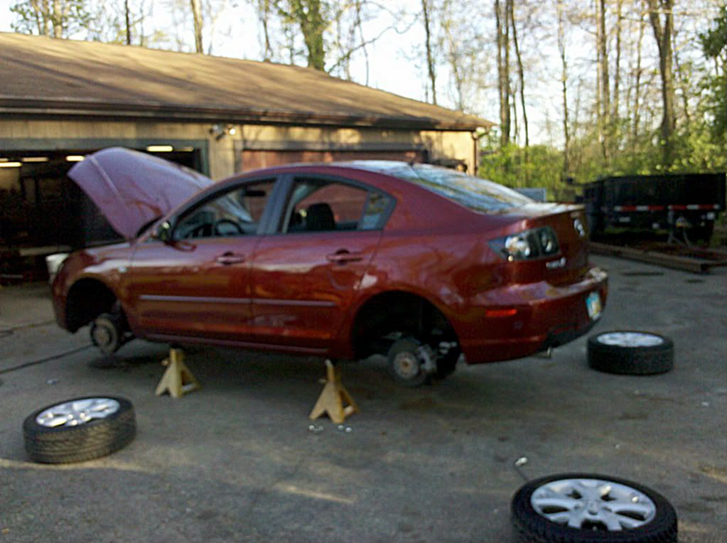

I bled the brakes on my 09 Mazda3i today and verified it is indeed diagonally-split hydraulically.
(Sorry for the super crappy quality pic... my phone's camera is terrible)
I figured it out by having my friend hold the brake pedal, I cracked the right rear bleeder, and with him still standing on the pedal to hold it at the floor, I walked around to see which rotors I could spin by hand. Surprise-surprise... with the right rear bleeder cracked, the right front and the left rear rotors were clamped solid... the right rear and left front were free to spin since there is no hydraulic pressure acting on the pistons(since I had the bleeder cracked).
Mystery solved. If you don't believe me then try it for yourself next time you bleed your brakes.
