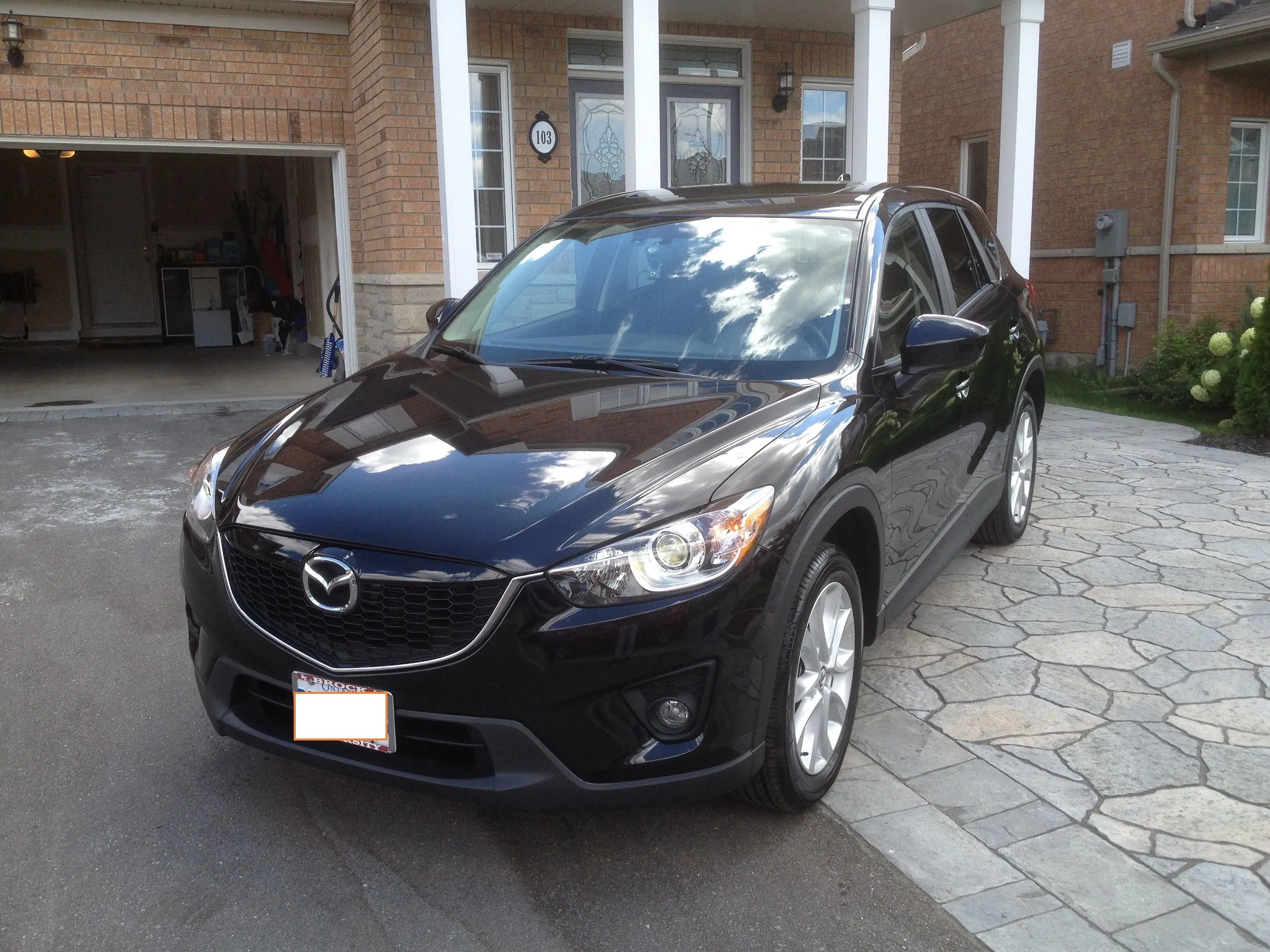

IMG_1869.webp I'll come back to this thread when the snow banks are gone and it's not -10C outside -_-
But here's a pic from this past summer, hand washed, clay bar, waxed all with Meguair's top of the line products
