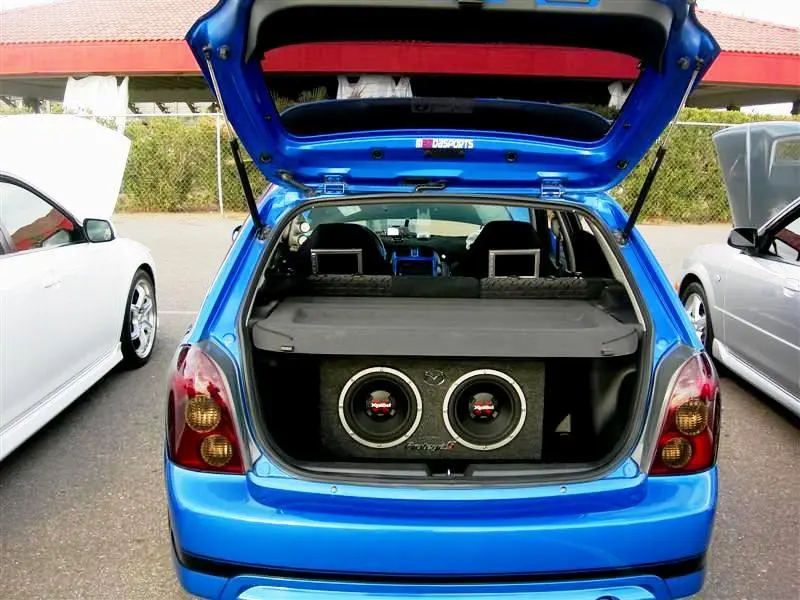

I did cut off the posts and then stuck the emblems to my sub box.
