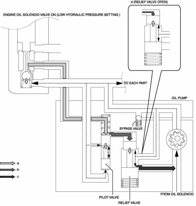

This OCV is located on the side of the engine above the oil filter. The same OCV used on the 2.5L without cylinder deactivation is different with part no. PE01-14-440A. There’s another OCV located on the engine top and used as variable valve timing (VVT) solenoid with part no. PE01-14-420A and this’s the one prone to leak.

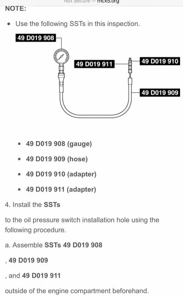

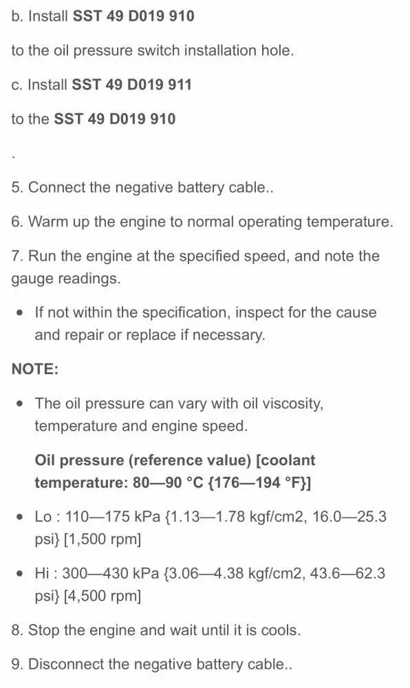

Now you really have to be concerned based on the actual oil pressure your dealer measured. They found the oil pressure @4,500 was 26 psi before the fix; 36 psi after the OCV replacement. But based on Mazda CX-5 Workshop Manual, the oil pressure should be 43.6 ~ 62.3 psi @ 4,500 rpm!
So your oil pressure had been way lower than the specs for the last 3 years and 36K miles. Now after the fix, the oil pressure is still lower than the specs!

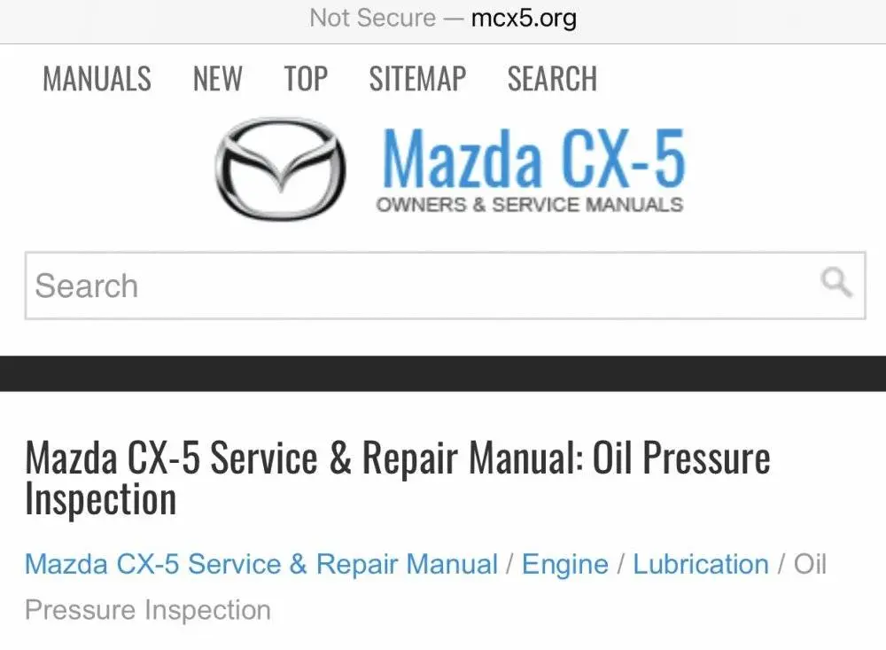

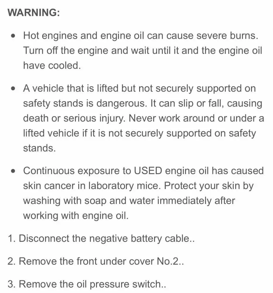

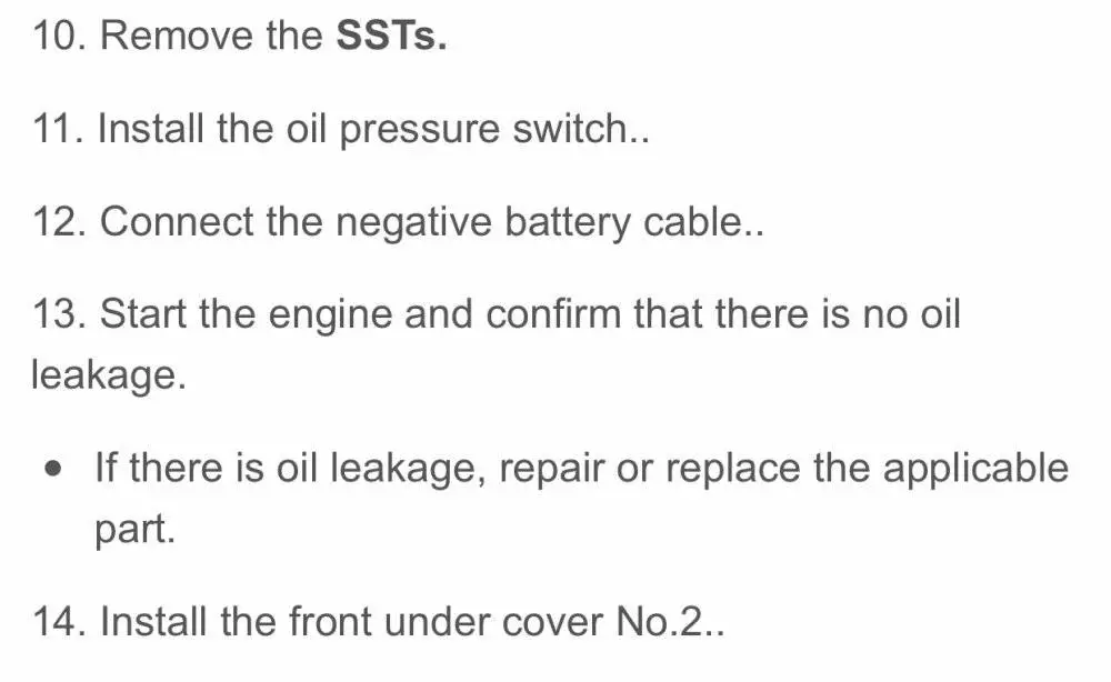

Mazda CX-5 Service & Repair Manual / Engine / Lubrication / Engine Oil Control
Whether or not the low oil pressure warning is coming back is not the point right now for you, but the fact that the oil pressure checked is still lower than the spec after the “fix” that is the key. At this stage your best bet is to contact Mazda North American Operations and raise the issue. You want to emphasize that you have this this low oil pressure issue with CEL since new, and the dealer had failed to properly check the actual oil pressure until now. With 26 psi @4,500, but the spec is 43.6 ~ 62.3 psi @ 4,500 rpm, for more than 3 years, you believe the engine has suffered the long term damage and you want the entire engine to be replaced.
It could be a long fight. If MNAO refuses replacing the engine or at least replacing many oil pressure related parts and some bearings like ferro_sk’s dealer did, If I were you I’d just try to get rid of the CX-5 once the powertrain warranty runs out. Because the engine definitely has suffered some damage, and that’s why the oil pressure is still below the spec even after the so called “fix”.
Check with dealer on this. They used TSB SA-055/20. In that TSB:
Oil pressure (reference value)
Lo: 135-165 kPa {1.38-1.68 kgf/cm2, 19.6-23.9 psi} [1,500 - 1,600 rpm]*
Hi: 225-275 kPa {2.30-2.80 kgf/cm2, 32.7-39.8 psi} [4,500 - 4,600 rpm]*
Oil temperature: 80-90 °C {176-194 °F}, Coolant temperature: 80-90 °C {176-194 °F}
I asked about discrepancy between these values and those in the service manual yrwei52 kindly provided. Response was they can only go by the trouble code and the tsb provided by Mazda. Possible the service manual values were not for the 2018 engine with cylinder deactivation?
