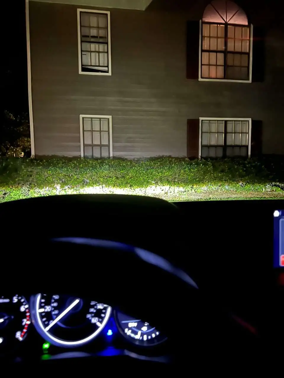

My lights actually don’t look like that, see below.
Seems like they need to be adjusted (my model comes with auto leveling, according to Mazda service tech) on top of being quite dim (maybe because this model uses halogen bulbs)?
Seems like they need to be adjusted (my model comes with auto leveling, according to Mazda service tech) on top of being quite dim (maybe because this model uses halogen bulbs)? View attachment 312189
They do look really low but I think it may be just the angle the picture is taken. You're going to have to measure it.
This is for the previous generation but gives you a rough idea.
