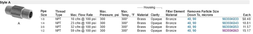

How about a coolant filter on the inlet to the heater core?
Pick one: https://www.mcmaster.com/products/water-filters/inline-filters-5/
Maybe this:
