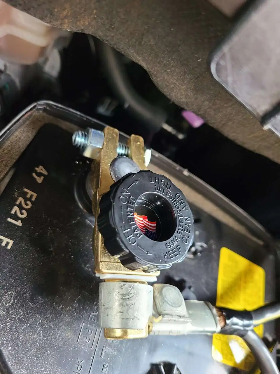

Hi everyone. I just crested an account to post how I solved this issue on my wife's 2018 cx9. She originally would have to use a socket but I found this on Amazon and it's awesome. A simple unscrew breaks the connection and tightening it restores it. So much easier.
Top Post Battery Master Disconnect Switch https://a.co/d/25ytcgT
