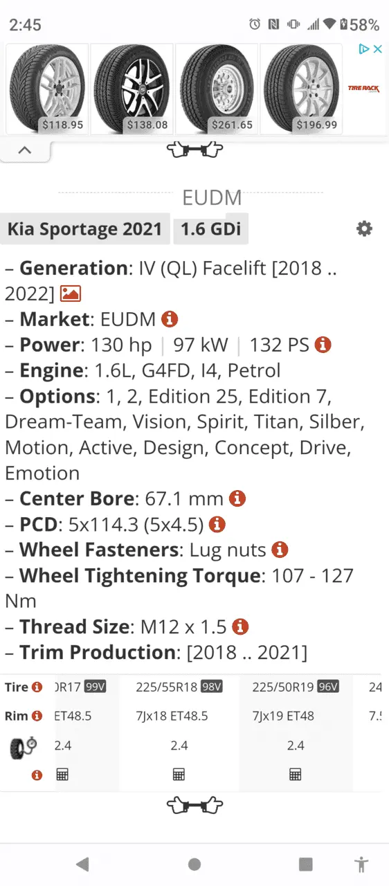

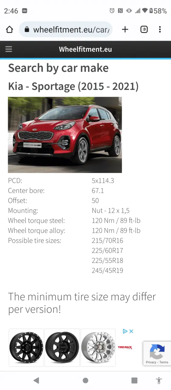

See if you can get a set of salvage rims...of a newer(or older) model Kia or Hyundai. They make 18 inch rims for there vehicle as options.

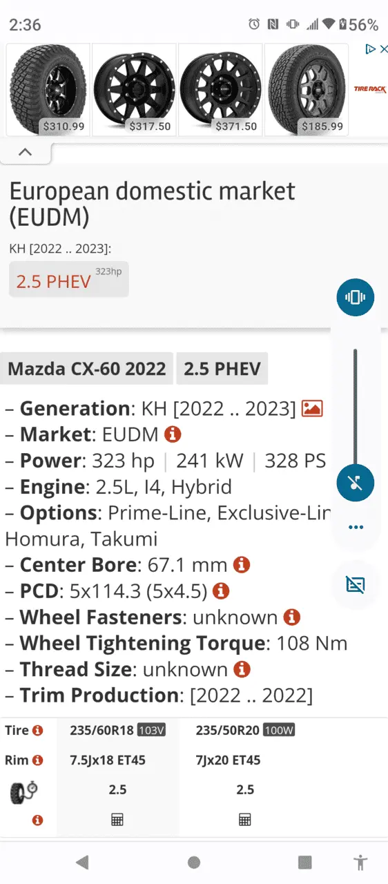

Appears Mazda cx60 offers 7.5x18 ET45 as options.
Kia and Hyundai have same centerbore, and pcd. Depending on the model ,the offset may be same or slightly different. Slight difference shouldnt be a problem. You may be able to do larger rim width if push offset out.
Maybe an 8 inch rim with 40 or 42 offset.

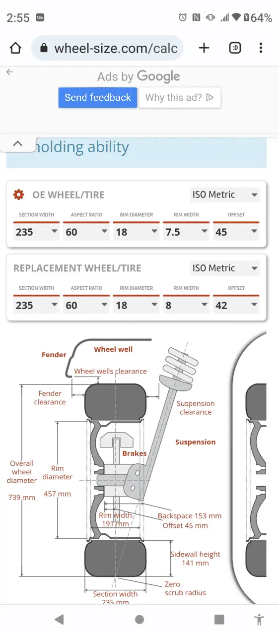

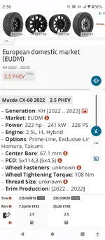

Try some research and doing some calculations at wheel-size.com. search different make and model rims @ wheelfitment.eu.com
You might be able to do salvage or even aftermarket rims with slight difference. See if these will work
Original 7.5x18 et 45
7x 18 et 48.5
8x18 et 40
8x18 et 42
Etc,etc.
