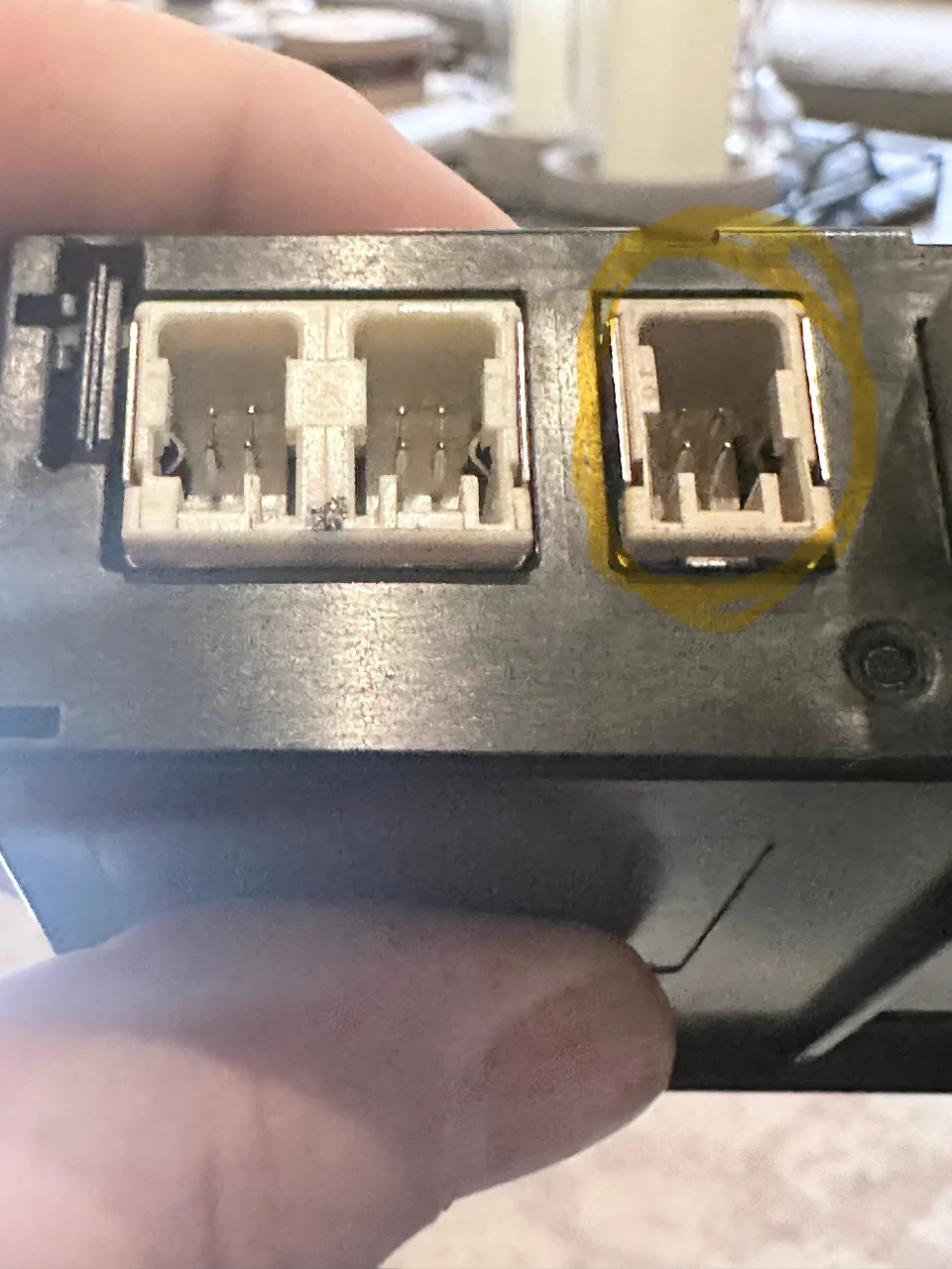

First, Question: Does anyone know where I can get the wiring harness for the back of the carplay unit? I need the 12 pin connector that plugs in the gray box of screenshot 1.

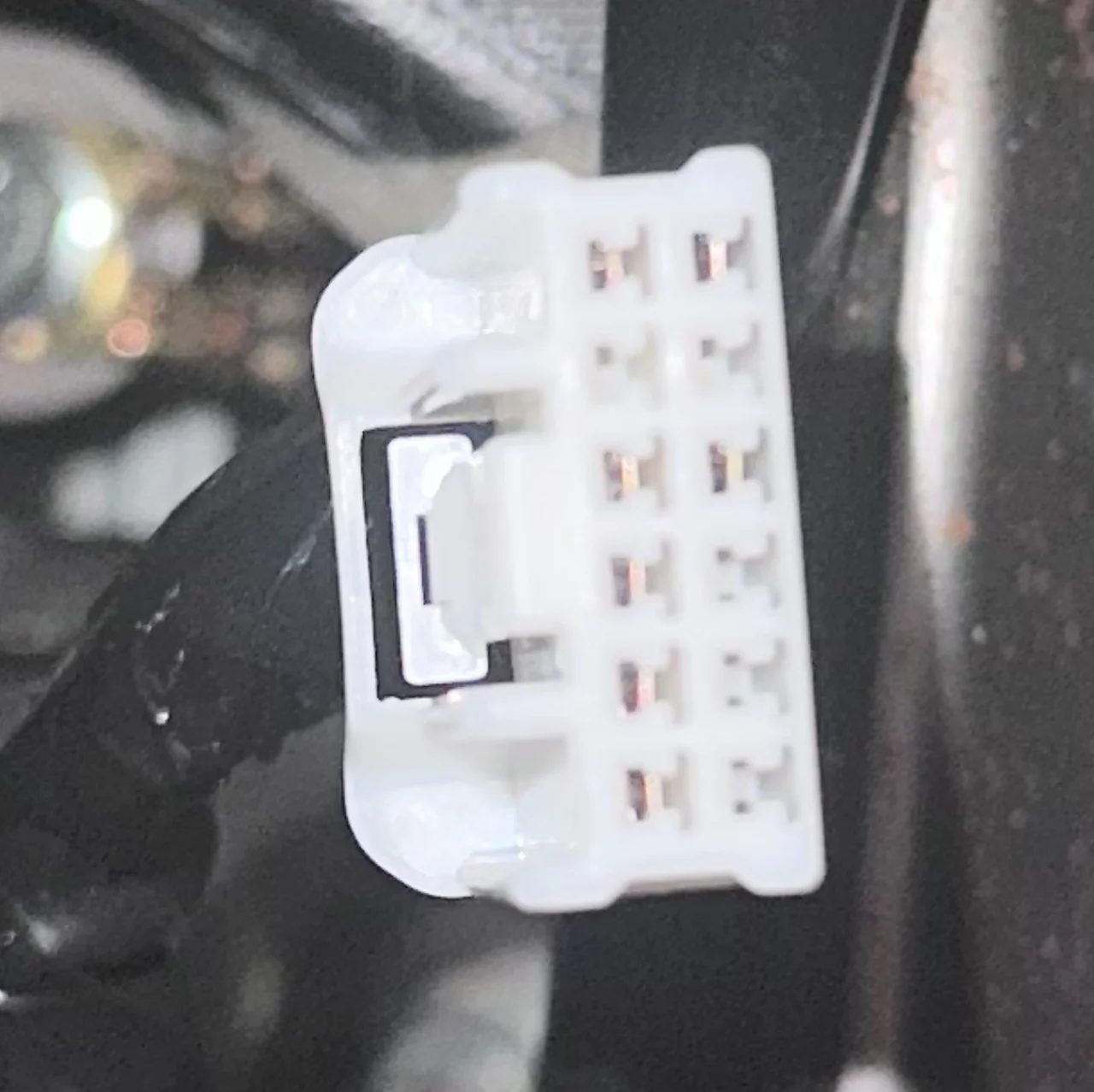

Second: Like many other posts I have seen, I too was surprised when I upgraded my carplay to wireless and my Sirius XM quit connecting. No one could tell me why so I decided to trace the issue myself. If you look on the back of the wired carplay box, the center (single USB plug on the back of the unit) piece has 4 pins inside. However, if you look on the back of the wireless box, that center piece has NO pins...so there is no signal going back to the SiriusXM tuner (which is located under my glove box). You can see this is screenshot 2.

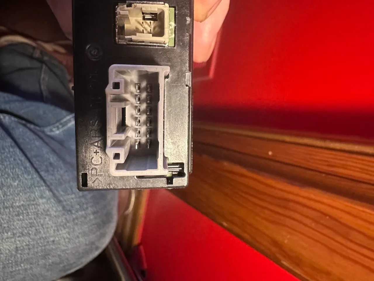

I think I might has a workaround, but first I need the wire from my question above (it looks like screenshot 3).
